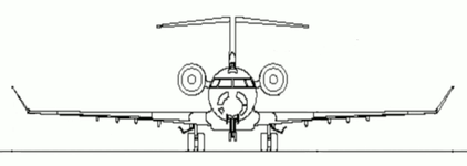

The right wing buckled at the fuselage, the right gear was a fulcrum!!!! In the first five frames, you can see the left and right wingtips (both are easily tracked by the video frame rate), right wing low to accommodate the crosswind. Upon touchdown with the right gear, the left wingtip moves down as the plane levels and puts down the left gear. After Frame 6, the right wingtip suddenly vanishes but the right gear is still visible. This is from the wingtip snapping up as the weight of the fuselage whips it upwards using the still visible right gear as a fulcrum. In fact the right gear is still visible through Frame 9. The right wingtip is seen again in Frames 12 and 13 level with the top of the fuselage.
If this is so, they should find no initial ground contact damage on the recovered wing tip.

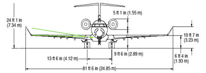

Here is a better representation of what I believe the crash video shows. This theory requires both the main spar and side brace linkage to break. What does not happen though is the right wing striking the ground nor the right gear punching through the wing, rather it remains propping up the broken wing. This does not address the transmission of forces causing the break.

If the wing tip hit hard enough to cause the wing to break off, I'm sure we'd be seeing more damage to the wing tip. It looks fairly intact and not bent up, which Id suspect it may be. Unless the wing was holding on with hopes and prayers prior to the hard landing.
If the wing tip hit hard enough to cause the wing to break off ...
Yes, that relatively small and fragile tip was never a likely cause of tearing off the entire wing from the root.
Only perhaps if more of the wing hit say a snow bank after landing off center, but I doubt thats the case as well.
I find it hard to explain landing gear not swinging upwards immediately upon impact.
Net forces will inherently keep the gear deployed under the wing.

YesI watched the video several times, I just have a different interpretation than you. The right wing tip for me vanishes and the damage on the root of the wing is important. If say the locking strut actually broke through the wing attachment, it left very little for the wing not to break off so there may be not much damage to the wing tip.
We are speculating without all the data, reports and not examining the debris left.
