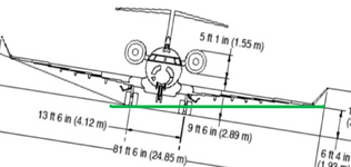

This little markup though shows the landing gear doesn't even need to completely collapse. I rotated the front view only 8 degrees. So you wonder what amount of compression each wheel can have.
It's going to be some time I think before they can figure out cause from effect and actions of which ever pilot(s) were actually flying.
