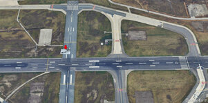

In case there is any question of the location of the wreckage, from CBC
and overlaid on Google Earth (Maps). It's barely 500 meters from the numbers and on the aerial Google image, you can see the runway maintenance where the rubber build up from the main landing area has been stripped. In other words, the wreckage stopped where most flights touch down. This is consistent with the aircraft flying into a lull in the otherwise strong winds, causing the hard landing with the wing strike. I don't know if the pilot should have been able to react in a timely manner or not.
Also, from a post on PPRuNe, as transition is made from a crab approach to longitudinal alignment with the centerline, an increasing sink rate should be anticipated. This may have been a compounding factor with a lull in the winds. Only conjecture at this point.

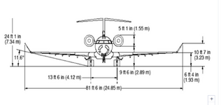

The CRJ900 wing tip when on the ground is 3.23m for an overall wing length from centreline of about 12m. That's a roll angle of about 11.6 degrees before impact - see the drawing below when the wheel is on the ground. It is also a pretty "flat" wing compared to many which curve or slope up a bit.
But lose a wheel and its pretty much guaranteed the wing will hit the dirt as there's no engine pod to slide along on. So an engineering design issue?
The design of the CRJ with its high engines on the tail does allow the wings to basically sit below the cabin structure, but means any landing gear leg failure will be catastrophic damage.
Compare the CRJ900 with the original 737100 - both about the same size.
Good points. Without engines mounted on wings on the, CRJ the Wings don't have to be as strong nor as resistance to torsional loads.
Clearly wing tip hitting ground could have started the avalanche, but landing was a drive it into ground landing, thus lots of force on wing and landing gear. Who knows which failed first?
Either way any suspension travel in landing gear was abruptly bottomed out immediately upon impact.
Interesting that when the one wing broke off, the other wing still was providing lift which caused the flip.
Agree left wing still had lift, but right wing on tarmac was creating lots of drag on that side, and rotation in more than one plane.
Judging from the landing image above, the aircraft was nowhere near 11.6 degrees of roll at touchdown so the landing gear crushed on impact.
