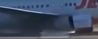

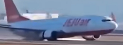

Well the back part of the engine cover is gone on the right motor could have happened at beginning of the landing strip though, its not possible to see on the video.
The motor looked intact after the "bird" strike video though.
A normal motor would look more like this wouldn't it..
This broken one looks more like the one from the video in South Korea
The thrust reverser was activated.
Could be, hard to tell with all the dust and shadows..
But then it doesn't look like it was activated on the left motor. :unsure:
Maybe a reason to turn off the motors, I assume the plane would go in a "circle" if they had been on.
That's where the theory that they shut the incorrect engine off is coming from.
It's uncertain, but has been pointed out in both videos that the #2 engine (bird strike engine) appears to be running, but the #1 engine seems to be off or powered down. You can clearly hear an engine spooled up and then powering down, but no visible exhaust from the #1 engine.

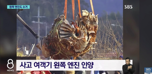

This guy has some very interesting new pictures to share:
I posted this thinking this guy was on to something because the fan blades on the right engine are all bent in one direction indicating the engine was running. Now I am editing the post because I realize they are bent in the opposite direction of rotation. Still inconclusive. I'll leave the post up because the pictures are interesting.
Possibly removed for rigging? Hard to tell if the missing blade(s) were there before.

I initially wanted to say that the blade was possibly the one impacted by the bird but now I see that there is a piece of cowling smashed through the gap so that makes me believe the crash caused the loss of the blade.
