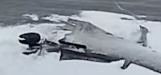

A Delta plane appears to have touched a wing tip during landing, ripped the wing off then promptly flipped over onto its back.
As they were on the airfield and this time didn't run into anything or catch fire, everyone is alive, though not surprisingly some injuries.
This video https://www.dailymail.co.uk/news/article-14407855/delta-plane-crash-toronto-fireball-footage.html makes it look like a very hard landing - no visible flare
I think you're into the right sequence myself. Pretty clear the wing started detaching before the gear collapsed in my view.
It was all over in less than a second but the gear collapse wasn't the start point. IMHO.
The right wing tip remains visible for six frames including touchdown. That's 1/5th of a second from touchdown until the fuselage punching action catapults the wing tip upwards at a rate the video can't capture well. You can practically see the right MLG compress through those frames until it bottoms out at the sixth one and the wing tip gets launched. We already know it's over at that point.

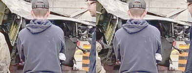

An end view of the punched down rear wing spar in 3D (cross eye). The trailing edge spar, which is supported from the distal wing structure can be seen on the right, just below the spoiler root. A bracket spanning the landing gear bay is also visible attached to the trailing edge spar.
They look flummoxed. I hope they read this thread and stop wasting my tax dollars.
Just a thought. The report now says the impact with the ground produced 3g of acceleration significantly exceeded the design loading of the aircraft. United flight 1722 from Hawaii pulled 3g due to an autopilot setting error and the wings stayed on. The pilots didn't even return to the airport!
That would be 3g distributed evenly across 2 wings, 4 spars. This "occurrence" was the entire weight of the jet punching on one spar, so 4 times the load issued against a shearing device. I don't think its an apples to apples comparison. Having said that, the landing gear took a bunch of the load so not the full 3g was required to shear the wing.

My question being, is the automatic deployment system capable of fully deploying the spoilers within 0.6 seconds after MLG ground contact or does the departed wing have a last breath of life as it slid down the runway?
Edit: This video (Youtube) shows they deploy rapidly upon contact. I'll download it and analyze it. This video (Youtube) suggests deployment seven frames after ground contact which could be after the rear spar was punched but prior to complete wing detachment.
A quick analysis of the first video shows the spoilers deploy at 5/30sec after td and requiring 16/30sec to fully deploy for a total of 21/30sec. Very fast indeed. Compare with incident footage, rear spar detachment at 6/30sec and complete wing detachment by 19/30sec. The second video suggests deployment at 7/30sec and 12/30sec to fully deploy for a total of 19/30 sec.
Interestingly, only one of the two "Ground Spoilers" is deployed. The right MLG is still attached to the wing.
Edit Too: The spoiler doesn't appear deployed as the detached wing sat on the runway.
Edit Three: Perspective is everything. From the prelim video, one spoiler is deployed, the other not.
