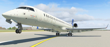

This is the MLG configuration, it folds inwards, with all of it mounted aft of the wing rear spar:
the fore-aft beam shown above is just outboard of the trunnion, which mounts in bearings in the rear spar and aux spar/fitting (grey in image below).
this is the wing box internal structure from the video (skins are not installed). I've added the trunnions (orange), main gear posts (red) and tires (blue) in the folded positions.
Lastly, this simulation view shows how the a/p is supposed to land:
