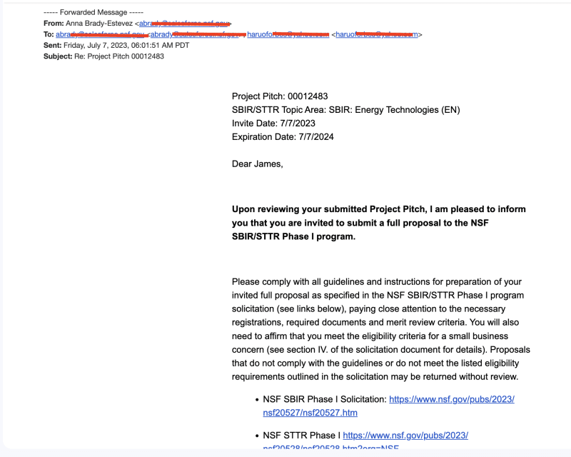

I get that what I propose is counter-intuitive to everything you know about steam power cycles. The goal may not be a high temperature / high pressure steam cycle that contains enough pressure so steam can be accelerated through various stages of a traditional steam turbine. But maybe, a lesser kind of cycle can be maintained on a lower amount of energy. Maybe a 100kW input could generate a 50kW output. 50% efficiency in a cycle that is much less expensive to build and maintain, might be beneficial..
The National Science Foundation also believes it's worthy of investigation. A Phase I grant is enough to prove the premise. If Phase I sees positive results, Phase II is enough to build a prototype.

Does the NSF take the same laissez-faire attitude towards thermodynamic impossibilities as the US Patent Office?
