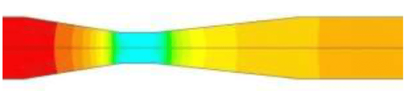

When you pump water through a constriction, the pressure through the throat is lowered. Essentially, a low pressure zone is created at the Vena Contracta and through the length of the throat of the Venturi. Liquid flowing through this low pressure zone will form an annular flow with gas in the center and liquid against the walls. If the pressure is low enough and heat is added along the throat, saturated vapor will be produced. This zone of low pressure is only momentary and the egress of the Venturi is atmospheric pressure (or at least something other than the low pressure of the throat). Also, the supercavitation jet created through the throat will exit downstream with a shockwave, force, and compression. Although the pressure is low at the throat, this is not maintained anywhere other than the throat. The shockwave created by the 1 liter per second flow of water and the subsequent 1600 X expansion of the water into steam creates a force that can power a turbine. Further heating of the gas as it flows through the turbine also adds force.
Heat can be added to the throat area to account for the remaining latent heat of vaporization. The sensible heat contains 1,323 kJ/kg so another 932kJ/kg for fully saturated steam and an additional amount of heat to raise the temperature of the resulting vapor.
Flash Vaporization Creates shockwave and Useful Compression

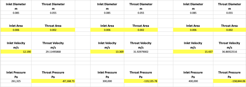

In method 02, the pump creates a pressure of at least 261,325 Pa upstream of the Venturi. Several studies have shown that with a .65 contraction ratio in the throat of the Venturi and an inlet / outlet pressure difference of at least -160 kPa, there will be a zone of low pressure of 0 Pa in the Vena Contracta. A higher differential will create negative pressure (not just gauge, but more than -101,325). My current design goal for a prototype is 300 kPa, but with a lower flow rate so the diameter of the Venturi is smaller than this screen capture. But you can see from this screen capture how the inlet pressure affects the throat pressure.
I don't yet know the pressure at the outlet of the Venturi before the vapor enters the turbine, but I think it will be a bit lower than atmospheric for two reasons:

You propose accelerating through a venturi to drop pressure low enough to vaporize water,AND, before the vapor decelerates in the outlet, you add a ton of energy to keep it in the vapor phase.
How in the world are you expecting to transfer enough energy through a venturi throat? You must have a minimum surface area for that heat transfer, but increasing the surface area will mean an increasing throat size, even if you corrugate/fin the pipe. That would drop your velocity and kill any vaporization.
This is a thermodynamic impossibility.
You are "adding" 932kJ/kg in the throat to maintain saturated vapor condition. Let's do a brief bit of math:
Using the info from your spreadsheet:
Inlet Velocity: 12.2 m/s
Inlet Area: 0.00567 m2
Liquid Flow: 0.069 m3/s, or ~69 kg/s
Heat "Added" 932 KJ/kg
Heat Xfer Required: 64,468,000 J/s
Estimated heat transfer area of throat (throat length = throat diameter): 0.0227 m2
dT available: 450 K (being generous, assuming -50 C to 400 C throughout the Hx area based on your "sketch"
Required Hx Coefficient = 64,468,000 / (450*0.0227) = 6,311,711 W/m2K. This is ~3,000 times higher than best case heat transfer between fluids.
Or, going at it another way...
Assume a stupidly high Hx Coefficient: 4,000 W/m2K
Required area: 64,468,000 / (4,000*450) = 35.8 m2. Available area: 0.0226 m2. You have 0.063% of the area needed.
No matter how you calculate it, you are 3-4 ORDERS OF MAGNITUDE off of the physical requirements to transfer this heat!

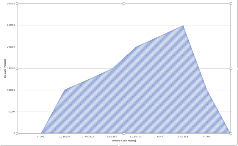

PV Diagram For 1 second of the cycle - 1 liter per second flow of water:
Returning heat to the turbine makes the turbine hotter; but if that heat is just transferred out as heat at the exhaust of the turbine it has done no additional work. The heat is being recirculated, but it isn't being used to produce work. If it did work, the temperature would be even lower.
Still not sure if you are taking the piss here or not OP, but a thermodynamic cycle on a PV plot should be a closed shape, no? You could also easily see the amount of net work in such a plot.
