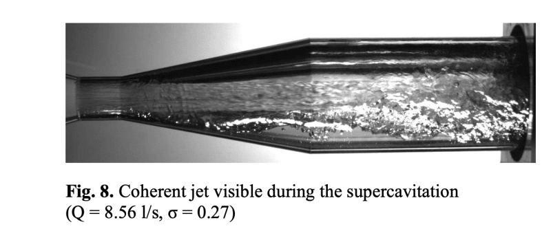

This is a cavitation experiment with water at room temperature:

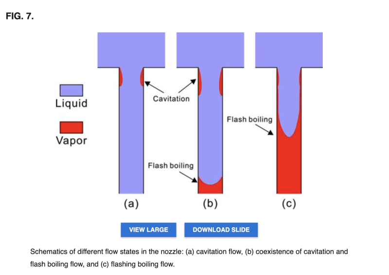

This is a flash atomization study illustrating a fully flashing flow at high superheat

Venturi Structural Parameters
Transition of cavitating flow to supercavitation within Venturi nozzle – hysteresis investigation
Cavitating Flows
Flash Evaporation Phenomenon and Resulting Shock Wave
I tried to stick to studies of flash occurring "in nozzle" rather than flash occurring upon nozzle exit into a low pressure chamber.

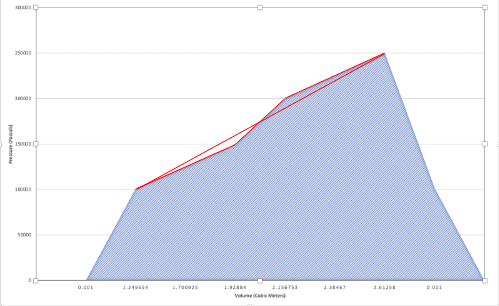

2.61158 Change in Volume
250000 Change in Pressure
652,895.00
652000 Watts
haruosan said:
You'll notice the final volume, farthest to the right .001, is also the starting volume, which means it's a cyclic loop and would be a closed shape.
You... overwrote the value of one of the points on the x axis? That's an interesting approach. So your cycle PV plot actually looks like this?
Seeing the problem here?
I didn't overwrite any values. The spreadsheet I used displayed the values in a chart as it is shown instead of closing the loop.
Your PV Plot doesn't even reflect the largest expansion from .001 to 1.249. Even if I calculate the amount of work from the constant pressure of 101.325 kPa and a change in volume of the steam of 2.61158, the amount of work is 265kW.
What I will do is provide a more accurate PV diagram
What I meant by 'overwrote' is you are showing a line graph with arbitrary spacing on the x axis, not an x-y plot with both axes to scale, hence my confusion.
Labels of the state points in relation to the PFD would help as well, as your state points aren't making any sense to me. Steam at 250 kPa and 2.6 m3/kg is at something like 1400K. I don't see anything close to that temperature on your PFD.

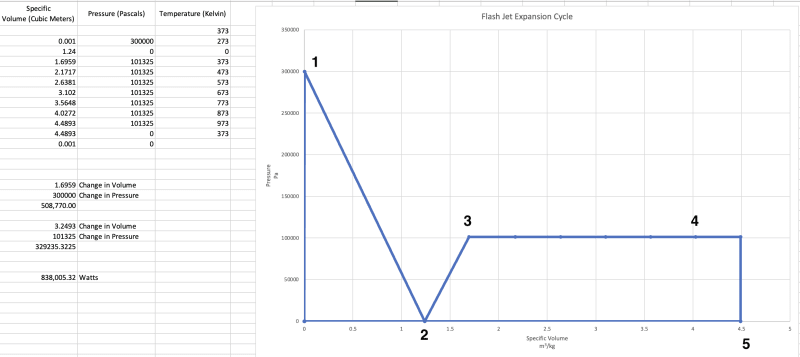

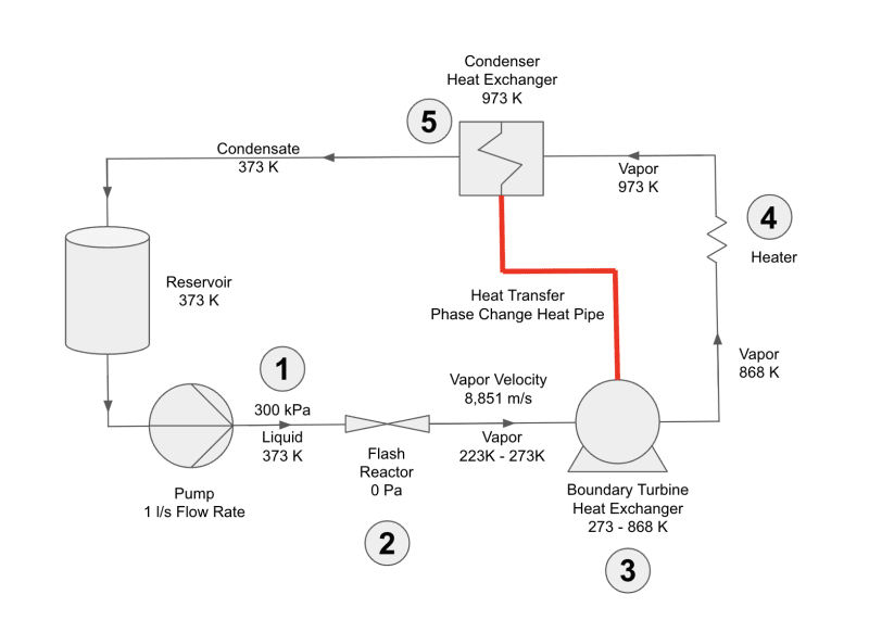

Here are a new PFD and PV Diagram with state points labeled. I increased the temperature and only have heat being added at the turbine. The isobaric portion has heat added at the turbine. Additional heat is added at 4 and should not add to work, but I've left it for this exercise. I'm trying to get a rough ball park of the amount of work achievable. For the expansion in the turbine, I kept the pressure constant to see how much the volume of the steam increases when the heat is added. The volume of the steam is specific volume at 1 atm and heat added from 273K - 868K.
OK - low pressure vapor enters the turbine at 0 C and then exits the turbine under high pressure and high temperature where it is further heated before going to a heat exchanger where it is cooled to liquid.
Is that right so far? If not - PUT FLOW DIRECTION ARROWS ON THE FLOW DIAGRAM.

3DDave,
Thank you for the suggestion. I put flow direction arrows on the PFD. I also added the liquid flow rate and the velocity of the vapor upon exit of the Venturi. The flow rate of the water is 1 liter per second with a velocity of 24 m/s through the throat of the Venturi. The diameter of the exit is 12mm. The flow rate of the steam will be 1 kg/s through a pipe with an area of 0.0001131 m^2. 1/.0001131 = 8,841 m/s.
Are these pressures absolute or gauge? If absolute, then how does the condensate exist as liquid at 0 abs pressure and 373K? If gauge, temps are way off (1.659 m3/kg @ 101.325 kPag is 730K).
What causes the pressure change between 2 and 3? 4 and 5?
How does the turbine spin if there is no pressure differential across it?
Do you think it is realistic to have vapor at the turbine inlet with a fluid velocity of 8,851 m/s? What is the speed of sound for this fluid at those conditions?
