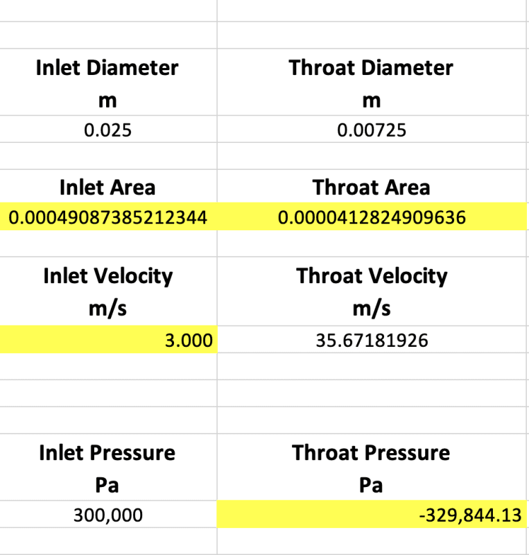

Are these pressures absolute or gauge? If absolute, then how does the condensate exist as liquid at 0 abs pressure and 373K? If gauge, temps are way off (1.659 m3/kg @ 101.325 kPag is 730K).
What causes the pressure change between 2 and 3? 4 and 5?
How does the turbine spin if there is no pressure differential across it?
Do you think it is realistic to have vapor at the turbine inlet with a fluid velocity of 8,851 m/s? What is the speed of sound for this fluid at those conditions?
The pressures are absolute. The condensate expands in an adiabatic process as the pressure is reduced and reaches 0 Pa. The process occurs in 200 μs. My goal was to represent this expansion from liquid @ .001 m^3 to vapor @1.24 m^3 (state point 2) then further expand to 1.69 m^3 as it is heated to 373 K.
I do not know what pressure will be achieved within the boundary layer turbine as the vapor enters it or after heat is applied. So, to get a ball park idea of the potential work achievable, I modeled the expansion in a hypothetical isobaric process as heat is added to calculate the specific volume expansion. Will this result in that much work through a boundary layer turbine? I don't know.
In a real scenario there will be a pressure differential, but at this time, I do not know what this pressure differential is. Research does show there is an increase in pressure within the boundary turbine and a decrease in pressure of the fluid upon exit from the turbine, but exact pressure in this scenario are not yet known. I used an isobaric process with heat added to illustrate how the vapor expands in specific volume as a prediction of the work possible.
I do think this value is high and, actually, my calculation is incorrect due to the wrong area. The diameter of the exit for a 1 l/s flow rate is 25 mm, not 12 mm so the area of the exit should be .0004908. 1/.0004908 = 2,037 m/s. Also, the liquid flow at the inlet of the Venturi is 3 m/s and accelerates to 35.67 m/s through the throat.
.0002 secs, a delta V of 30 m/sec, a mass of 1 kg/sec.
Force = m dv/dt = 1kg * 30m/s /.0002 s => 150 kNewtons (33,000 lbf) of thrust.

The pump does add energy to the water which increases it's velocity through the Venturi. This reduces the pressure of the water to below its saturated vapor pressure. This drop in pressure imposes a metastable state that directs the sensible heat to latent heat. If the velocity of the water is 35 m/s and it changes phase into vapor, the velocity of the resulting vapor should be greater than the velocity of the liquid.
The energy isn't wasted, it facilitates a change in phase and the expansion creates work.
For the Bernoulli calculations from the spreadsheet above. The inlet and outlet of the Venturi is 25mm, r=12.5mm
3.14·12.5^2 = 490.625 mm² 0.0004906 m²
If the steam flow is 1kg/s
1/.0004906 = 2,038 m/s
I don't think the steam reaches this velocity because there are other factors such as friction, pressure, etc, but it's somewhere between 35m/s and 2037m/s
You have a mechanical input to drive a mechanical output with energy wasted in between for no reason, using complicated and impractical intermediate steps.
You only can have that expansion if there is a downstream vacuum, but there isn't a means to maintain a vacuum in your system.
Best of luck that you limit the money and time wasted on this project.

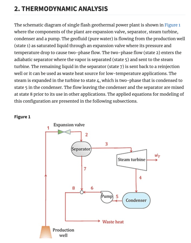

When water becomes vapor, it won't condense unless it comes in contact with a surface that is cooler than the vapor itself. The Venturi creates a zone of low pressure at the throat, this is where the water changes phase. Studies have shown that the length of the throat does not affect the pressure of the throat so if you make the throat long enough to accommodate the fluid for at least 200μs you have a chance to vaporize it before it exits the zone of low pressure. This process is already being used in geothermal power plants where hot water is forced through an expansion valve to create a two-phase flow without a flash chamber and only the expansion valve. I'm proposing to engineer a way to add heat through steam entrainment to create saturated steam or accept the two phase flow into a turbine that can handle two phase flow. Whether or not a saturated or two-phase flow is created, additional heat can be added to the turbine to further heat the vapor, vaporize any remaining water, or prevent any of the vapor from condensing. Then, heat the working fluid when it's a gas and it's specific heat is 1996 J/kg/K instead of heating it when it is liquid with a specific heat that is more than twice that at 4186 J/kg/K.
The single flash cycle contains only one throttling valve (expansion valve)
through which the geothermal fluid is expanded, and one separator to separate
the vapor from the liquid after the expansion process in the expansion valve.
The two-phase geothermal fluid is separated into steam and liquid brine in a
separator vessel at a pressure higher than atmospheric pressure.

Geothermal power plants use the natural pressure of geothermal steam to force hot water through an expansion valve. Natural pressure or a pump, there really isn't a difference except you have to ensure you have the correct head for the pump inlet so cavitation doesn't occur through the pump.

Or, hypothetically, a geothermal power plant creates steam using an expansion valve and the steam exits at 100C. A pre heater heats the steam to 500 C before it enters a turbine. The steam upon exit from the turbine is 150 C. All of the thermal energy is transferred to a thermal block for storage. Are you saying that this 150C thermal storage block could not heat the steam that exits the expansion valve at 100 C. Is there some force stopping the 150C temperature from transferring to the 100C steam because the heat originally came from that cycle?
The cold reservoir needs to be present in order to shed heat, but that heat could always be used back into the same cycle as long as you can transfer the heat to a cooler area.

Here's an example of latent heat reuse from a cycle to heat the working fluid of the same cycle:
The Principle Behind the Regenerative Rankine Cycle
Relatively more specific, the Regenerative Rankine Cycle deviates from a simple Rankine Cycle by using feedwater heaters. These heaters recover energy from the steam exiting the turbines. This process, known as 'regeneration', is the reason for the cycle's name as it regenerates heat internally, hence bettering the efficiency of the cycle and generating more power with the same amount of input.
1. Introduction
Regeneration is a widely implemented method for increasing the thermal efficiency of a Rankine cycle. In this method, extracted steam from steam turbine is used to increase feed water temperature before feed water enters boiler.
The regenerative Rankine Cycle reuses heat by using the steam to heat the next cycle instead of losing the heat to the environment. Anytime heat can be reused, a cycle will become more efficient. I am only pushing that idea further than it has been before which equals more efficiency. Simple.
Nobody is saying you can't use a hot stream from one spot in a cycle to heat another spot. Regenerative Rankine is a fine example of that. What Officer Planck is saying is that you can't use all of it.
OP said:
Are you saying this heat could be used to heat water, but that water could never be used as condensate for the next cycle. ??
I don't know what "the next cycle" means in relation to a steady state closed loop, but yes, in Rankine cycle terms, hot turbine exhaust absolutely cannot entirely transfer its heat back into the boiler feedwater because it isn't possible for a process stream to cool itself.
This example demonstrates one of the mistakes you have made in your cycle design. Steam coming out of a flash drum as saturated vapor at 100C (P_sat = 101.42 kPa), then heated to 500C (still at 101.42 kPa) can't realistically power a turbine at all because even though it is appreciably superheated it is at essentially atmospheric pressure. Turbines run on pressure differential, not inlet temperature. This is why pump then heat then flash (similar to a geothermal flash cycle) makes sense, whereas pump then flash then heat does not.
