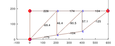

Well, if you finally get around to doing it properly you should get something like this for the bar forces. I got the geometry by cursoring figure 8
Coord=[0 185 0;0 0 0; 206 185 0;206 28 0;399 185 0;399 52 0;596 185 0]; % coordinates of nodes
Con=[1 2; 2 3; 3 1; 4 2; 3 4;3 5; 4 5; 4 6; 6 5;5 7;6 7]; %connectivity of beams

I understand you didn't input dimensions, but rather member lengths, ok fine.
point 1 is at (0,0)
point 2 (0,1)
point 3 (1,1) (but if you want to get the 230 lbs this should be closer to (1.1,1) (i get 1.095,1)
point 4 (2,1) or (2.2,1) or (2.19,1)
point 5 (3,1) or (3.3,1) or (3.285,1) these will give 210, 231, or 230
point 6 (1, 0.1) or something like
point 7 (2, 0.2)
obviously make 6 and 7 under 2 and 3
whatever dimensions, verify the member lengths (and fine tune)
now you can see the slope of the member at the RH end is 0.8/1 (or something like depending on where you place things)
so now you can work through the graphical method. You should be trying to understand the procedure, rather than getting the exactly same answers (particularly as you can analyze this a different way and confirm your answers). if you post your work here we may help out.

yes, see my sketch (post 23). Nodes 1 and 2 are simple triangles, but node 3 is tricky because it has 4 forces. You have an inclined member and a vertical member, and the 3rd side of the triangle is formed by the difference of the two horizontal members ... the load from node 1 is directed away from the triangle and the load towards node 5 completes the triangle (so that the load in 3-5 is higher than the load in 1-3. Fig 9 show this somewhat cryptically, but when you know this you can read it in fig 9 !
clear as mud ?? I can hear a "WTF", but it makes sense ... the upper chord is in tension, tension is shown by loads acting inwards to the span (just as compression loads are arrows pointing away from the span ... as I was told so many years ago, picture a man (or woman or other, sigh) being pressed by two walls ... he'd be pushing against them with his (/her/?) arms and he'd be under compression. Thus at node 3 the two horizontal forces are pointing in opposite directions (because they represent tension in different spans).

Does graphical vector resolution for this sort of problem work? Yes. Errors should run <5% which is close enough.
Your mistake appears to be the belief that the physical lengths of truss members in Figure 8 are the same as the magnitudes of the forces in Figure 9.
I suspect this because you use the same lengths for each of them in " a + d + h = 2cm + 2cm + 2cm" when clearly in Figure 9 none of force vectors a, d, h are the same length. They don't even add up in Figure 9, but are overlayed. Magnitude of h in figure 9 is not a + d + something.
yes, you are right. Ok so you can not copy and paste those triangles of fig. 8
for gosh sake, maybe the reprinting for the figures has spoilt the true dimensions (but I think there is a deeper misunderstanding at work).
the value of the force at A is easy to calculate ... (a+d+h)/AB*70 lbs if this is 6/1.3*70 = 323 lbs
or it is 230 lbs if a+d+h = 4.27 cm (if AB = 1.3 cm), or h = 1.42 cm.
now by my eye "h" looks to be slightly more than AB, not 50% more, so I question your 2 cm.
but it doesn't matter ! to understand the principle. Draw the truss however you want ...
1) draw AB = 1.3cm, a=d=h=1.42cm, ...
2) draw your own force polygon for node 1. Notice the lengths of these elements are not the same as in figure 8, but their directions are. By eye it looks like fig 9 has length AB rather than "c" from fig 8 to represent 70 lbs; and that's ok (a bit misleading) but he could've used 1 cm the length doesn't matter. what matters in figure 9 is the ratio of the lengths. Then node 2, etc.
Notice that the figures 8 and 9 are different. The length labelled "70 lbs" in figure 9 is not the as the length of member "c" in figure 8.
If you are using "a" etc from figure 9 then your 70 lbs scale length is "70 lbs" in figure 9
(the reason for this is because the lower chord is inclined slightly, so in fig 8 "c" is less than AB).
Now, notice in figure 9 the load in the upper chord is not proportional to the length of the three elements, because the truss is getting slightly deeper.
"h" is not equal to 3*"a"; "d" is not equal to ("a"+"h")/2.
