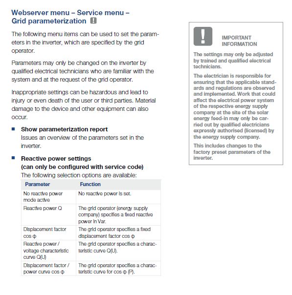

Inverters these days (well, at least the commercial size ones, not sure about residential) have the ability to maintain power factor at a specific location.
Indeed, there are now requirements for sites over a certain size here to specifically set inverters up to alter VAr output depending on system voltage, and they're also capable of power factor management in addition to real power output, although they're obviously still VA output devices.
EDMS Australia
The inverter can be set for between 0.9 either side. Mine is set at 1 and I can't change it as an owner. But it's a fixed output.
The grid contract has various levels of allowable power factor fluctuations. And the grid smart meter will cut you off if you exceed those limits.
Per say the pump is fine if it's the only thing coming online. But with the addition of an induction hob with 7.5 kW output, and the local female belief that pans heat quicker if you select max to start with. Education does not stop them. I can pull the PF quiet low. Luckily the heating controller has a locked out thermostat with a timed boost feature so they can't screw up the under floor heating. If you combine the two at the same time it gets near the 0.5s limit. Once the compressor is online it's fine. I stuck an extra fan coil on the cooling circuit so at 25 Deg house temp with a 20 degree target there is enough output that it's more than the heat pumps min cooling output. Which has stopped the short cycling. The heat pump companies solution was to stick a 500ltr buffer tank which wasn't an acceptable solution for me.
The grid guy wasn't bothered after he found out it wasn't due to some old Soviet community workshop gear being used. I suspect he changed the settings on the meter and increased the window up to 1 second. But would prefer to get it fixed properly.
All it needs to fix it is for the inverter to come off line in side 0.5 seconds and let the grid take the full load. Then come back online when it's back to running. The book of is 0.7 during start up I think. Then it's above 0.9 while running.
It was fine until I put the induction hob in.

There is no contactor for the compressor. The whole thing runs on a 220V ebus data link. There is a heat exchanger ventilation system in the mix as well that also has a CO2 sensor inputting into the mix. If it ups the airflow it compensates by adding/subtracting more energy.
If the solar injection at PF 1 goes up ie it is vastly more than the compressor pulls does that help or make the PF worse?
I am not going to make changes to the current setup. Now its not short cycling because the evaporator freezes 14 times a day its not such a worry.

You could just install some power factor correction capacitors.
3-phase Link
Single-phase Link
Just remember they are there if you kill the main to do work you need to isolate the capacitors too or you could get a shock.
The inverter simply needs to hold PF at the meter rather than holding PF at the inverter terminals. Don't know that specific inverter, but within the current limits of the power electronics they can provide what ever power factor is desired.
"Short answer: More solar contribution will make the PF at the grid meter worse. "
That was my thought as well thinking back to imaginary numbers and vector diagrams from 30 years ago now.....
I am thinking about going from a 8.5kw farm up to 21.5kw. With another 2 inverters in two more buildings.
"The inverter simply needs to hold PF at the meter rather than holding PF at the inverter terminals. Don't know that specific inverter, but within the current limits of the power electronics they can provide what ever power factor is desired."
That's what I want. There is an installer only menu with these options which came out with the last firmware update... maybe my question had an effect. The last update you had the option on putting a set value in only.
I am 100% certain though that the installation company will have zero clue about it. Just like they had zero clue about putting a battery in. They didn't want me to have a energy meter in the first place.
In order for the inverter to do this it needs to firstly know what the power factor is at the meter, it can obviously work out what it is at the inverter. Inverter OEMs will generally have their own product that suits their inverter for this purpose (as well as for zero export limiting).
