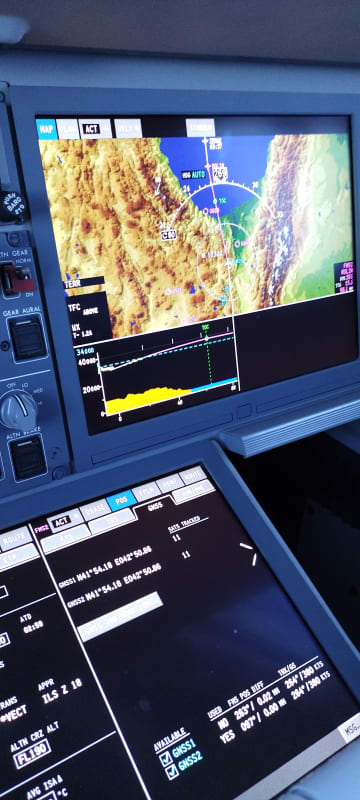

Must admit I am keeping the GNSS page open during the cruise as soon as the sats drop below 4 it gets turned off.
Where the heck do you fly, the arctic circle? I'm pretty remote but I've never seen less than 7 sats (most of our Dash 8's use Universal 1Ew and the Beech are always full of Garmin GTNs).
Its the jamming and spoofing that we are watching for, before Ukraine I didn't.

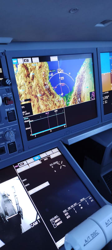

I can post up the position pages for people to have a look at if you want on a typical flight and one when we are getting jammed.
Turkey, Cyprus, Israel all are pretty much jammed and within 200 NM of the Russian Border is also extensively jammed.
The spoofing seems to be around St Peterburg and a few other places

Tug we have inertia reference system for nav as well. Which you can see the tab for on the pictures I posted.
They are laser gyro these days. The SR71 inertia nav I suspect needed a forklift to move about.
It was being used as the secondary reference system with the Radio nav being the primary in DME/DME mode in the second jammed photo.
In GNSS mode we get around 0.01 Nm accuracy. In RNAV DME/DME its 0.1 Nm. In VOR/DME mode around 0.5 Nm.
The inertia system has drift so the accuracy changes over time and the latitude we are flying at. It starts more accurate than the RNAV and then gets less than it after about 3 hours.
I will add this to give some confidence that aircraft aren't going to fall out of the sky or start pointing in a strange direction during these events either natural with the solar storms or due human interference.
