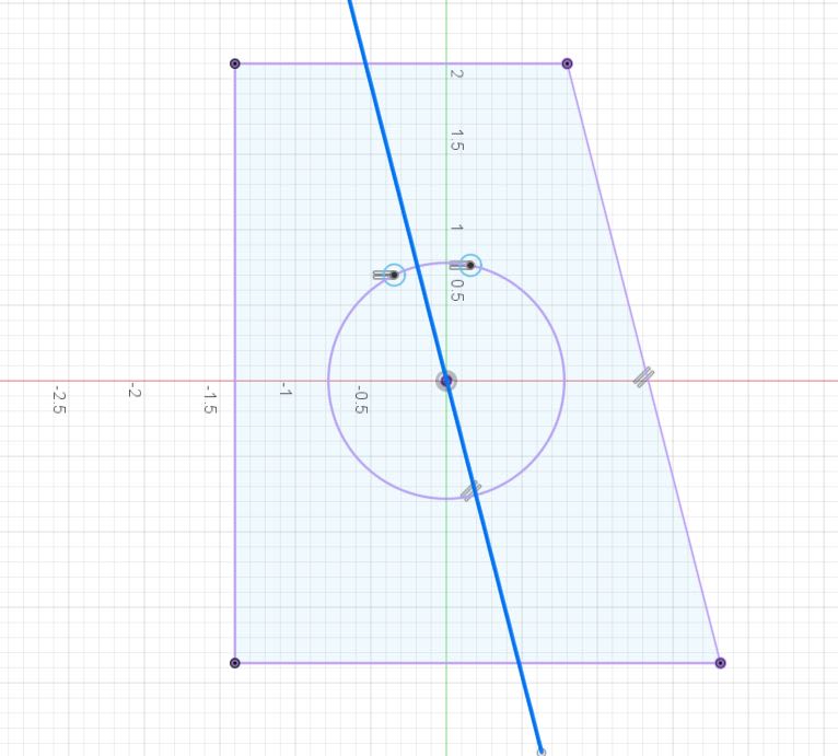

I've got so many questions on this callout that it is better to ask questions over several posts Apologies for the rambling. The part I have is somewhat like the below picture. It is two less than half spherical cutouts inside a part. Disregard the idea of a feature of size as everything under the sun here is a fos.
The callout is simultaneous as the spheres are located basic to each other(and with same DRF) and then to the bore axis(datum A) and the bottom plane(Datum B):
0.05mm A|B so this is a spherical position callout located to the bore axis and a basic dimension to the bottom plane.
Our engineering team requires two positional outputs separately. So if the spheres are 6mm basic apart...We in essence are measuring them 3mm from the axis.
1) If you measure them separately...and they pass, does that mean they will pass simultaneously?
a) I played around in CAD with a 4 hole pattern and I couldn't really come up with a scenario where if they all pass individually, they would somehow fail together. This is where my lack of experience makes me question all my thoughts on this​
2) The clocking datum is not arrested so I am thinking about using the midpoint of the spheres as the clocking XY datum plane creation.
a) this would mean the spheres could be crooked compared to the rectangle nature of the part, but does this strategy creatively measure them simulteneously while still outputting them individually?​
3) Alternatively, if I use a midplane of the part as the clocking datum this would keep the sphere more true to the overall part, but then does that violate the simultaneous theory of the standard?
I'm a little confused here so I appreciate the guidance. I will be discussing with our overall leader soon, but I wanted to get your thoughts before I ask for a meeting. Functionality, and eliminating assembly errors trumps everything, but I'm asking for a technical take on the GDT and perhaps personal opinions.

I initially conceptually agreed with greenimi, that the clocking datum doesn't matter when reporting out the spheres separately to make sure they are conforming simultaneously, but let me share a quick CAD rough sketch that makes me think otherwise...
If you report the sphere separately you must apply half their stated BASIC dimension from each other to the clocking Datum. That is what concerns me....The easy solution is what I am doing right now is that I use the midpoint from both sphere to clock to insure simulaneous, but manufacturing doesn't like that I output the same distance from that axis at nearly the same value for both spheres.

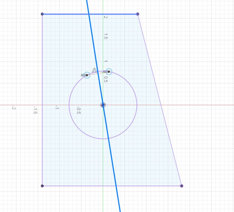

In the top picture, lets assume you used one side surface as the clocking datum(bad idea obviously as a midplane would be better, but let's spitball) and it was just milled at a terrible angle...this is what you would get. Yes both spheres in both clocking datums are the same distance apart, but if you measure them separately you must use half the basic dimension so not using the mid point seems wrong to me.
In the 2nd pic I use the mid point of both spheres to clock to make sure I measure them equally from the clocking datum to ensure a simultaneous convention.

Why? If what you care about is the distance between them, why do you have to split that distance equally? For example, if the nominal spacing between the spheres is 6 mm, does it matter if they are 3 mm and 3 mm or 4 mm and 2 mm from the plane you clock to?
Burunduk,
You are correct if manually checking the part. But I'm writing a program that must check 100 parts per week, run by operators, without any manual input or overrides. Therefore, to check them individually, I need to tell the software how far from a datum plane each sphere sits so I can apply a measurement output value to each spheres position separately. I can't let one sphere wonder around 1mm from an arbitrary clocking datum and then the other one float to 5mm. I need to set a distance from each that is static, so I would need to set it to 3mm from my analysis.
I'm just wondering if what I'm saying about using the midpoint of both spheres to clock is the only correct way to repeatably measure both spheres individually using a program that cannot change location or tolerance values and make sure they are passing if done simultaneously.
Wait a minute...I'm a complete idiot. If you use a poorly machined plane for the clocking you could still input 3mm for each sphere, it would just force the spheres to clock to that surface.
