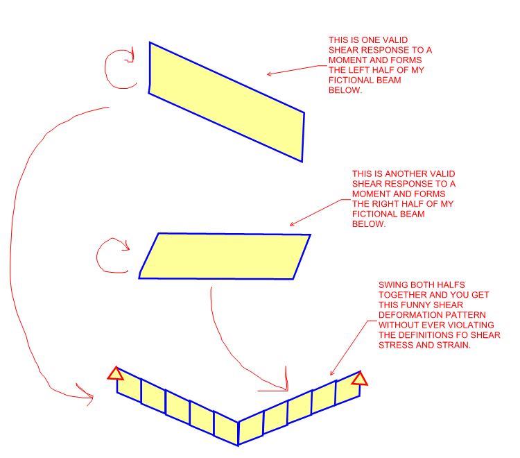

I submit the sketch below for consideration. It's a constant shear beam that isn't straight. I don't, for a second, believe that this would actually happen but, without invoking something beyond the entry level arguments, I don't see how it can be proven that it couldn't happen.
The right half in KootK's beam cannot "decide to shear longitudinally" if the left support is fixed. Otherwise it would create a discontinuity where the left and right halves meet.
Shear deformation in a prismatic element is a small change in the right angle at each corner of the element. If one vertical face is held vertical as is the case in a cantilever, the angle change must be measured from a vertical plane, so shear deflection must be vertical. If the horizontal face remains horizontal, as it does in a simple beam with moment at one end, the angle change must be measured from a horizontal plane, so deflection must be horizontal.
In the case of a simply supported beam with end moment and an unloaded cantilever at the opposite end, the slope of the cantilever is determined by the slope of the beam face to which it is attached. For shear deformation, the portion of beam between supports could be regarded as fixed against rotation.
I'm not so sure that is a discontinuity from the perspective of shear alone. Shear strain remains constant across slope change, as it should.

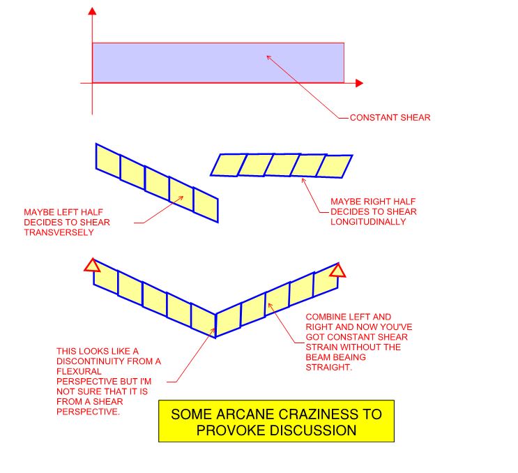

My last diagram is 100% in reference to a situation with a concentrated end moment, constant shear, and no concentrated load at mid span.
BAretired said:
In the case of a moment applied at one end, there is no shear reversal so your diagram has a discontinuity at the midpoint.
I get that this looks like a discontinuity if you consider the usual case of flexure dominating the deflected shape. However, I think that one needs to set aside those conventional expectations to really dig into the shear dominant situations. After all, does the case shown below, which I believe we agree upon, not also present as though it has a deflected shape discontinuity?

I disagree. See the second sketch below. I believe that both halves of my fictional beam satisfy the basic definition of shear stress and shear strain. Yet additional information would need to be introduced in order to preclude such a situation, as we know must ultimately be the case. The conventional mathematics only seem to tell us what the angular strain will be in our beam element. The mathematics do not seem to tell us whether those strains will be longitudinal or transverse. And, again, that was pretty much the impetus the the thread to begin with. If the basic definitions of shear stress and strain were getting the job done here, we wouldn't be having this conversation to begin with.
Kootk - I had a response in mind, but I would just be repeating what baretired said, so I gave him a little pink star instead.
I would add two things though:
No, it reverses in sign. If there was no change in shear strain the bottom face of the elements meeting at the section would have the same slope.

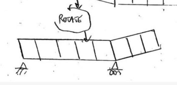

In your last example (5May 0:06) you have ended up with an inclined beam, fixed in position at the right hand end, rather than the left. You need to rotate it to horizontal, converting the "vertical" shear deformation into a "horizontal" deformation.
You have said that the statement that a straight beam under uniform shear deformation must remain straight has not been proved, but I think it is self evident:
- Under shear deformation the opposite faces of any segment remain parallel (by definition of "shear deformation").
- An equal shear force will cause the same change in angle of the corners.
- Therefore a straight beam will remain straight.
- If the bottom face of a straight beam is fixed in position at both ends, then it must remain horizontal if it is to remain straight.

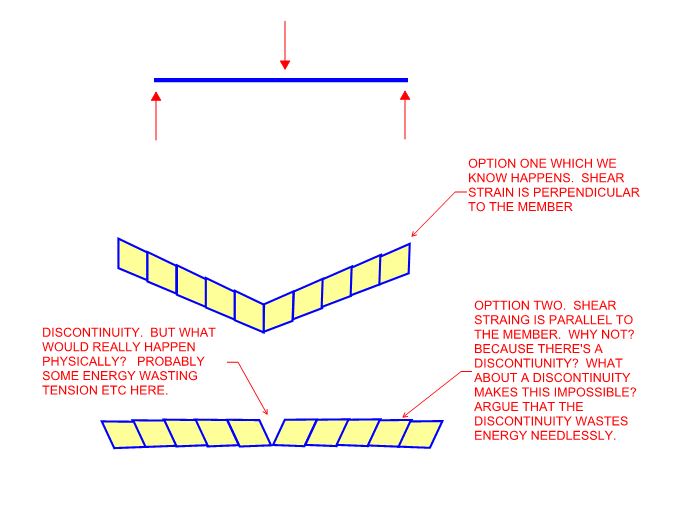

Consider this case:
1) I think we all agree that transverse and longitudinal shear strains are both possible under the right circumstances.
2) So here, how will the sheared elements "decide" to organize themselves?
3) Yes, I understand that option two has a discontinuity. But "discontinuity" is just a word. What is it physically about a discontinuity that makes a discontinuity indicative of an inadmissible solution?
4) I argue that, in the physical world, the discontinuity would represent a bunch of localized, energy wasting damage. And since nature prefers to to minimize unnecessary energy expenditures, the sheared molecules of the beam organize themselves in a way that is consistent with that preference (option one).
Personally, I don't know how to justify the choice of option one over option two without invoking energy arguments. If other methods exist, I'd love to hear about them.

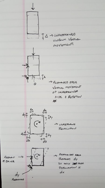

I thought shear deflection was due to the shear in the web, something not account for in Euler beam deflection.
But then you realise that generally the beam web has different shear stress on both sides of the shear load.
You guys seem to be saying that it's due to the curvature of the beam … that sections are being rotated ? But why isn't this captured in Euler beam deflection ?
Maybe because the deflected beam sections are no longer normal to the beam longitudinal axis ?
rb1957 - The Euler curvature is 0, since plane sections remain both plane and parallel. The rotation is due to the change in the corner angles, which changes at any point load.
