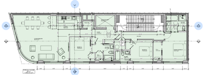

How tall is your building? What does your lateral system look like? Mind posting a plan view?
@slickdeals I am currently using the 0.5Ig provision to make it work, rather than go through the tedium of cracked and uncracked analysis. I'm not in a high seismic area (usually SDC B, sometimes A) but seismic drift controls a lot of design. Maybe I'm too conservative with it? I don't know, I just make sure it doesn't exceed 0.02 per ASCE 7.
I will be posting about this in another thread, because I have a question about outriggers and overstrength factor. But it's 12 stories. Factored wind base shear is 586 kips because it's Exposure C. I'm checking that number by hand because it seems too high, but that's where I'm at right now. I'm just getting seismic to work, then moving on to wind. Plan view isn't reflective of all the shear walls and stuff I added; the 3D view shows it better.
Can you add a concrete wall on the corridor side of the stair with link beams running E-W over the doors? That should give you some additional stiffness in the X direction and perhaps help remove the moment frame on the south slab edge? Have you considered include the wall + return on the trash room in addition?
Maybe there are good reasons why the above was not considered.
I didn't run a link beam either over the elevator opening or the corridor side of stairs because I don't believe I have enough tension development length. It will connect to about a 12" wall. If the returns were longer, it would be possible. For the trash room, I considered this, but MEP is vehemently against it because a lot of pipes will run through there, making the shear wall with a big opening and rendering it ineffective.

Would making that 15'-5" section along the South exterior edge a shear wall give you enough stiffness to solve your problem?
@W460x68 I would love to, but that is discontinuous at the base due to a storefront. I didn't want to get into a vertical irregularity or weak story situation.
Not related to your question, but be cautious putting a wall in front of the elevator as you show. They'll want it left open at the base for cab install (or a leave out that you have to pour later, yuck). In your sdc wind drift should control in Y.
