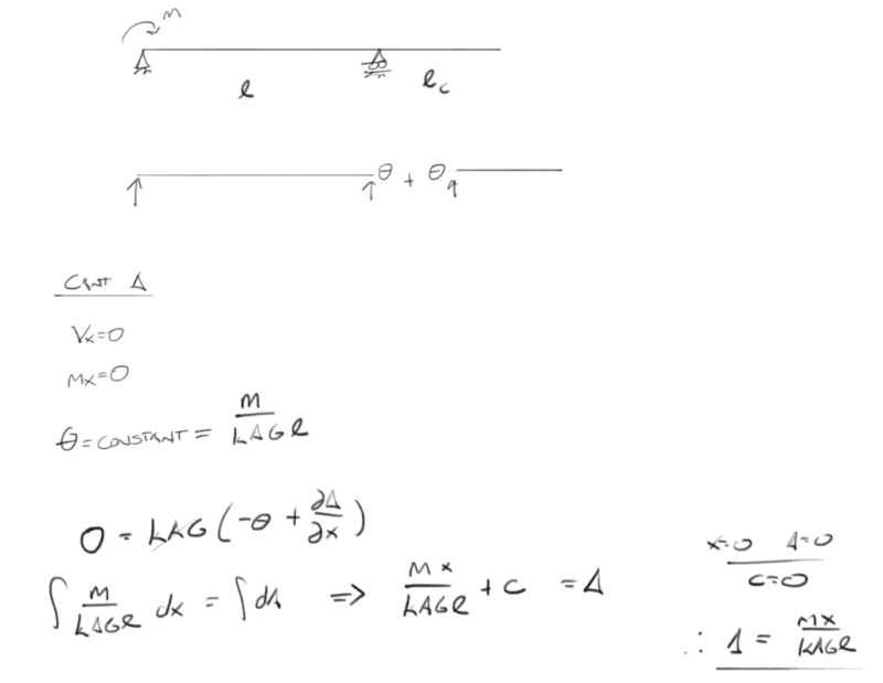

I was having trouble following along with the point load example in the scanned text reference so I did the general derivation for a point load and followed thru the example, pdf attached.
Open Source Structural Applications:
looks ok to me … now try your overhang beam (I don't see why, KootK's sketches aside, the shear deflection should change like that).

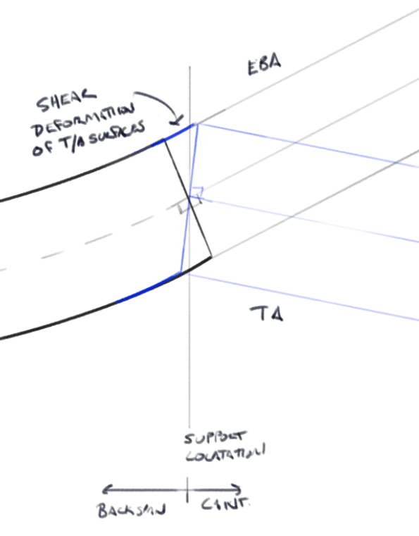

sketch below is how I understand it:
Black is traditional Euler-Bernoulli Behavior
Blue is Timoshenko Behavior
Under the point moment (Torque) the top and bottom surfaces of the cross section deform horizontally this changes the rotation of the cross section vertical axis. When you get to the unloaded cantilever there is no load on the beam to cause any additional deformation so the line of deformation remains perpendicular, normal, to the cross section vertical axis so the cantilever maintains the initial cross section rotations throughout and the deflection is simply the distance from the support multiplied by the rotation.

The inclusion of the shear deformation introduces a new rotation of the cross section in the case of the clockwise point moment (torque) this rotation is constant and counter to the rotation caused by bending when you get past the point of maximum deflection in the back span. So when you get to the right support the rotation of the cross section is such that the normal axis is now pointing down instead of up.

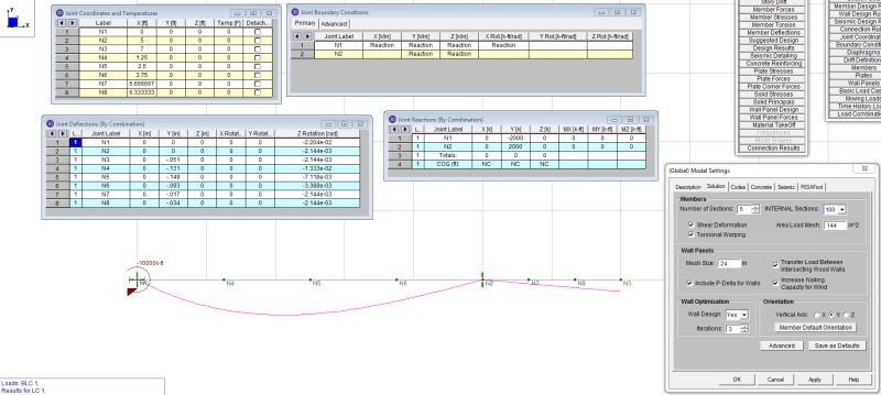

Something is wrong here!

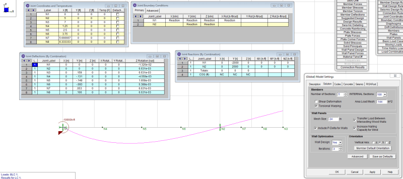

Shear deflection of the cantilever may be as shown in KootK's sketch, but total deflection (bending plus shear) cannot be as shown in the computer output by Celt83 on May 2nd at 15:15. Surely the net deflection is primarily due to bending, not shear. I am questioning the output labeled "Bending plus Shear Delta" in that post.
BA
BA:

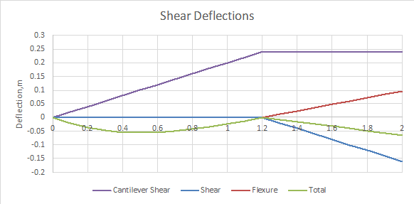

That is the bending plus shear deflection and is certainly an extreme case. The applied moment is 10,000 ft-kips main span is 5ft and the cantilever span is 2 ft. The short span and large loading was my attempt to make sure the deformations of the beam were greatly impacted by shear deflections as to make them more obvious.

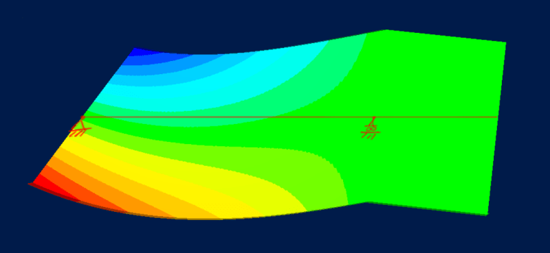

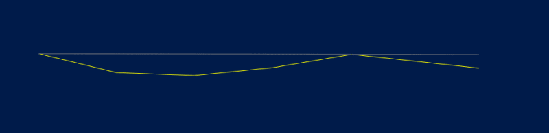

Same analysis done with RISA-3D:
bending only:
bending+shear:

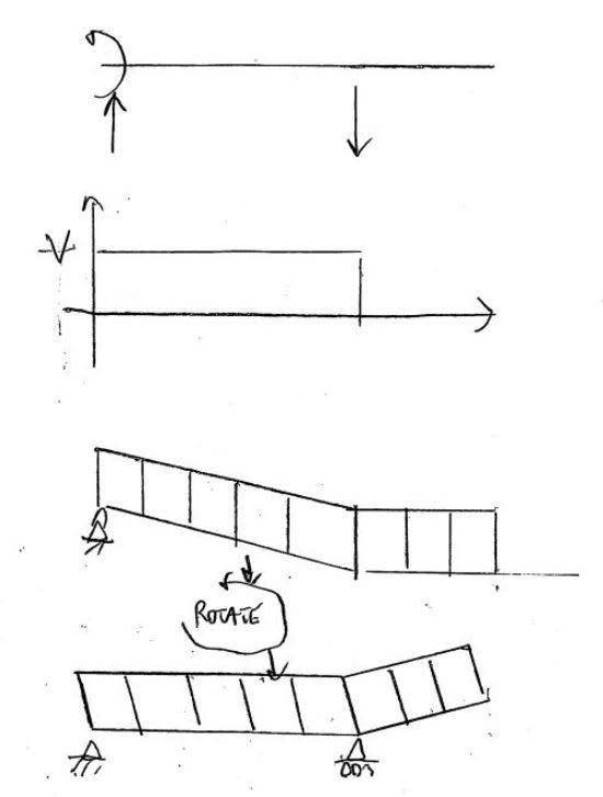

For me, the simplest way to look at this is still to find rotations for a cantilever, fixed at the point of moment application, then rotate so that deflection at the other support is zero:
Line 1. Find shear deflections for a cantilever fixed at the left hand end, with an upward force of M/L at the right hand support. Vertical sections will remain vertical, but over the region of constant shear there will be a constant upward slope. To the right of the right hand support there is zero shear, so the beam remains horizontal.
Line 2. Rotate so that deflection at the right hand support is zero. The beam is now horizontal between supports, with the right hand end sloping down.
Line 3. Calculate deflections due to flexure only.
Line 4. Add Lines 2 and 3.
Doug Jenkins
Interactive Design Services

You just need to look at the end conditions.
For the cantilever loading the fixed end section will remain vertical, so all the other sections remain vertical, and shear deflections can only be vertical, with regions of constant shear having constant slope. When it is rotated the shear strains do not change, but the sloping part of the beam is rotated to horizontal, and the end horizontal part is given a slope.
Doug Jenkins

But if you actually applied the cantilever loading, then released the end rotational fixity whilst maintaining a constant moment and rotating the beam to horizontal (between the two supports), the rotation would actually occur, and you would end up with exactly the same loading as if you had applied the moment directly to the simply supported beam.
But if you don't want to do a rotation, imaginary or otherwise, then you know that the beam between supports must be horizontal, and since the shear force is constant the bottom surface must remain straight (for shear deformation), the shear deformation can only be horizontal.
Doug Jenkins

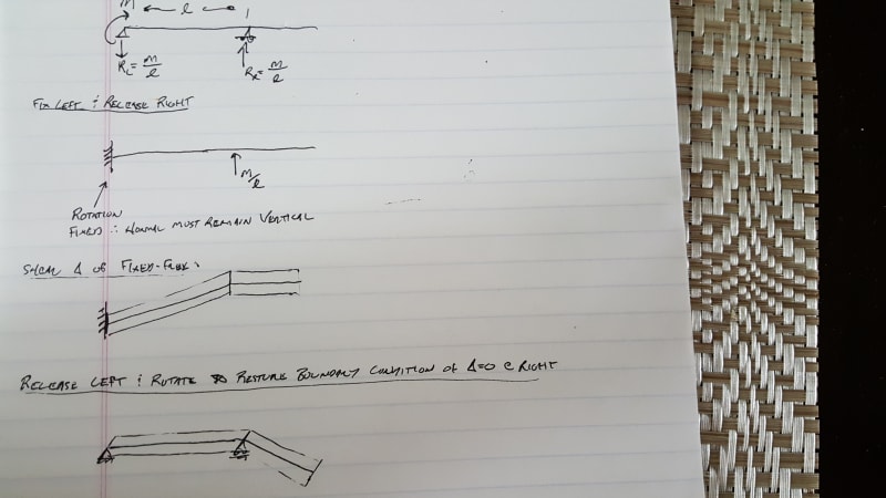

Koot:
I believe IDS is saying look at it as a fixed-free beam and then restore the boundary condition of deflection = 0 at the right support by releasing and pivoting about the left support.
IDS hopefully I understood this right and it seems to make a lot of sense.
