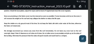

Well the 3070V, 30' x 70' from TMG comes with an instruction book.
On the last page it has this to say about snow.
So one reputable vendor is telling you that EVERY SNOW FALL you somehow need to go out there and not only brush off the snow but also not let it pile up around the side.
