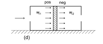

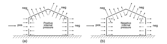

The idea of a wind load canceling itself out in global stability comes from this diagram in EN 1991-1-4. If the internal pressure is always either positive or negative on all internal surfaces, then for a box inside a building you would have opposite forces on either side of the box.1749708177785.png

Considering the Eurocode also gives this schematic then using both positive and internal pressure at the same time should be conservative for a wall/box inside a building that isn't fully splitting the space. I don't think it is correct to use only 0.3 or 0.2 on both sides as one is for pushing and the other suction. In this case you would have both, so one side would get 0.2 and the other 0.3

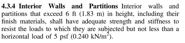

Jae do you have a reference in ASCE 7 for that? I still see that as a live load in 4.3.4
I am pretty sure its actually in the IBC (in 2012) 1607.14 "Interior Walls and Partitions"
There's a "partition live load" that deals with the vertical dead weight of interior partitions. That was based on the ASCE 7 committee using a metal stud wall sheathed on both sides with gypsum board sheathing and spaced at 10 ft. o.c. getting you to 15 psf or so.
The lateral partition loading is indeed in the IBC as jj1317 states.
Thanks pham. It wasn't included in my older 7-10 version and I don't have access today to the more current versions.
