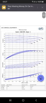

Thanks guys, finally got the pump curve from the company. Hope our conversation will help someone else. For new engineers like me we are sometimes confused with data on nameplates and whats happening physically so. As you can see, with given information on the pump of head 40m and capacity 9m3/h, the motor of 3HP suffices. A novice engineer would then question the 5Hp!

I'm now wondering if the pump nameplate actually say 3.5 kW as the photo is unclear whether the figur eis a 3 or a 5 when you compare it ot other 3's and 5's on the nameplate.
At 9m3/hr t sure looks like it should be 3.5kW.
But like we keep saying are you measuring the actual flow and are you sure you're actually doing 9-10m3/hr and not 20+ m3/hr??
That pump curve is pretty/ very flat so there won't be much drop off in head / pressure but flow just keeps increasing as does power, though to be fair the efficiency gets better as well at higher flows than 9m3/hr.
So either you're flowing at a higher flow, you've used the wrong connections onto your motor / wrong voltage or your motor is faulty.
The pump nameplate indicates that the impeller size is 173 mm diameter. However, a 173 mm diameter impeller pump curve cannot achieve an operating point of 40 m head at 9 m3/hr flow according to the pump curves you attached. If it were a 173 diameter impeller then based on the curves the pump reach 3.7 kW power at about 43 m head and 14.5 m3/hr flow. If your system head/flow curve is such that you are at this operating point with a 173 mm diameter impeller with a 3.7 kW motor then you will be overloaded. See attached pump curve.
It appears like a 165 mm impeller will get you 40 m head at 9 m3/hr flow. If you really have a 165 mm impeller than as you reduce the head and increase the flow to end of curve, it looks like you will still be just under 3.7 kW brake horsepower so the motor will not be overloaded. So if you installed the pump in as system with lower head loss that it was not designed for you will not overload it even at the end of curve.
The question is - what is the actual size of the impeller in the pump? And what is the actual system curve of where you have installed it. I assume you took the pump form another system and are now reusing it in a system it was not designed for originally.
