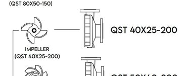

I tried to find a pump curve from the manufacturer on their website but they don't have one available. In fact they are one of those manufacturers in india where the pumps appear to be just knock-offs.
The pump nameplate shows operation point of 132 feet at 40 gpm which is very high head at low flow. Likely OP stuck pump in a very low loss low required head system and now is running at end of the curve and overloaded. Solution would be to put a throttle valve or back pressure regulator to reduce flow and power required.
They are an open impellor simple pump made in India,so could easily have terrible efficiency. Their website is next to useless in terms of data. Looks like this so might be 20% efficiency.
