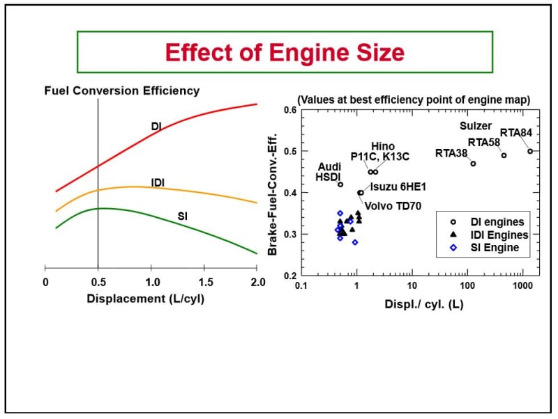

hi all.
im new to this forum hope to learn from it.
i have a question i hope can be explained regarding engine piston size.
so i recently bought a new truck for my business. its an isuzu with a 5.2liter 4 cyl motor.
and i got thinking why are engine designers now making engines with larger fewer piston. 20 years ago a 5.2l motor would have been a v8. why is it now a 4cyl
thanks

Simple facts.
Diesel efficiency increases with cylinder dimensions in all practical sizes.
SI efficiency plateaus and falls when cylinder dimensions exceed some (much smaller) value.
Examples of different engines with "massive" (86mm vs 98mm) bore difference is light years from the point. Sure - that 98mm bore is still working fine (and the fact that SI engines are mass produced with even larger bore indicates that SI efficiency is still satisfactory in this size range). But what happens when you enlarge it to 198mm? No problem for a Diesel.

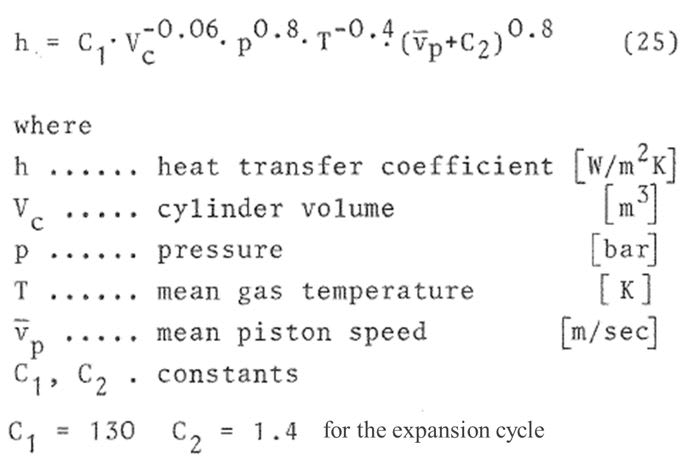

A point of clarification...
Shouldn't "large bores have high heat loss," "long strokes have less heat loss," and "small cylinder displacements have higher heat loss" type rules of thumb be caveated with "all other factors being the same?" I often get surprised by how much effect the other factors can have.
I believe convection loss from the gasses to the cylinder walls is calculated by Q (Joules) = TimeStep (seconds) * Heat Transfer Coefficient (W/m2/K) * Area (m2) * (Gas Temp - Wall Temp)(K) where wall temp is typically around 366K (200F) to limit oil breakdown. In my model, I use Hohenberg's heat transfer coefficient (similar to Woschni's coefficient but shown by experiment to be more accurate for HCCI) shown below. Note the largest exponent is on mean piston speed which increases with stroke. Holding displacement, cylinder count, RPM, peak combustion temperature, wall temperature, and time step constant, my model indicates 63.5% efficiency with bore of 3.077 inches and stroke of 0.375 inches but 62.6% efficiency with a bore of 1.526 inches and a stroke of 1.526 inches. The largest difference between the two cases in the heat transfer calculation is mean piston speed (22 feet-per-second in the first case and 89 fps in the second). Equally surprising is the fact that efficiency for a given displacement does up when the number of cylinders is increased. With a 49.5 cc displacement in one cylinder, my model shows 63.5% efficiency but that figure goes up to 64.3% with four cylinders and 64.6% with six. The interaction between numerous variables appears to consistently break the "rules of thumb."

Common sense plus a basic understanding of pre-mixed combustion.
As you increase the cylinder size of a SI engine the rpm will decrease -> convective heat transfer to the end-gas will increase. Relatively fixed flame speed means that time duration of the combustion process will increase -> radiant heat transfer to the end-gas will increase. Sound like a recipe for detonation? Might need to reduce the CR? Efficiency maybe suffers? You said as much yourself: "Bear in mind that the larger your bore - and cylinder size in general - limits you in the realistic attainable compression ratio you can achieve"
Here are some examples for you to think about.
The OP refers to a truck engine with displacement of 1.3 litres per cylinder. Do you know of any current on-road SI engines with cylinders this big?
The largest current SI cylinders I can find are on a Wartsila gas engine with 50cm bore. This engine is lean-burn and uses a sophisticated jet-ignition system to rapidly ignite the entire combustion chamber.
Current marine diesel cylinders are typically 100 cm bore and approximately 2,000 litres per cylinder

RodRico, thanks for the plots, unfortunately it combines engine friction with thermal losses.
What would be more useful would be to show indicated thermal vs engine cylinder size that doesn't include the frictional aspect.
In all the Annand and Woschni models I've tuned to MEASURED single cylinder data, I've invariably had to tune it to the measured data. Usually separating open valve heat transfer to closed valve.
Starting with the equations/simulation- with no measured data is only a beginning and - once the engine was built and tested, invariably was some way off. The second iteration of the correlation of the model to measured data is where I found most of the REAL learning begins. This is invariably the downfall of every start up company I've consulted for.

Marquis,
The original poster asked about piston size, not thermal losses. A plot showing the clustering of displacement per cylinder provides valuable insight regarding design points that were selected for a variety of reasons including efficiency (heat loss, piston friction, pumping loss, etc.), emissions, manufacturing cost, design reuse across models, etc.
Yes, every model ends up getting tuned with measured data. That doesn't mean it can't provide insight into the interaction of variables during the design phase. Anyone who thinks a heat transfer or CFD model provides a final answer is naïve. The models are intended to get into the ball park and nothing more; a working model doesn't guarantee the engine will attain the indicated performance, but if the engine doesn't meet (or exceed) desired performance in the models, it most certainly won't meet them once built. In my current effort, the models exceed the targets that define a marketable product by 15% to 20%. It's going to take a lot of work and several iterations to find out what the final performance is.
