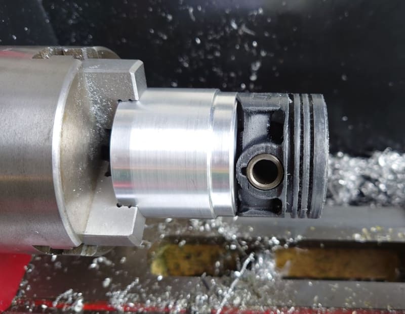

This is a piston I had DMLS printed from AlSi10mg - the geometry is derived from generative design using some basic inputs and a starting shape. It's really just an experiment whether a consumer grade design and print can be bolted in and work for a time.
After machining, it is predicted to weigh ~50 grams vs the OEM 79 grams (1970's Honda XR75). The question is, will this lighter piston result in a small power increase as less work done by reciprocating the piston? Theoretically, the rate at which work is done will be increased?
With the reduced mass, the redline could be increased slightly due to less inertia load, but besides that? Of course, the engine should be more responsive (quicker to spin up) and with a much smaller skirt area, less friction too.
By my calculations, at maximum piston acceleration (~TDC) @ 11,000 RPM, the inertia forces on the piston are about 33% less.

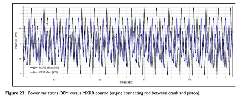

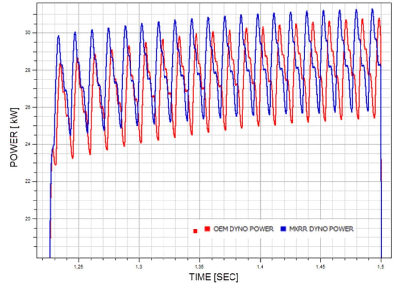

Just came across a very well-done study that showed the dynamic effects of a lightweight titanium con-rod and wrist pin (MXRR) vs Stock. The wrist pin is 100% reciprocating, and the connecting rod is some ratio of reciprocating vs rotating; so at least some of the conclusion applies to pistons as well.
"The OEM piston rod mass was 173 g while the piston and pin masses were 158 (including rings) and 34 g, respectively.
MXRR model presents an I-shaped rod design made of a Grade 5 titanium, which enabled a lower rod mass (125 g). The stock piston was used, but the titanium rod had lower mass (27 g). The total weight saving on the titanium versus the OEM rod was therefore 55 g."
Here are some of the findings that apply to this thread:

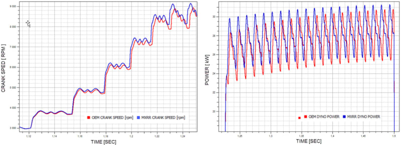

"In phase 2, maximum MXRR crankshaft acceleration is in average 5% higher compared to the OEM engine. The difference in acceleration increases up to 9000 r/min due to more available engine torque. In phase 4, the difference is 8%. This is not as obvious since available engine torque drops 20% between 9000 and 14,500 r/min as seen in the HONDA CRF250R torque curve in Figure 7. The MXRR accelerates faster causing a faster drop in available torque which should decrease the difference. However, the OEM reciprocating mass requires more effect to accelerate/decelerate as shown in the KPI-8 section. The net effect is higher engine acceleration for the hole power band when lowering the connecting rod mass.

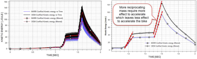

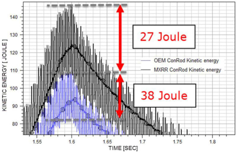

Through FTB, it was possible to clearly demonstrate the importance of minimizing the reciprocating mass of connecting rods.13 The kinetic energy variations were calculated for the OEM steel and MXRR titanium rods as shown in Figure 21. The kinetic energy was filtered with a 100 Hz low pass filter to remove energy fluctuations and visualize the energy (work) that is required to bring the MXRR (95 J) and the OEM (125 J) connecting rods up to maximum speed (14,500 r/min). Compared to the OEM rod, the MXRR titanium rod requires 24% less energy which has a major impact on the throttle response and gas consumption (Figure 22).
The peak power required to accelerate the OEM rod at constant speed (9000 r/min) was 1.1 kW while the MXRR titanium rod only required 0.85 kW (Figure 23).
Motor power (KPI-9)
Just before 9000 r/min, the dynamometer brake was switched on and the output power was measured for both engines as shown in Figure 24. The left curve shows that the MXRR crank is accelerating faster to 9000 r/min due to less reciprocating mass and hence has a quicker throttle response. The MXRR crank therefore initially produces more output power (1.5 kW). The difference in output power reduces to 0.4 kW when constant speed is reached (the different inertias have no effect at that point).

Check this out - " Before the test run was executed, the crankshafts were balanced in a separate FTB model. " The improvement in that study is also due to changing the masses of other components besides the crank. Seems like this was mentioned in this thread - "At the lower stress the crank could lose some weight, certainly from any counterweight."
I don't understand "The 22% peak stress reduction for the MXRR titanium rod is achieved due to a better stiffness-to-mass ratio" as the stiffness to mass ratio of most metals is relatively constant - specific modulus is identical between steel and titanium and slightly higher for aluminum.
You quoted the part you liked, leaving off the part that is important:
The peak power required to accelerate the OEM rod at constant speed (9000 r/min) was 1.1 kW while the MXRR titanium rod only required 0.85 kW (Figure 23). This energy is taken and returned to the crankshaft at TDC and bottom dead center (BDC) and hence not representing a loss in itself. However, due to structural damping and friction effects, the MXRR rod will transmit more output power and less vibrations.
One is looking at the far smaller fraction lost to structural damping and friction. The delta above is about 1/3rd HP, and damping and friction are likely 1% of that, so 1/300th of a HP difference in losses; probably on the same level as eating a burger before the race adding weight to the rider.
So, if all you do is change the mass of the piston, vibrations will increase and there will be greater damping and friction losses. Contact the authors of that paper if you want mathematical support. It's far more complex than f=ma.

I did see it and the description:
The difference in output power reduces to 0.4 kW when constant speed is reached (the different inertias have no effect).
No kidding, lower inertias store and return less kinetic energy as seen during transient conditions. That's why engines with really low component inertias tend to have really poor idle characteristics compared to those with higher ones. Most engines are designed to operate across a useful range, and it sucks to have the engine die whenever the throttle closes.

Look closely 3DDave, you might've missed another observation...
The engine with less reciprocating mass has higher peak power AND lower dips in power (during acceleration obviously).
