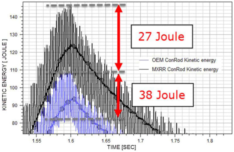

This does not seem to mean that there is no effect on engine performance according to the study referenced in the thread. Otherwise, why would the study mention this effect?

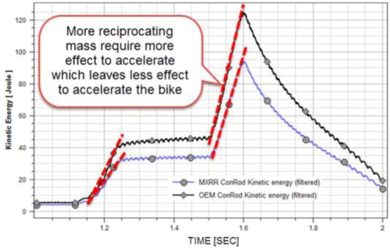

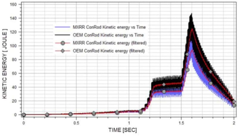

The kinetic energy was filtered with a 100 Hz low pass filter to remove energy fluctuations and visualize the energy (work) that is required to bring the MXRR (95 J) and the OEM (125 J) connecting rods up to maximum speed (14,500 r/min). Compared to the OEM rod, the MXRR titanium rod requires 24% less energy which has a major impact on the throttle response and gas consumption (Figure 22).

The power shown in that chart is not BRAKE power. You will get a similar result by lightening the flywheel but zero increase in BRAKE power. See my post above.
Yes, a steady state dyno won't show increases in BRAKE power because the reduced reciprocating inertia isn't being accelerated. But I don't see why this matters. That extra initial 1.5 kW (2hp) does have an effect during acceleration. The engine will be used dynamically on a dirt bike, not sitting at a constant speed.
