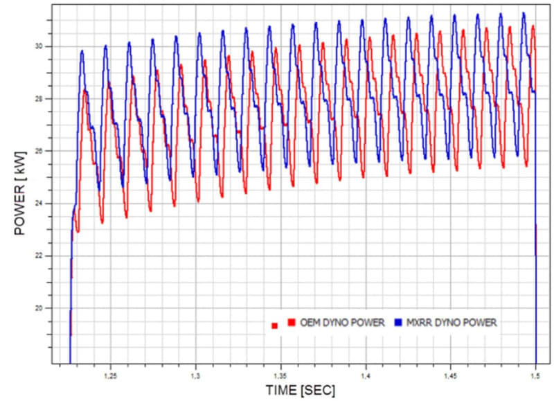

Look really close and see that is a non-zero based graph.
Those peaks are transient. Integrate the area under the curves to see what the energy delivered is. The instantaneous difference is nearly 4hp, but because it is such a narrow peak the realized amount reported is only 1.5 average, dropping to 0.4 hp and that appears to be from the higher RPM as shown on the left hand graph of figure 24, about 200 RPM higher on the lighter rod.
200RPM/9000RPM is a 2% increase in fuel burn rate - coincidentally it should mean a 0.6 hp increase on a base of 30 hp, where they only got 0.4 hp increase.
The drop off in RPM is slightly higher through the cycle with the lighter rod because it hasn't got as much inertia to drive the non-combustion cycles, which is what I said. The dips in power with the lighter rods is also greater as there isn't as much inertia to pull it through.

3DDave. The error made in interpreting the "dyno" graph is not one of integration. If you integrate the two curves, the blue curve clearly indicates higher "power".
The error lies in the use of the term "power" when displaying results from an inertia dyno. "Brake Power" is power absorbed by the dynamometer brake - something an inertia dyno cannot do. The blue curve is not showing higher brake power. It is a result of less energy being absorbed by the inertia of the engine itself, so more energy can be absorbed by the inertia-dyno-flywheel. As Greg Locock pointed out above, the lighter piston is producing a similar result to a lighter engine flywheel.
So, the blue line (light weight con rod and wrist pin) which shows increased power, is not power because it was measured using an inertia dynamometer?
Equal time spent above and below zero (figuratively). It does not matter what the peak is, only the average. Take the integral to get meaningful information.
I always here people who don't take higher level math complain about how it relates to the real world. Well it's calculus that does that.

Equal time spent above and below (figuratively). It does not matter what the peak is, only the average. Take the integral to get meaningful information.
You realize we're referencing this graph, right? There's no time spent below zero, and if you did find the area under the blue curve, it would be higher than the red curve. Meaning, the lighter weight reciprocating components make more power, faster, than the heavier OEM Honda parts on average.
zero
I said figuratively. You can fit a trend line through the data and you'll find that it averages it out quite completely. As others have said you need to integrate the data. Thats going to give you a number instead of a visual representation.

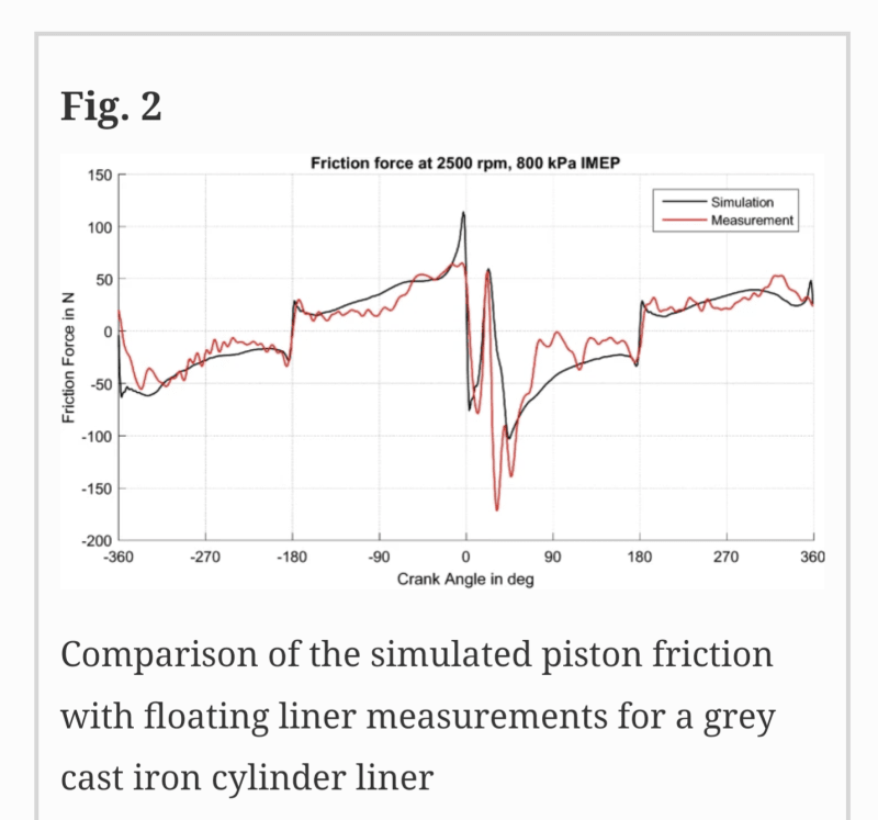

Here is a diagram of friction vs crank angle of the piston and cylinder wall.
I think most of that friction is from the ring pack so the piston weight is mostly irrelevant.

You don't need a trendline or integration to see that the lighter reciprocating components have higher average power on that chart. The thread is not about how much power is freed up with lower piston mass, but is there more power with a lighter piston - the answer is YES, lighter pistons do give higher output power at the crank.
If you look at your chart, the red data has a slightly increasing delay for each peak indicating the test was run at a lower rpm. This would explain the difference in power between the two data sets, more so than piston mass.
We're getting closer...
I don't know the exact split, but side forces can be pretty high, especially in oversquare/short stroke configurations.. so I wouldn't disregard skirt-to-wall friction completely. But, the effect of piston mass on skirt-to-wall friction is going to be very small. So it's all basically the same thing, ie:
'mostly irrelevant' does not equal zero. I've been saying all along: the effect due purely to mass is very small but not zero
How does friction and force relate under fully hydrodynamic lubrication conditions? This is the case at all times except the few degrees around TDC and BDC
The power shown in that chart is not BRAKE power. You will get a similar result by lightening the flywheel but zero increase in BRAKE power. See my post above.
