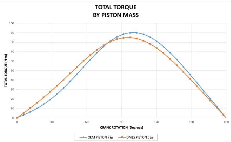

This is a piston I had DMLS printed from AlSi10mg - the geometry is derived from generative design using some basic inputs and a starting shape. It's really just an experiment whether a consumer grade design and print can be bolted in and work for a time.
After machining, it is predicted to weigh ~50 grams vs the OEM 79 grams (1970's Honda XR75). The question is, will this lighter piston result in a small power increase as less work done by reciprocating the piston? Theoretically, the rate at which work is done will be increased?
With the reduced mass, the redline could be increased slightly due to less inertia load, but besides that? Of course, the engine should be more responsive (quicker to spin up) and with a much smaller skirt area, less friction too.

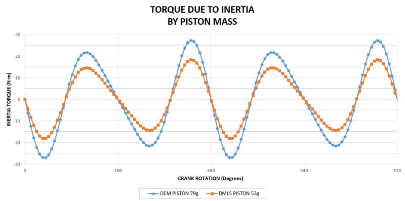

By my calculations, at maximum piston acceleration (~TDC) @ 11,000 RPM, the inertia forces on the piston are about 33% less.

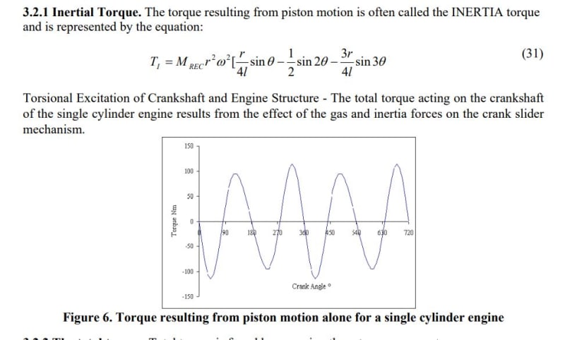

Can we agree that lower piston mass will reduce the torque due to inertia?

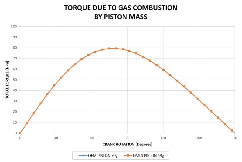

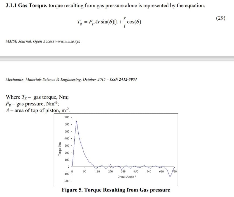

Can we also agree that the torque resulting from gas expansion is equal for each engine (one with a lighter piston, the other stock)?
And that the total torque generated (not including resistive torques for simplicity) is the sum of these torques?
It seems that the effect of lower reciprocating mass is an increase in the rate of torque. Can anyone confirm or refute this mathematically? Not with conjecture

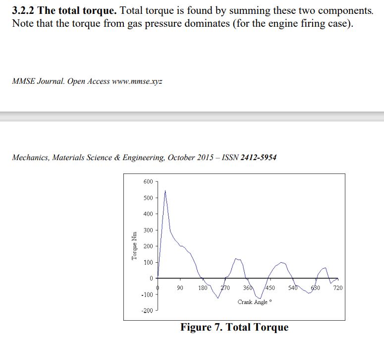

Now, integrate those graphs over a complete cycle. In the idealised cycle (neglecting friction), the instantaneous inertial torque integrates to zero over a complete cycle. The gas pressure torque integrates to the net output crankshaft torque when integrated over a complete cycle.
Reducing the mass of the piston reduces the magnitude by which the inertial torque fluctuates above and below zero, but the result of the integration over a complete cycle will be the same: zero.
The results of reducing piston mass are in the vibration, stress, and secondary knock-on effects.

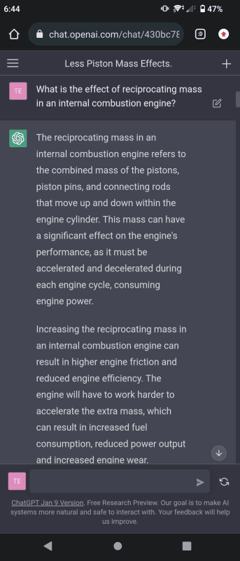

One month ago " The only (I think) piston mass related effect that absorbs power over one cycle is friction". Have we made any progress?
Cheers
Greg Locock
It seems we've time traveled since this thread is only 9 days old
It certainly seems like a month ago at this point.
Show us the sources ChatGTP used. There must be a study where the only variable is piston mass. Better yet, there must be a study where the change in operation due solely to piston mass was predicted and then a double-blind test done with pistons of various masses to generate data to compare to the predictions.
Not a bad effort for a Regurgitron.
