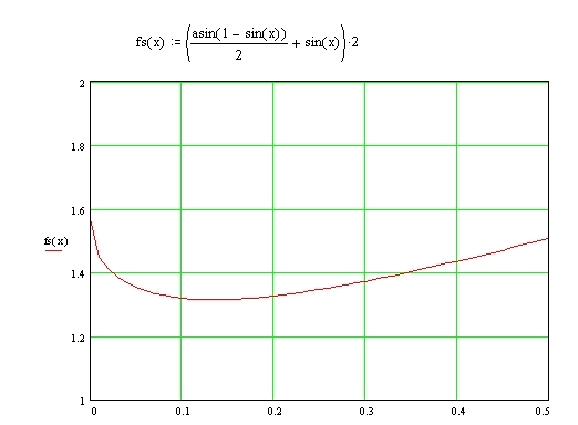

This isn't the optimum solution, but I'm happy to settle for this.
It is just a case of finding the minimum value of the equation shown, then the shift required is read directly from the y axis.

I guess that the phase shift is in radians. If so, is it really plausible to add arcsine (range +-Pi) and sine (range +/-1)? To me, it is a screaming unit incompatibility. Did you test this? With meaningful results?

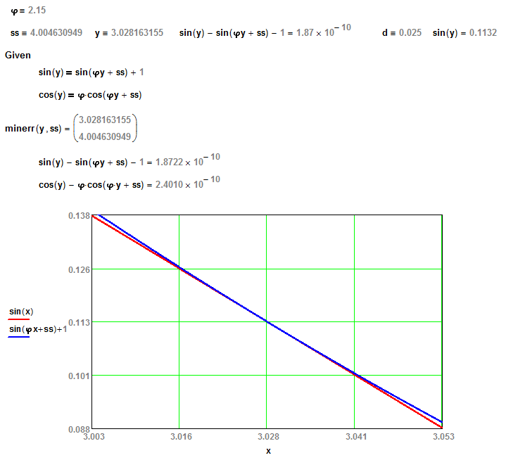

Attached xlsx file graphically shows a solution in the neighborhood (x = 3.0, theta = -1.85)
It is similar to my previous-posted pdf, except there is a correction in the curve labeling and some format changes.
Op's solution suggests theta = 1.3. If I plug in theta = 1.3 it doesn't suggest a solution, but if I plug in -1.3 into my spreadsheet (cell B2), then I see another solution around x=0.2. Maybe that is consistent with op's solution posted above if we have defined theta with opposite polarities of each other. Although I didn't follow the logic of how the op came up with his graph.
I'm not so sure about my previous analytical solution leading to z = 1/3 +/- |sqrt(4/3)| = 2*sin(2x+theta). Doesn't seem to match my graphical solutions.

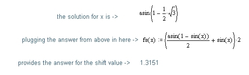

Here are the solutions for the case I am interested in.
There are other solutions, but this is the one I want.
Ignore the fact that the value of the shift is positive, it just refers to the shift of the other wave.
I know this works.
I've graphed it and it is perfect, as it is also in the AWG
MRSSPOCK- can you explain how you came up with your solution?
(it looks correct but I'm curious how you got there)
(2B)+(2B)' ?
Which simplifies further to ->
