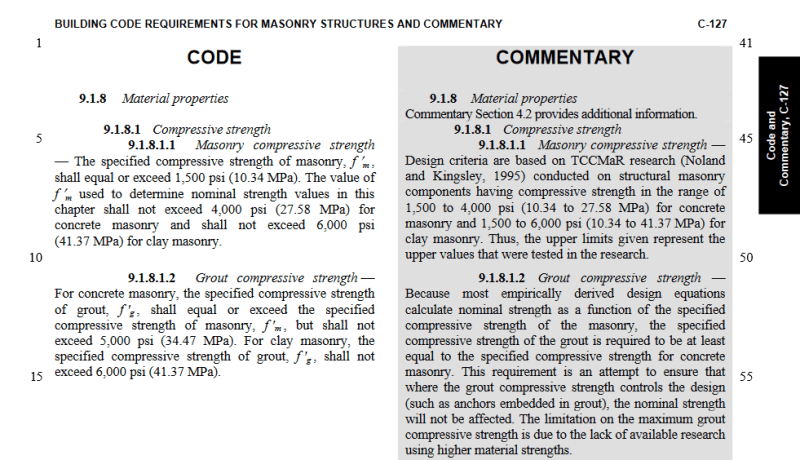

Masonry question - is there a minimum f'm value below which the equations of ACI 530 cease to apply?
Specific situation: I'm looking at a new connection to an old-ish clay brick masonry wall (double wythe). At this point I don't have good data on the existing material, and I'm betting I never will, so my approach was to assume a connection geometry that should work, and check the minimum f'm needed just to gut check myself. Well...f'm(min)=5.72psi to preclude crushing. On the one hand, I can't break the brick between my thumb and forefinger so it's probably strong enough. But...that's just so low I find it hard to believe the equation is telling me the correct story based on the context.
I searched google and the ACI 530 commentary but came up empty handed. Anyone have any insight? Thanks.
I would be inclined to take equations involving f'm with a grain of salt for your situation.
BA
Aha! Thanks, BA. I knew it had to be in there somewhere. I use ASD when looking at older load bearing brick, and chapter 8 doesn't appear to have a similar provision/guidance.
It's interesting, though, because the Brick Industry Association lists a unit strength assembly for f'm=1000psi (Technical Notes 3A, Table 5).

Thanks, everyone. 500psi is the lower limit I usually try to stick to without additional testing when dealing with older structural brick, and is what I used here. The connections are through bolted, so my primary concern was local crushing due to shear.

The supporting research cited by the code was based on test specimens with f'm=1500psi to 4000psi. So we know that the equations are good for that range of strength. Below it is "uncharted" territory.
So I'm pretty confident that my solving of the masonry crushing value at the anchor bolt for minimum f'm provided a "false" result - I doubt a 5psi f'm would resist crushing in the way that the equation seems to "predict." I'm just curious where we cross back over - if I use the equation with a 500psi or 750psi f'm for older and softer brick, is the result reasonable or should I doubt it? Do you know of any additional research that has explored lower values?

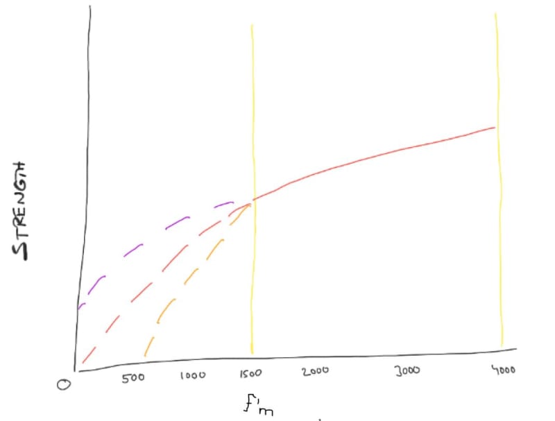

Here's a quick sketch to outline my curiousity/concern.
If the testing has only been based on f'm between 1500psi and 4000psi, what do we know about the performance of masonry assemblies at failure that are weaker than f'm=1500psi? Does it follow the behavior of the tested material and follow the red dashed line? Is it somehow stronger (I doubt it, but stranger things have probably happened), or does it follow the orange dashed line and actually result in a weaker connection/wall/assembly than the equations predict? We assume that things like the elastic behavior of the wall follows the assembly's compressive strength. So as it gets weaker, it gets more brittle. Is that change substantive enough to alter failure modes and change the shape of the strength curve with respect to f'm?
The answer may be "we don't know" and that it's a potential area of further research. It may never happen unless a conservation group sponsors it, but here's to hoping.

I think the question PhamENG is looking to get answered is can you enter into the TMS 402 (ACI 530) formulas for things like anchorage, axial stress, bending stress, etc. with an F'm lower than 1500 psi or are those code equation no longer valid.
For example equation 8-3: Bap = 1.25 Apt √ F'm , can F'm in this formula be below 1,500 psi?

OK, now I see what you are getting at and I don't think I have a good answer. I believe that the relationship would be rather linear as in Pham's middle red line, not the purple or yellow lines. Here are a couple of pages from "A Historical Survey and Analysis of the Compressive Strength of Brick Masonry" by C.B. Monk and the Structural Clay Products Institute. This paper pulled in data points from the 1890s to the 1950s so it has high and a lot of low values. Except for Type S mortar in Fig. 4-5, all of the data shows that f'm of the wall is linear to the strength of the brick unit - all the way down to around 1000 psi. I am sure that TMS excluded some of the oldest data points when they developed the Unit Strength tables in TMS 402/602 (previously ACI 530), but I don't know how many TMS equations are valid for anything below 1,000 psi.
