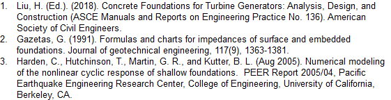

Ref 3 had something on modeling the stiffness deficit but I never quite got it to work how I liked on my last project
Thanks Canwest.
Regarding your response 1. When you add rotational springs, would you calculate the existing rotational stiffness provided by the vertical springs and provide the deficit with your single spring? Is that what the Harden paper focuses on?
The harden paper puts stiffer springs on the "flanges" of the footing. There is a method in the paper to calculate the deficit as well so you could just add the rotational spring in the, i like to sanity check by applying a static twist at the center and seeing the rotation of the node to make sure it is working properly. I'm usually actually running a few models, one with rigid links to a central support (high stiffness), one neglecting the extra rotational stiffness (low stiffness)
