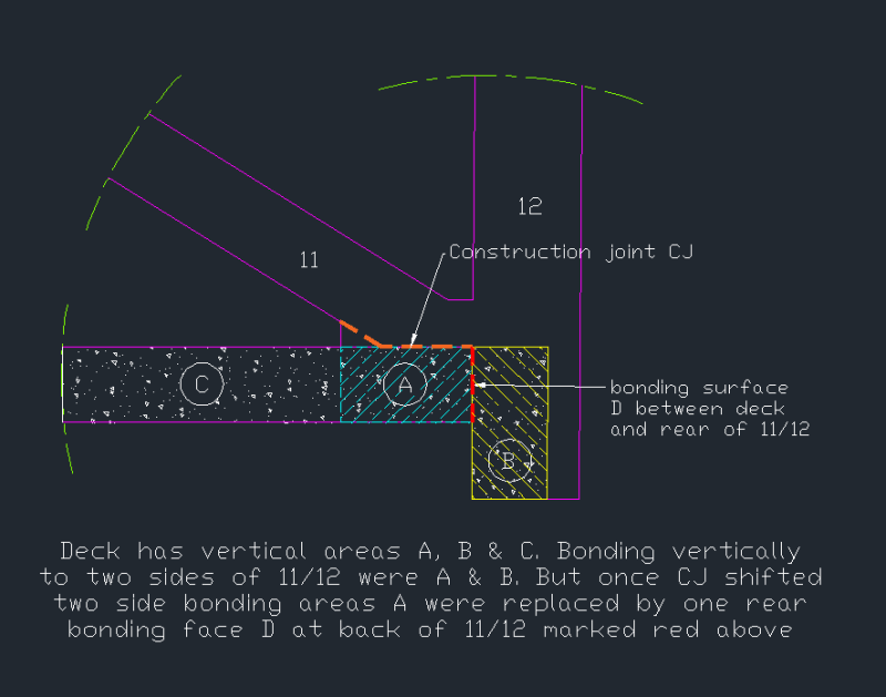

I post the follow sketch to higlight some of the important considerations
I have shown three section of the deck in A, B and C. C and A were highly stressed laterally by the transverse tendons whereas Member 11/12 was unstressed in the same direction. Thus the interface is prone to crack when there is a major change in stresses in the components. These members were initially held tight together by the PT rods in 11. According to OSHA report 11 has no structural crack at the CJ prior to the bridge removal from the casting yard.
The CJ was seen open up (or cracked) after the bridge had been installed at its final position and the PT rod stress was removed. At this point 11 would have its highest compression load (less only the live load) and it could only hold its position if its joint with the deck did not break.
It can be said with certainty in any court of law that the joint in question had already failed structurally prior to the collpase and re-tightening of the PT rods. The following sketch shows the effects from the embedded items.
Prior to the collapse we know the CJ had cracked or the interface shifted horizontally. The failed components show the failure plane could include the horizontal CJ indicated by the orange dotted line, a vertical plane between the deck and the bottom of Member 12 (show in red dotted line) and two horizontal plane , in green dotted line on either face of 12) along the embedded 8" drain pipe's centreline. In transverse direction possibly two more vertical planes, on either face of 12, shown as B1 were contributing shear resistance against failure.

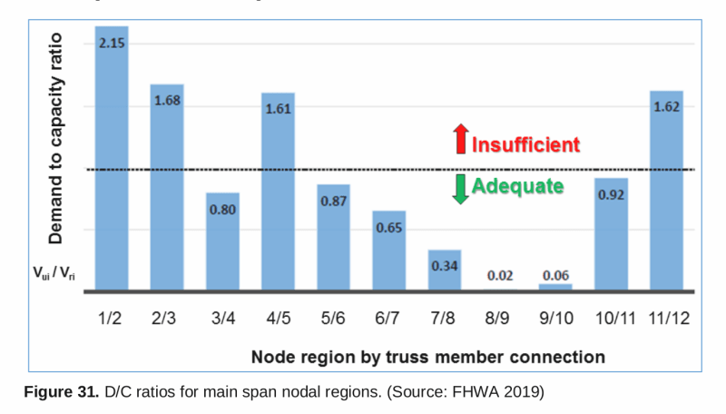

NTSB criticised the design for the load and capacity calculation errors. This is equivalent to say the capacity of the node should have been downgraded due to the imperfection of rebar installation (caused by PT rod anchorages, limited concrete dimensions, large amount of embedded pipe sleeves and drain pipe at critical locations creating stress concentrations and load path interruptions).

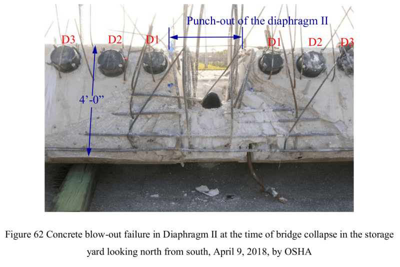

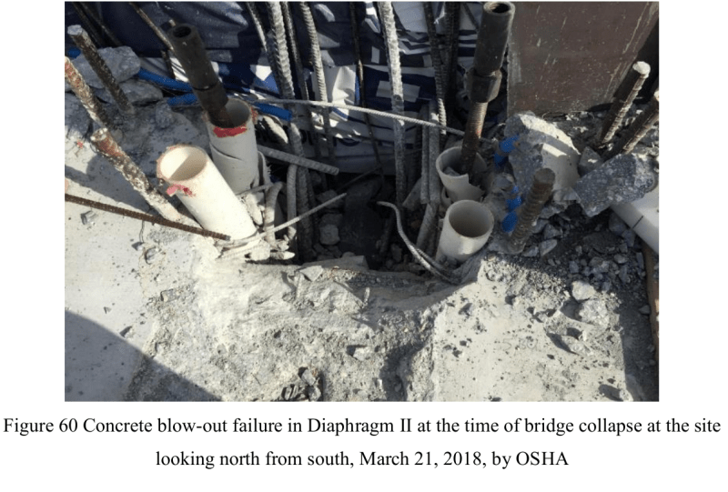

The 4 vertical sleeves were in good condition after the bridge broke away. Could the plastic stronger than the reinforced concrete? These sleeves formed a weak spot for Member 11/12 to leave the deck "cleanly".

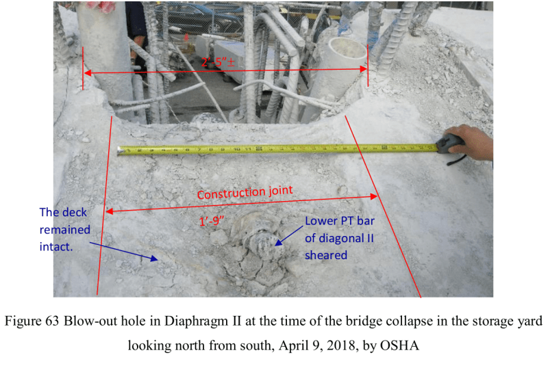

All the reinforcement across the CJ had sheared off properly although only a few cross sections could be seen or made out from Fig 63.
Looking at the above OSHA drawings, showing a massive amount of rebar unable to be gripped soundly by the concrete, it is a waste of time to go the extreme length to prove the concrete adhersion at the CJ if constrcuted perfectly could have made a difference.
Any engineer investigating the 11/12 connection with the deck needs to appreciate the installation of 4 No. of 4" vertical plastic pipe sleeves and one 8" PVC drain pipe have severely compromised the integrity of the rebar in the vicinity by depriving the full development of the concrete bond with the steel bars. In another word there is no use in having sufficient rebar development lengths when there isn't sufficient concrete surrounding the steel bar!

A construction joint with concrete poured at different times, resulting unavoidably slightly different shrinkages and creeps, is always a plane of weakness no matter how perfect the construction.
The Fig 63 by OSHA I posted last time in fact shows the performance of the CJ rather well. To any experienced RC professional the construction result looks normal, acceptable, average, no particular bad or good. The shear surafce is quite rough, irregular and deep at places because a significant amount first stage concret had been forcibly removed substantiating a significant amount of successful integration, bond or adhesion with the second stage concrete.

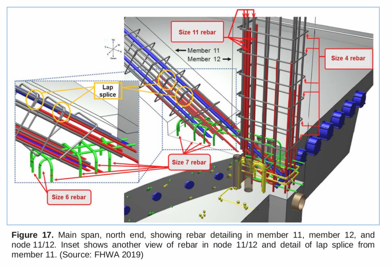

There were altogether 10 vertical bars (2x4x7S01, 2x6S07, see drawing B61) plus 50% of the axial rebar from Member 11 (2x4x7S11+2x7S03, see drawing B40) and one PT rod sheared off cleanly at this CJ.
The failure of the connection is actually due to what happens the beyond the CJ to the rear end of Member 12 where the majority of the rebar from Member 12 was exposed and had no bonding concrete. With the exception of a few small diameter bars severed, like the 4S01 in the deck from both directions, nearly all the other bars, 1x11S03, 2x3x7S01, 2x9S01,2x9S02, 2x2x8S07 from drawing B47, had the concrete stripped off revealing the bare steel. This is not the result of a good design when half the structural components didn't get stressed, let alone failed.
Pinning the hope in the soundness of the CJ won't hold any water because NTSB has already shown 11/12 has been massively underdesigned. NTSB would have by default assumed the Member 11/12 node constructed soundly without defect in ordedr to carry out the analysis.

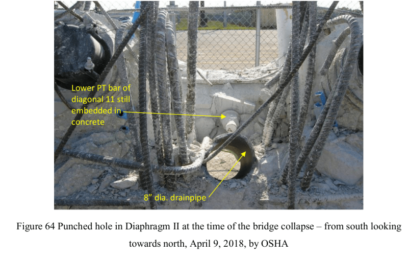

No PT bars were sheared at the construction joint, at least not until the portion of the deck was cut loose for examination.
Of all the errors, and there seem to be many, the worst was probably the decision to keep the road open during the "repair" efforts.
3DDave (Aerospace)3 Jun 20 01:05 SAYS:
"No PT bars were sheared at the construction joint, at least not until the portion of the deck was cut loose for examination."
That is correct 3DDave. That's because the PT bars were not connected to any other bars. They simply ended in 'space' embedded in concrete. Thus, they moved intact, together with the concrete surrounding them.
The lower bar lower attachment moved with the deck; the lower bar upper attachment moved with the canopy; between the two it tore the lower 1/3 of member 11 off and sliced through the reinforcing cage within 11. The concrete around the lower PT bar in 11 did not remain intact.
