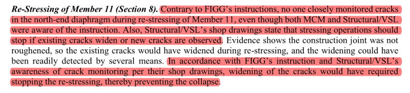

I am one of those who stopped reading the thread after a while when no new information came in and picked it up again so I wasn't aware of WJE's work. I wonder if it is me only having a problem to understand WJE's logic.
The cut and paste WJE's defense suggests :-
(1) WJE had accused no one monitored the cracks. This lets FIGG down.
(2) Structural/VSL own drawings mandated restressing operation to stop if existing cracks widen or new cracks observed.
(3) Evidence showed CJ was not roughened. This could cause existing cracks to widened when restressed and Structural/VSL would have several opportunities to observe.
(4) Structural/VSL could stop the operation if existing cracks widened and collapse could have been avoided.
By (1) I assume no one made any record/note of the cracks, no photo and no video. This also means nobody knew if existing cracks had narrowed or widened or any new cracks developed during the restressing. By (3) WJE now tells everybody the CJ was not roughened and the existing cracks could only widen and not close if restressed.
Since there was no crack monitoring, any restress would widen the cracks and the agreement was to halt restress if cracks widen so what was the purpose instructing VSL to restress? Was FIGG intentionally getting VSL into a trap knowing VSL was unlikely to carry out monitoring so it would not know the cracks widening and continue to destroy the bridge?
SInce there was no crack monitoring during restressing so no new crack information was available. WJE's evidence that the CJ wasn't roughened must be the same information that every contractural party had before VSL did the restressing. What was the evidence convinced FIGG/WJE that the CJ was not roughened and a restress would only widen the existing cracks? Why such information wasn't communicated to the contratual parties to stop the restressing?

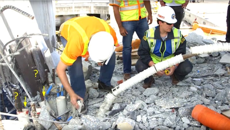

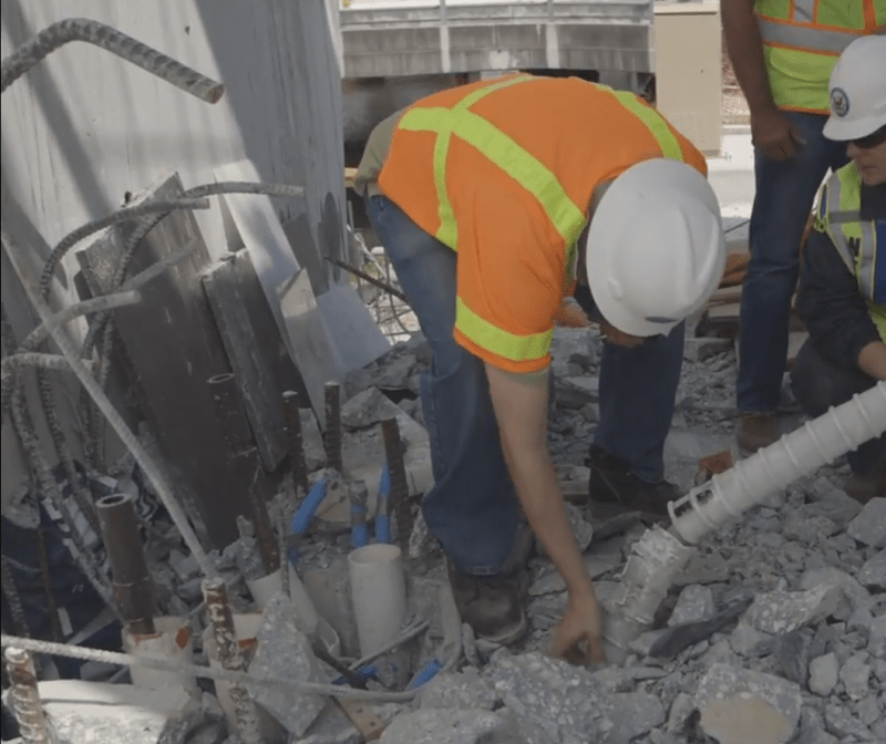

3DDave (Aerospace)3 Jun 20 01:05 SAYS:
"No PT bars were sheared at the construction joint, at least not until the portion of the deck was cut loose for examination."
Hi 3DDave. What is the inference that we can draw from this fact?
Many thanks for your helpful input.
40 - if you mean that the embedded end of the bar was still in place - no kidding.
It's because you left out the qualifier - PT NUT remained in place. Sorry that you mistyped that, and depended on what you believed you had typed instead of what was actually put into words.
The bar did not remain embedded in concrete.
Here's what I think you heard in your head when typing:
"They simply ended in 'space' embedded in concrete. Thus, they the embedded ends of the PT bars moved intact, together with the concrete surrounding them."
In fact the entire upper bar remained in place and only the one end of the lower bar was embedded in concrete. The tension nut was not ever embedded.
Sorry if I have misled others on the lower PT rod sheared off at the CJ as I quoted off directly from OSHA Fig 63. 3DDave is correct. The lower PT rod was firmly attached to the deck during and after the collapse. The embedded anchor plate is clearly shown in OSHA Fig 64 to 70 inclusively although I only depicted Fig 63 in my earlier 2 Jun 20 01:24 post.
Here was the scene at the CJ showing the exposed PT rod and how it rip out from the Member 11, severed the links on it way out while the links cut the protecting plastic conduit of the PT rod. The breaking up of the lower section of Member 11, multiple cuts of the conduit and severance of the shear links were only possible if the lower PT rod was intact and firmly anchored during the collapse. Thus OSHA Fig 63 without the presence of the lower PT rod at the CJ must be the result of the post-colapse cutting by the workmen.
Initially I was intrigued by multiple cuts of the plastic conduit. Only after looking at how the PT rod left Member 11 could I put the two together and realised the cuts were done by the shear links.
I think this is part of the general defense -Look at this shonky contractor! Not even monitoring the cracks! No wonder the bridge fell down!

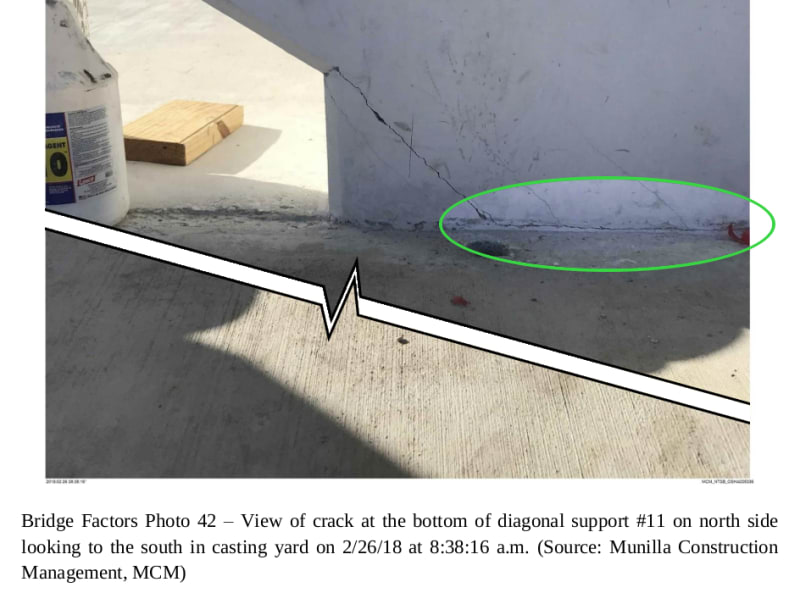

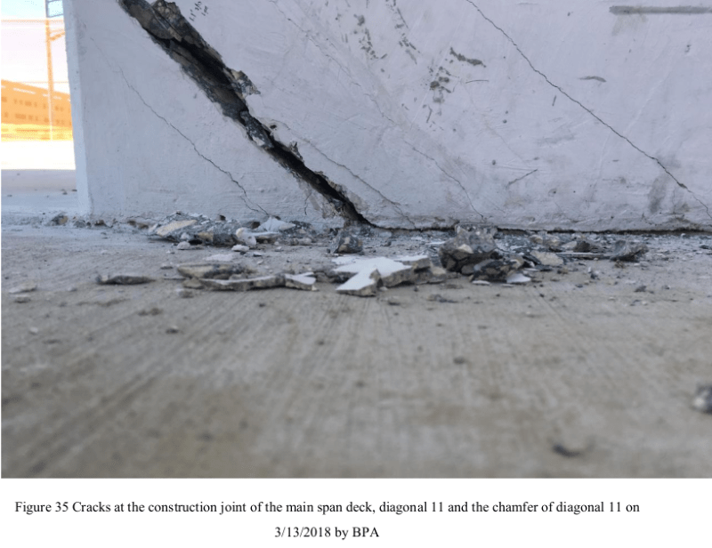

saikee119 (Structural) 1 Jun 20 19:18 said:
According to OSHA report 11 has no structural crack at the CJ prior to the bridge removal from the casting yard.
Don't believe everything you read.
Sym P. le (Mechanical)

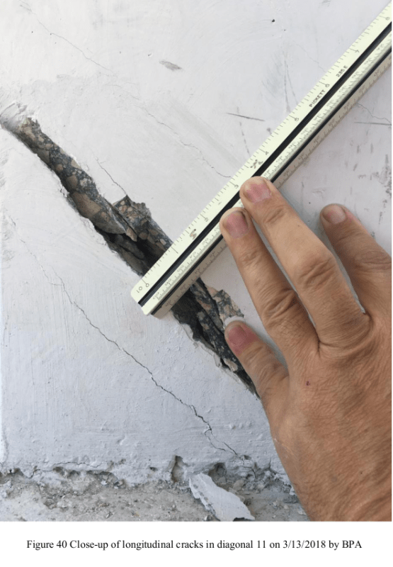

A structural guy working with reinforced concrete may see cracks differently from a mechanical guy.
When an engineer declares structural cracks the remedial work will have to be structural repair able to restore the original structural integrity of the structure, Otherwise the repair is just cosmetic.
Your Fig 42 is the same as OSHA Fig 18 which came from a group of photo Fig. 17 to 20 inclusively from the OSHA report depicting the general condition around the CJ.
When the bridge bottpm was fully supported in the casting yard the application of PT rod stress in Member 11 would shortened the disgonal member slightly as both concrete and rebar have elastic modulus. The cracking in your Fig 42 is a consequence of it. At that condition the bridge structural integrity had not been compromised. That would be my view from a retired engineer who designed, accepted , rejected, modified, strengthened and repaired reinforced concrete structures. Legally say at a court of law the reciver of this bridge at that condition would not be able to reject the work but may be able to demand sealing of the cracks say using epoxy resin injection.
The "structural" cracks I was talking about can be seen in OSHA Fig 32 to 38 inclusively. OSHA Fig 35 is a direct comparison of your Fig 42 but after the bridge had been placed in its final position and the PT rod stresses in 11 removed. As the CJ at that time shown a complete separation and a visible 11/12 bodily displacement of about 1/2" (OSHA Fig 40) relative to the deck. At this point the bridge could be considered damaged structurally and would no longer be servieable. Additionally the 4" crack depth in the deck showed by OSHA Fig. 30 and the 7" crack depth in diagonal 11 in OSHA Fig. 39 confirmed the bridge was beyond repair and must be partially demonlished, re-constructed, modified and strengthened if it were to be serviceable again.
Any engineer who has worked with reinforced concrete for say 20 years would know the bridge was gone just looking at the OSHA photos mentioned above.

I disagree with saikee19 on that crack. In my opinion, the structure had failed at that point. And rather than shortening of member 11 because of applied force, the crack was due to shortening of the deck due to drying shrinkage and PT.
I had a look back at some of the earlier posts and this slip point was noted pretty early on.

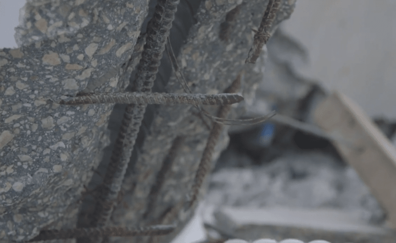

The key issue which I can't find is any pictures of what was sticking out of the deck slab before the pour of the no 11 column. But from the picture above at 00.35 3rd June the only thing seemingly holding this joint together is that weedy looking green cage. Mention before has been made that they have no where near the amount of steel you need for the forces on member 11 and in fact it was only the PT rods which were really holding it together. Loosen them as they did and it literally fell apart and couldn't be recovered.
As soon as you got significant movement on that joint surely these bars would have sheared off?
The really criminal part for me was the action of tightening them up without really understanding what was happening / could happen.
This was the real straw which broke the bridge, but it may well have collapsed a bit later anyway.

I shall explain the crack not structural in Sym P. le (Mechanical) 4 Jun 20 22:36 Fig. 42 which is depicted again below for quick reference. The bridge was still in the casting yard and after PT rod stresses applied.
The same crack changed in nature and severity after the bridge had been installed at its final position and on completion of the release of the PT rod stresses in Member 11.
That crack width was measured suggesting the one side had separated from the other side by approximately 1/2". I ignored the >1" width at the surface as it is the crack's interior that should be of interest to us.

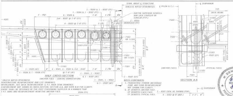

If one looks at the design drawing B47, especially Section AA, one may be able to pick up information why the same crack changed by so much.
If PT rod tensions were applied while the bridge was in the casting yard the Member 11 would be axially compressed. The compression would also squeeze the deck axially because the PT rods anchors wanted to move from left to right. The deck was not taking load at that time.
When the bridge was placed at its final position the deck would be forced to take its design dead load and the member 11 would have one of the highest compressions in the structure. Member 11 could only develop the expected high compression if the deck provided the necessary reaction from which the deck must be stretched to develop tension to partly neutralise the previous compression from the PT rod stresses. By releasing PT rod stresses Member 11 anchores were no longer compressing the deck but wanted to deflected in the direction exactly opposite to what was before.
Thus in the MCM Fig. 42 the Member 11 was compressing the deck inward while in OSHA Fig 35 the Member 11 was stretching the deck outward. It should be obvious that the deck has a much greater scope in resisting Member 11 in compression, by buckling, than by tension of letting Member 11 to depart from the end connection. Thus the same crack in MCM Fig 42 and OSHA Fig 35 are different in nature. I for one would not lose sleep for minor concrete cracks permanently compression zone.
What stopping Member 11 moving outward and way from the end of the structure was its strcutual connection with the deck. Looking at Section AA many structural engineers would drop their jaws because there were no serious restraint availabe to prevent the whole thing from sliding out along top of the 8" drain pipe!

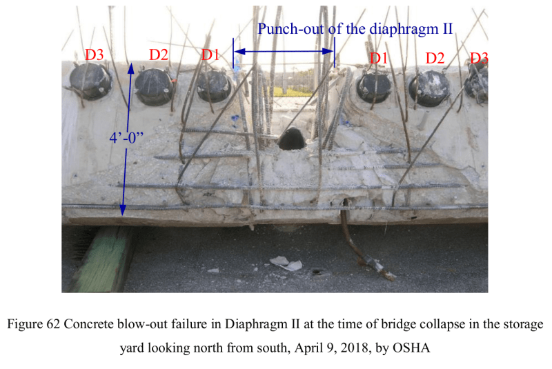

If we look at the rebar provision in drawing B47 there were some hefty 8S01, 8S02, 8S03 and 8S04 (1" diameter) at the rear of the deck but due to the physical obstruction of the 8" drain 8S03 and 8S04 were discontinued at the middle and turned 90 degree to avoid the drain pipe. OSHA Fig 62 shows all 8S01 to 8S04 inclusively intact after the failure but one side of 8S04 seems to have cast in the wrong position. The 8S01 is the lowest horizontal bar in OSHA Fig.62 below, then upward it is 8S02, 8S03 and 8S04. 8S03 was seen embedded between 8S01 and 8S02 on the right side. 8S01 to 8S04 were exposed after the surface layer of the concrete came off with 11/12. My point is had similar size horizonatal rebar were able to place above the 8" drain pipe the chance of a failure could have been significantly reduced.
Design drawing B47 Section AA alone can tell us why and how the bridge failed.
In horizontal direction the only reinforcement to stop 11/12 from sliding out of the deck were just two 4S01 (1/2" diameter). One snapped at the middle and evident in OSHA Fig 63 I post previously. In the vertical direction the designer did provide a modest amout of large diameter rebar but their effectiveness was severely compromised by the presence of the 4 No. of 4" vertical sleeves and the 8" drain which destroyed bondable sections of the reinforcement. In other word even if adequate development lengths had been provided in the vertival steel some sections of the concrete were weakened, too slender and were unable to distribute the full material stress. OSHA Fig 61 to 71 inclusively confirmed none of the vertical reinforcement had failed. They were just stripped off the concrete after failure.
