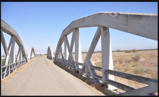

There are other concrete trusses (although they are rare) and they sometimes make sense. It is just that they have to be designed properly. Any material used can fail.
Hokie66 concluded that - "The design was fatally flawed, and hopefully will result in concrete trusses never seeing the light of day again."
Hokie, I believe the correct conclusion would be that, "concrete trusses with fatal flaws should never see the light of day again." Concrete trusses have been used endlessly in civil structures, and will continue to be so used.
I agree with Hokie66 that it’s the same crack. It simply opened further when it experienced serious loads. I don’t understand the distinction between 11 pushing and the deck pulling either. They’re one and the same.
I agree with saikee too that most of us dismiss cracks of that magnitude as “non structural”. I wouldn’t be prepared to condemn an engineer for dismissing initial cracking of that magnitude. We have the benefit of hindsight. They didn’t.
FortyYearsExperience,
There have been a few, but "endlessly" is stretching it. I have never seen one in person, and have more than forty years experience.

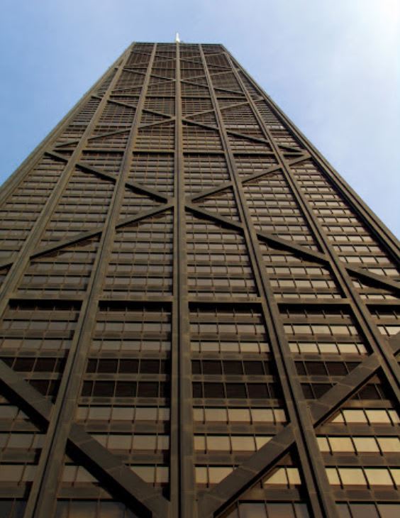

hokie66, I walk past this building every day. Ever been to Chicago? These concrete trusses can be found in just about every modern city. Sometimes they are concealed within the outer cladding of the building. Concrete trusses are well understood, and endlessly used.
Poor example. Those are structural steel.
And no, no matter how many examples you find on the internet, I haven't seen any of them.

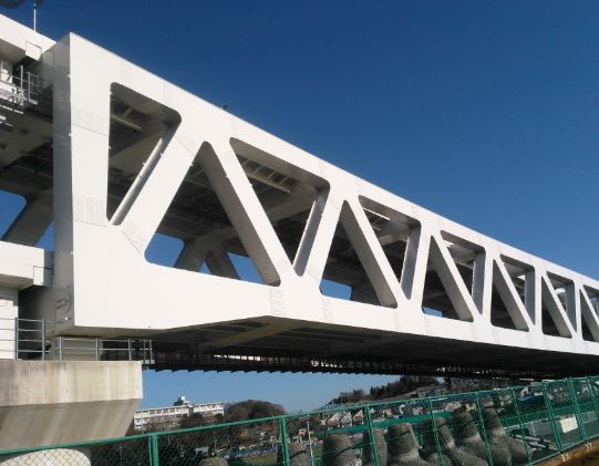

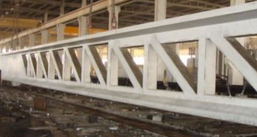

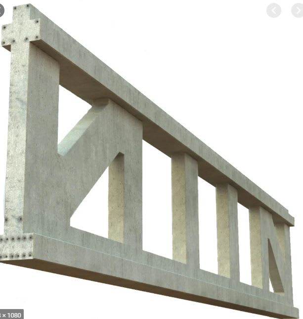

With the exception of the picture at the bottom left, which may or may not be a component in an intended bridge, I think the others are steel. But if you can provide some documentation otherwise, I am interested. Early on in these discussion of the Miami footbridge, I did some googling as you have done, and didn't find much. There was one example of a concrete truss bridge in Europe, maybe Germany, and it was very bulky in appearance.
The miami bridge was a concrete truss in the middle of two decks complete with a mismash and total mess of tubes, PT rods and a construction system which had cold joints all over the place. I'm sure those trusses, if they are actually concrete trusses, were made in a formwork laid on its side to avoid cold joints.
A pure concrete truss with decks resting on it may have been much better. It is likely the end re bar would have been tied back into the lower flange with something more than the equivalent of chicken wire or with PT rods running the full length of the truss properly capturing the forces from the lateral member.
It's not the truss per se which was at fault here, but the way the whole bottom deck, top canopy and intermediate asymmetrical struts were put together complete with all sorts of weak points. Member 11 just didn't have enough reinforcement to attach it to the bottom deck and blew out. Poor design.
LittleInch nailed it, especially his remarks about building concrete trusses on their sides.
A truss needs three things: compression, tension, and joints. Concrete is great in compression, useless in tension so requiring reinforcement, and tedious at best in joint design.
This was not just a truss, it was a truss/frame where the frame action was not addressed, and it had dissimilar chords without a rational way of getting the forces transferred between chords and webs. Differential volume change due to the construction sequence was the initiator of cracking. Altogether, an abject failure in design concept as well as execution. In addition, as a novel concept, it should have been tested. They had ample opportunity while it was still on the ground to load test it, probably using water bladders or sand bags as the test load.

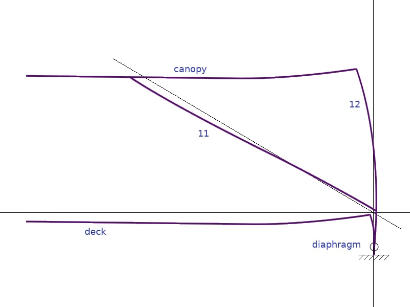

Consider the following diagrams:

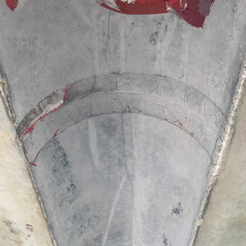

Also, the deck sag is greater along the center longitudinal axis than along the deck perimeter as is evidenced by the longitudinal crack along the deck underside in the drain cut-out.
Bridge Factors Photo 71 – View of crack in cut-out for drain pipe under deck on 3/12/18 at 10:20
a.m. (Source: Munilla Construction Management, MCM)

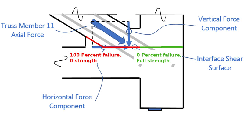

To me Member 12 wasn't an impenetrable fortress against the translation shear against Member 11. In fact it was almost like a lump of concrete attached to Member 11 that can be moved bodily with 11. That was the heart of the whole problem. If we temporarily ignore the contribution from the joint then structurally the only resistance of 12 against 11's horizontal shear is by bending its connection at its top with the canopy. Since 12 is about 18' high and the canopy is only 1' thick the rotational resistance at the canopy connection would be small even when there is a large displacement at the bottom of 12.

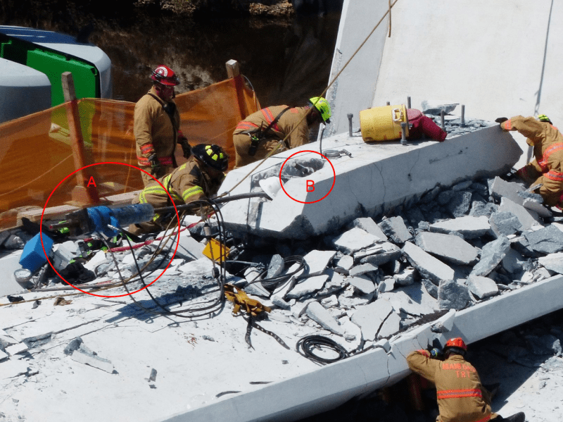

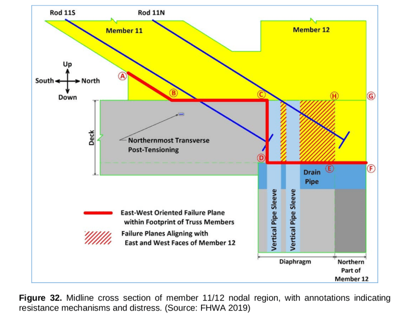

Your indication of the CJ sheared off along a horizontal plane, part red and part green, in your last sketch is not the path of the least resistance. The OSHA Fig. 58 to 70 inclusively show the shearing path was stepped. There was no concrete left on top of the 8" drain pipe in every one of the OSHA Figures. This substantiated after the CJ the failure plane had changed level to the top of the drain. The NTSB's version of the failure path is depicted by its Fig. 32 which is enclosed below.
In a way it was the combination of the 4 No. of 4" pipe sleeves and one 8" drain pipe that broke the back of the camel. These embedded items apart from disallowing the necessary rebar to be placed, especially in the horizontal direction where it was needed most, they created a weak pocket for 11/12 to slide out once the reinforcement in the A-B-C part of the CJ had sheared off.
In NTSB Fig. 32 the part C-D would be in tension and in design offered zero resistance from concrete. If you scrape the barrel the concrete tensile resistance is around 0.5 to 2 N/mm2 which is insignificant. I believe there were only 4 No. #4 bars, availoable to resist tension, from the deck longitudinal reinforcement which again not much a fight against the huge shearing force from the Member 11.
The last defence against the shearing from diagonal 11 is the shearing capacity along part D-E-F plus the two vertical shearing faces indicated by hatched areas C-D-E-H-C, on each side of Member 12. Unfortunately the end of the deck has 12 No. of end anachors from the longitutinal strand tendons. They prevented any substantial rebar to be inserted into the hatched areas but the drawing B47 did show a couple of #4 bar. Part D-E-F has a decent amount of Vertical reinfrecment available to withstand the horozontal shear but unfortnately none of them failed in shear but by bonding accaording to the OSHA figures.

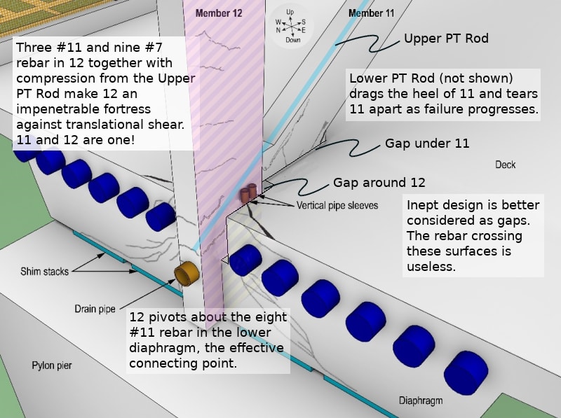

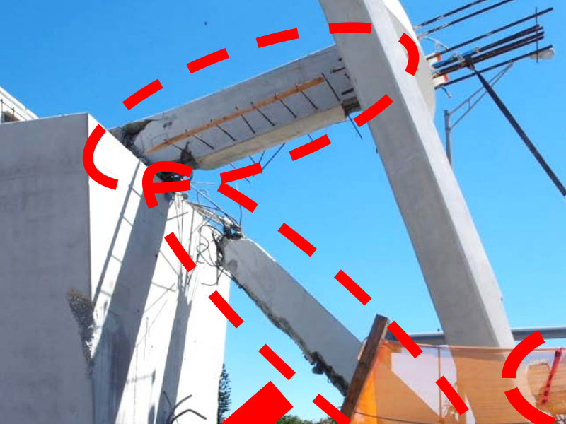

saikee, Thank-you again for your comments. I believe you have given an excellent summary of the issues encumbering the 11/12/"deck" node though you have understated the issue of the blue electrical conduit on either side of 12. These conduit are equivalent to an additional pipe sleeve on each side of 12. As such, I have considered these surfaces as contributing "zero" to the strength of the structure. As most agree, this node is the fundamental flaw in the structure.
In my stick diagram above, I attempted to show relative movements in the nodal region and also proposed an offset displacement of 11. My reasoning for this is that as 12 bows, the base of 11 tips upward, and as the bridge sags, the top of 11 tips downward. My depiction of the movement of the top of 12 and both the canopy and deck deflection is greatly exaggerated. A one inch relative motion between the deck and 11 would not result in the same movement elsewhere in the structure, rather, significantly less.
It seems to me that 11 is ill equipped to support the loads imposed on it both in its intended role and far less in its effective role. There is no question that the base of 11 is being torn apart. I suggest the following image, the significance of which has been overlooked, reveals that the failure of 11 was the "next step" in the collapse. The upper PT Rod has yielded at the failure point in 11 which indicates that its base was still firmly positioned in 12 as 11 sheared. The failure cascaded from that point as 11 pancaked while being guided along the lower PT Rod. Note that the lower PT Rod was free to extend out of the blister cap while the upper PT Rod was not.
