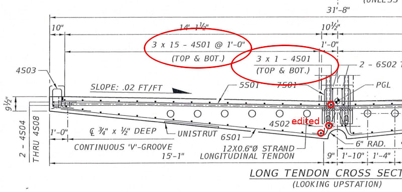

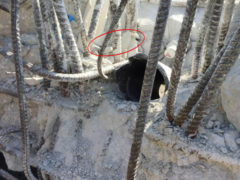

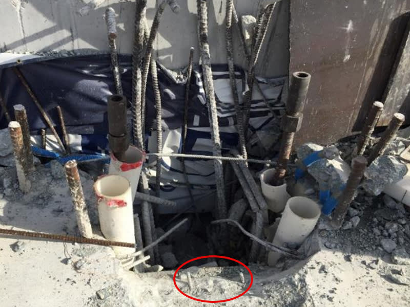

Does anyone have any thoughts or ideas as to why this rebar was stubbed short of column 12 (presumably column 1 as well)? Does the rest of slab rebar stop short of the diaphragm as well? What does 3 x 15 refer to in the end view dwg.? I'm not a structural type so I'm just asking.
edit: end view markup edited to be consistent with rebar indicated on OSHA figures.
No idea of why the short rebar but maybe I can help on the 3 X 15 bars.
The bars are available in 60 foot lengths. The "3 x " indicates 3 sets required to make the deck length of 174 feet. Top & bottom left & right is 4 locations of 15 bars each, making 60 bars X 3 sets to make the length = 180 bars. The single bar top and bottom each side at center = 4 bars X 3 sets is another 12 bars required. 180 plus 12 = 192 bars as noted in the table. Extra lengths are used in laps. I have not decoded the "B", "C" dimensions - they usually are leg lengths of bent bars so there is probably a code somewhere designating which legs are noted.
I do not see a note or a reason for holding any of this reinforcing short of the end - 3" clear of the formed end, of course.

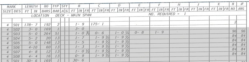

FDOT STANDARD BAR BENDING DETAILS.
Non standard bends are shown on FIGG drawings.
The FDOT details show leg designations, etc.
EDIT ADD:

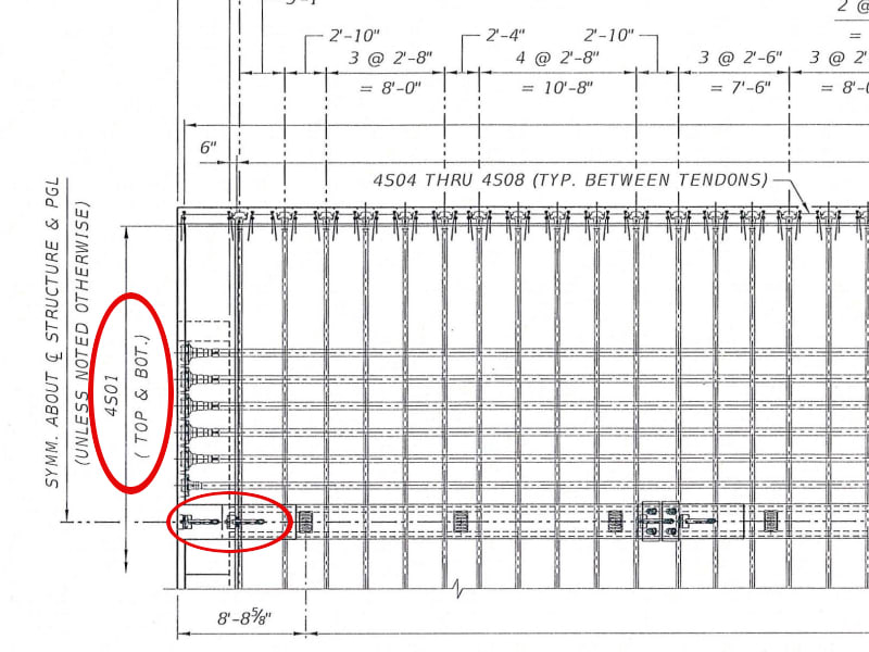

Bars 4501 were intended to be TYPE 2 =straight with laps of 1'-9" and total length of 175'- 1". That is 1'- 1" longer than the deck.
That means with maybe starting layout at 8" from south end (larger diaphragm) the bars could extend 1'-9" at the north end for a lap to the back span.
The bars 4501 near the center of the deck may have been held back to reduce congestion in the base area if member 12.
