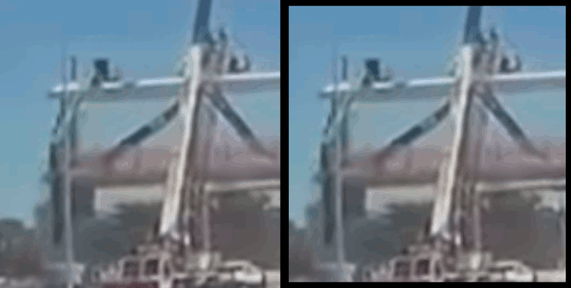

I find interpreting frames of the dashcam video difficult due to the changing angle between the cam and the north end of the bridge. Given that, I tried to measure the apparent end of 12 to the north of the pier in frame 80. The distance from the apparent end of 12 to the bottom of the north end of the canopy appears to be 16% bigger than the original length of 12. Are we seeing a chunk of 12, 11, and/or deck fall off the pier? It seems to be gone in the next frame.

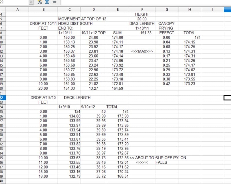

I did a spreadsheet of dimensions from the bearing at 1 to 10/11(canopy) , then from 10/11 to top of 12, and one of deck dimensions with segments 1 to 9/10 and from 9/10 to the end at the pylon. It calculates the total length as each point (10/11 and 9/10) drop in increments of one foot. It could supplement your cutouts.
I started re-learning a CAD program I was once very familiar with, and also working out a table of dimensions, but gave up because other things in my life have a higher priority. CAD (cardboard-assisted design) seems to be very popular with the YouTube kids nowadays (see Project Binky and Acorns to Arabella for example) so it was kind of an obvious choice for me.

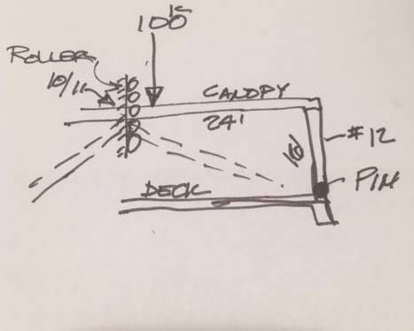

When did 12 depart its perch on the deck?
I would like to see comments by all as to amount of damage visible to the north section of the canopy at member 12 and damage to the remaining upper section of member 12. Perhaps good zoomed images - I cannot find severe cracking of the canopy or member 12 at the joint with the canopy.
The canopy is a pretty stiff element. I am guessing maybe 1.5 to 2.5 times a flat section. If anyone has AutoCad and can draw it I think AC can return the section properties - I, S, A, CG, etc. Did a bit of math on a 16 foot segment of a 24.5 ft radius 12” thick, ignoring the oblique orientation of the 1' X 1' segments I think the NA is about 24.153 ft above the Layout Pt, or 0.153 above the bottom of the canopy at the center. Rough “I” is 30616 in^4. Add something for the oblique issue and use maybe 32000 in^4.
The column is easy. 21X34^3/12=68782 in^4. We can use those values later.
Some discussion now. If everything remains connected successfully, members 11 and 12 and the canopy form a stable and well braced system, and 11 protects the joint of 12 to the canopy. But what if 11 loses its grip at either end? Or fails somewhere along its length?
Lets explore conditions when 10/11 drops 3 feet and take member 11 out of the picture. How much stress or deformation can the canopy at 12 and 12 at the top withstand?
When node 10/11 drops 3 feet there are three possibilities with regard to joint canopy/12.
1. No damage visible - the joint remained basically at 90 degrees, and its base departed the top of the deck and moved 2 feet north. 16'/24' X 3' = 2 feet.
2. Complete failure of joint canopy/12, - bottom of 12 could have remained in position on deck. I do not see this as the result when looking at joint canopy/12.
3. Something in between - then some damage would be visible. How much?
To find the possible load conditions at the joint of 12 to the canopy, the canopy is isolated at 10/11 and member 12 is pinned at the base at the top of the deck. The pin simplifies the analysis and allows rotation but prevents lateral movement to the north, simulating a condition in which 12 remained connected to the deck. The canopy is isolated at 10/11 and allowed to move vertically without moving to the south. This is not an acual condition but it allows the approximation of moment capacities and stresses in the relatively undamaged joint of the column 12 to the canopy.
So lets load this 2 member bent with 100 kips at the free end at 10/11. The deflection is about: Delta=PL^2(L+C)/(3EI). L+C is about 24+5 (5 being the equivalent length of canopy section to be same stiffness as the 16 foot column ).
Defl=100K*24^2*29*1728/(3*6x10^6*32000) = 5.01 inches. Pretty stiff.
The moment in the deck and column top is 100K*24'=2400 ft-kips.
Canopy stress is 2400*12*(10.156)/32000=8.14 ksi. That is about failure, but we have not included reinforcing.
Column stress is 2400 'K*12*34”/2/68782=7.11 ksi. The column could survive this moment.
But that is at a deflection of only 5 inches.
If joint 10/11 dropped 3 feet, the stresses on the canopy and column would be much greater. Like 35”/5”=7 times greater. Or in the order of 56 ksi in the canopy and 49 ksi in the column. That is failure levels, and did not happen. We can tell that by observing the canopy and column area of the collapsed structure.
So the column could not have been on top of the deck when joint 10/11 dropped 3 feet. From the dimension results, reading 3 feet drop in joint 9/10, the deck has moved south only 0.15 feet or about 2 inches.
These results are linear, assuming everything remains elastic. So even at the point when 10/11 dropped one foot, the results are 2.4 times the 5” result and stresses, making failure of the canopy/12 joint a certainty - if 12 remained atop the deck.
I suggest 11 and 12 departed the deck as the initial event of this collapse. It must have decoupled from the deck before joint 10/11 dropped a foot or so.
Note - I hope I got the numbers right - I welcome peer review.
EDIT ADD: One more possibility - if member 11 failed by bursting or because of the splits captured in the photos, thereby allowing joint 10/11 to drop 5", the above calc shows the canopy and member 12 could have delivered about 150 kips northbound to the 11/12/deck joint. That additional 150 kips may have triggered or hastened the blow out and collapse. And the retensioning of the PT rods in 11 may have further damaged 11 to the point of failure.

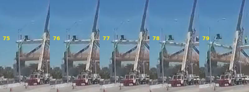

I've tried to view this collapse incrementally, i.e. three foot increments are too large, even when you back it up to one foot, it is too large. Nonetheless, you moved in the right direction. I was thinking more along the lines of fractions of inches to envision the implications of any one element having some freedom to move. This is how I came to the awakening that 11/12 already had separation from the slab and was merely leaning against the rebar that was running the width of the diaphragm through 12, among other.
Your numbers however support my earlier theory that as the span sagged, the load on 11 could grow until it was overwhelmed. Also, as 11 pushes 12 northward, it is necessary that 9/10/deck sags and so doing pulls the deck toward the centre of the span, opposite to the movement of 11/12 and also dropping out from beneath 11, tearing it longitudinally. So, in short, 12 didn't have to leave its perch completely, it just had to shift a little bit more w.r.t. the slab.

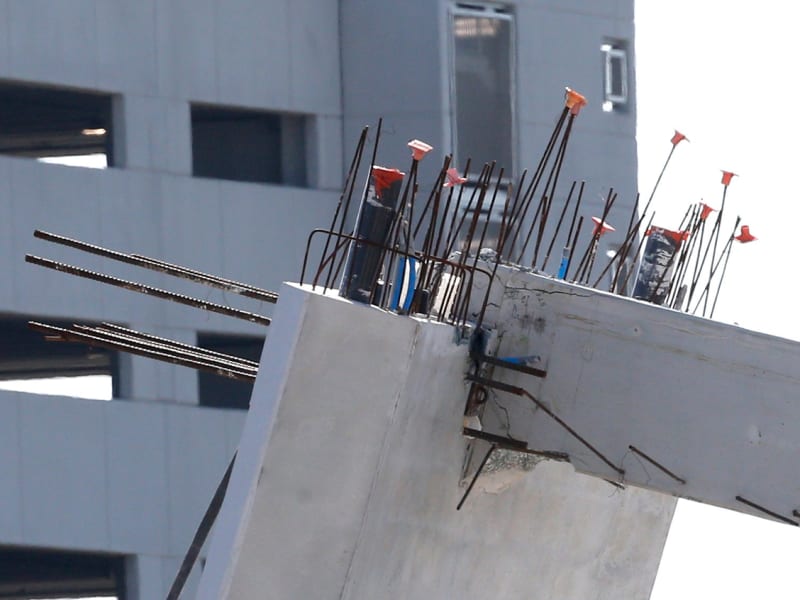

The damage to 12/canopy is best seen in these two images. It's hard to tell whether the damage is from the initial collapse or from the collision with the ground. In the sequence, you can see the vertical rebar leaning south but six of the nine rebar are only associated with the canopy, i.e., if the joint is crimped, the rebar won't align with the column. From my previous gif's, I tend to think that the joint initially crimped.
Frame 76 gives the first indication of the canopy sagging and the vertical rebar is already leaning south. It's hard to tell if 11 starts to pancake because the truck hasn't stopped yet. There is no significant lateral or vertical movement of 12.
By Frame 77, 11 is already pancaking and in Frame 78, 12 drops and moves independently of 11/slab. Thus, my position is that 12 left its perch in 78, though there was a likely event at the 11/12/deck/diaphragm connection at Frame 75. As I indicated earlier, careful inspection of 75 indicates a puff arising from the joint that was not visible in the earlier frame. That really could be the precipitating event.
The "event" could be the rebar finally letting go. But again, I don't see any giant step movements starting the collapse. It seems likely to me that an impulse from a sudden jarring shattered the node and 11 while 12 was yanked down by the canopy. I don't know how else one could conjure up so much clean rebar.

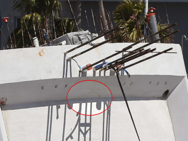

This is the largest image (4278 x 3208) of the 12/canopy. The resolution isn't much better than what has already been posted. I've highlighted the rebar at the base of 12. How much is it 12 rebar & how much is 11?
 https://files.engineering.com/getfile.aspx?folder=533371bf-7722-43ba-a9f5-53f838025f6e&file=ap_18075617518893-fe2c30c3072612c373ae06ae9909fe60d49e985.jpg

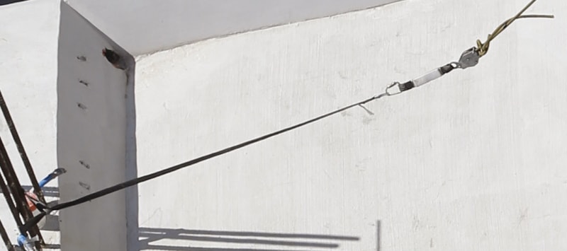

epoxybot (Structural) 24 Jul 19 20:53 - Now I understand why the "falling man" had his safety harness clipped to the crane hook....
Have a gander at the "safety line" these guys were using:
[ul]
[li]A nylon sling cinched around rebar through its own end loop[/li]
[li]A light-weight pulley clipped to the other sling loop[/li]
[li]13mm climbing rope pulled tight through the pulley and tied off with what appears to be a simple slip-knot. (This was at the north end, so I assume the tightening occured there.)[/li]
[/ul]
Crop of expoxybot's image, rotated 90 degrees:
Roughly speaking, all of the rebar you highlighted belongs to 12.

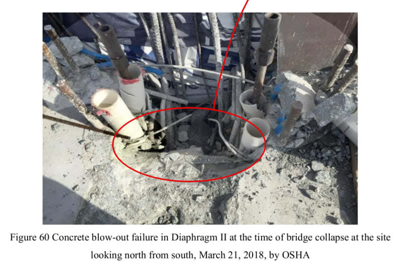

Thank you for the clear close-up photos. The first one shows damage I had not seen before. There it appears the concrete of the lower deck surface is failed, indicating rotation between the canopy and column. The second photo shows cracking in the raised diaphragm at the north end of the canopy, suggesting the beginning of a punch thru failure. I can no longer support the concept that the joint is undamaged and it likely failed to hold the original angle between the canopy and column. After viewing the photos, I do not think the canopy/column joint can resist the 2400 ft-kips presented in my post of yesterday.
I am not sure this fits, unless 11 fails internally and effectively shortens. Because the support of the north end of this trussed structure depends on member 11 successfully supporting its loads and holding node 10/11 in its original position, there should be no "sag" until 11 had failed to support its loads. If 11 failed to support the loads under static conditions, it seems unlikely that member 11 would support greater loads than those that caused its failure. The same can be said of member 10, but to a lesser extent, and the failure was not in 10.
If the cracking of the deck photographed at the base of 11 and 12 on March 13 represent a movement of one inch northward, the corresponding drop in node 10/11 would be 1.5 inches. The change in geometry would not increase the loads on member 11 significantly (approximately 1%). From the calc presented yesterday, and which assumed the joint canopy/12 remained intact, the 1.5 inch drop would be 1.5"/5" X 100kips =30 kips load on the bent comprising the canopy and 12. That is possibly within the capacity of the joint, and could have introduced 45 kips force to the north at the deck joint. That could have been the added load that triggered the collapse.
I agree that there is much to be revealed at very small distortions. I jumped to 3 feet because that would have moved the bottom of 12 two feet north and basically off the deck, introducing a different condition. That is assuming joint canopy/12 remained as cast, of course.

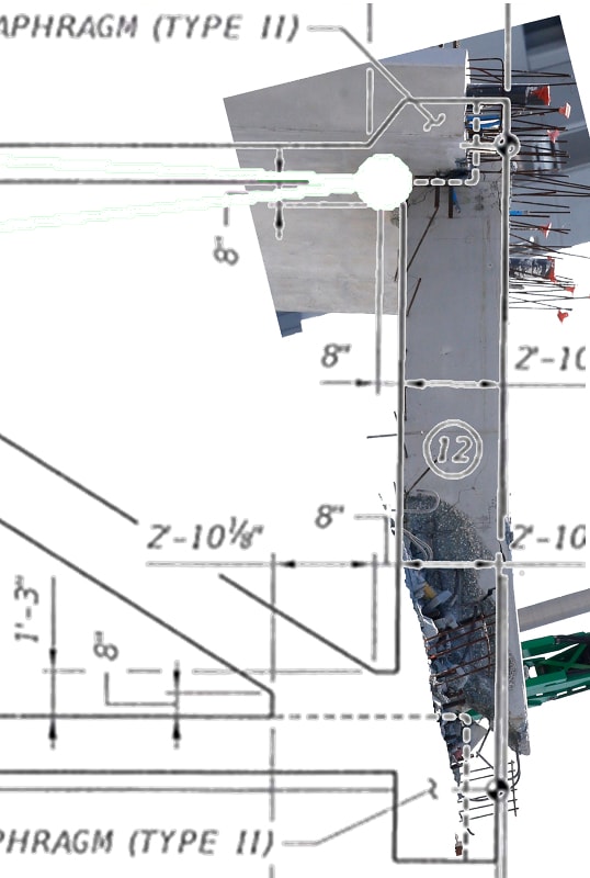

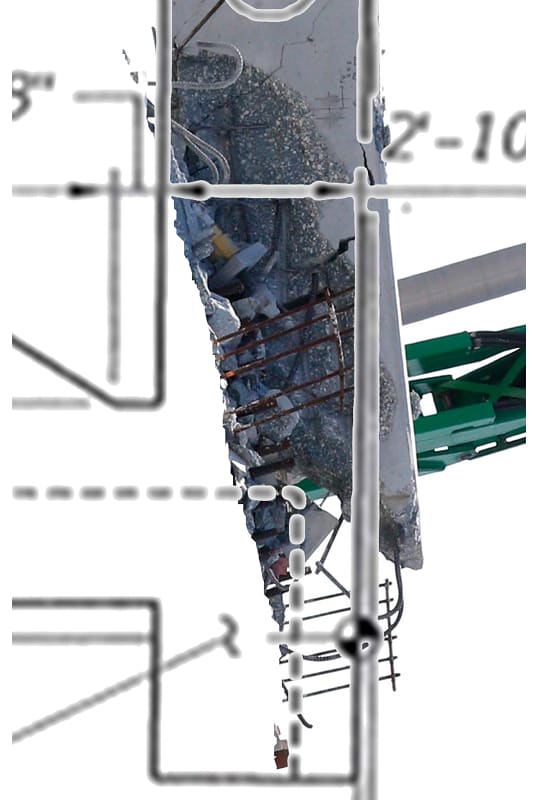

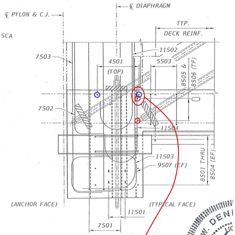

I'll post these for consideration. They are images of the failed 12 rotated with a structural dwg. imposed over it. The scale works well as the discoloration of the concrete on the tab at the base of 12 indicates the deck height. The height from T.O.S. to underside of canopy at the column is approx. 15'. The formwork imperfection seen just above the number 12 would be at eight feet above the slab.
Ignoring the mess at the base is not for the feint of heart but these images give an idea for the location of significant diagonal cracks that occurred in 12.

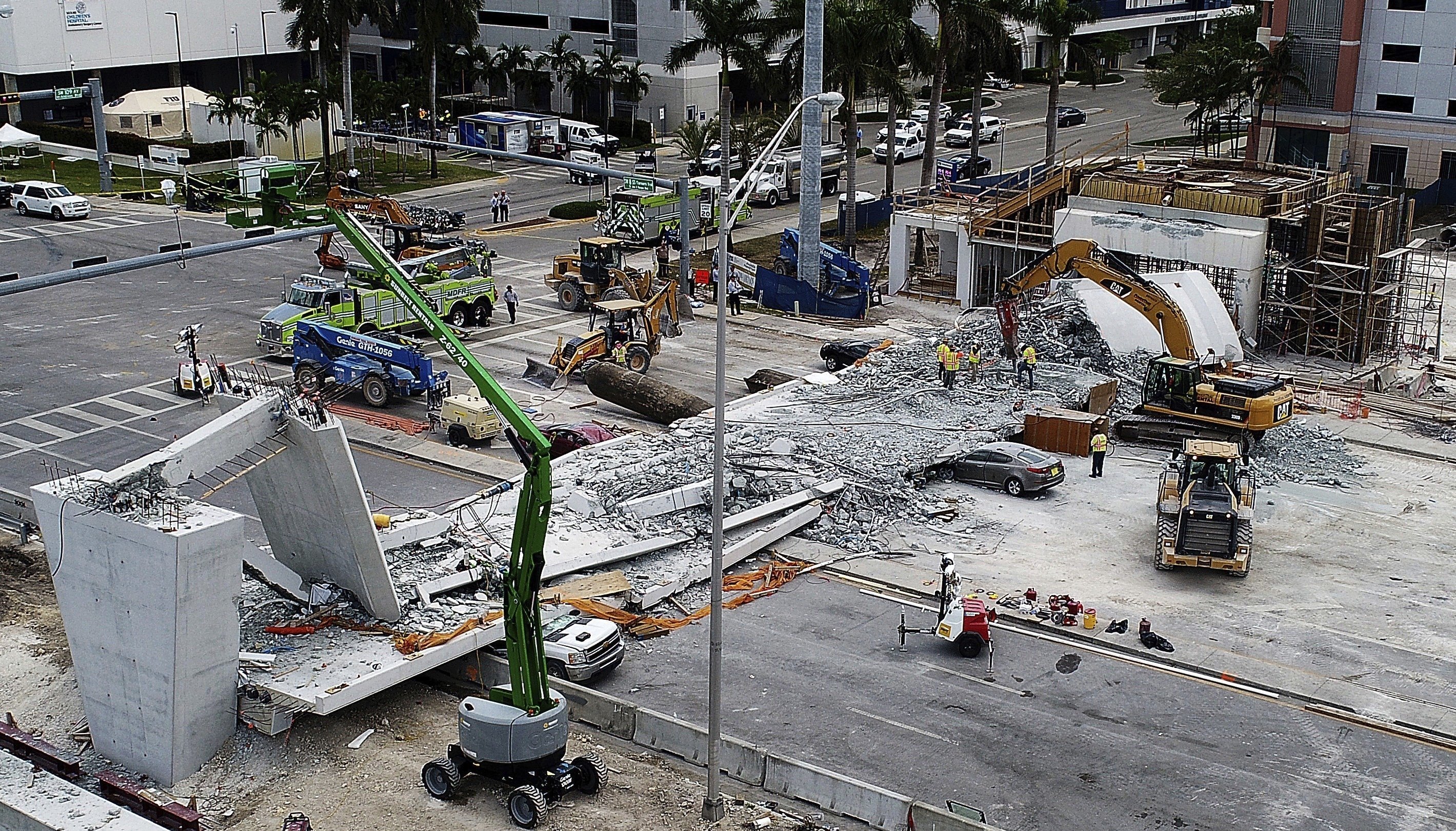

While looking for images taken immediately after the collapse I noted that only 3 people are responsible for most of them:
[ul]
[li]All chopper pictures were by Pedro Portal[/li]
[li]Ground images were taken by Joe Skipper and Wilfredo Lee[/li]
[/ul]
If you're still looking for good pictures, search for those names, images, and restrict the search dates to 3/15/18 to 3/31/18.
I found this shot by Portal that might be new
ADD: In the Portal image, the two short beams at base of the north pier have been there since at least March 1st - they are visible at the very beginning of the N. View timelapse dated Mar 1-19.
