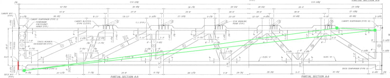

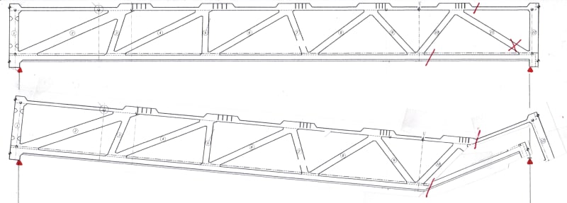

I've been thinking about this reality and roughly calculated that 3.75" needs to be gained on the long side, as per my mark-up below. This could be gained by various distortions or by movement at the bearing points. The south end has a 1.5" expansion joint to the landing and the north end has play around the hold down through the plastic duct. Needless to say, 900 tons does not need my permission to do what 900 tons does.

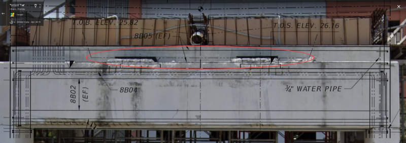

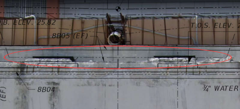

I also wondered if there was evidence of contact by the deck at the south end landing. Google Maps says, "Maybe ..."
I am dense tonight, so I am having trouble following you. And the sketch/drawing is quite light on my monitor, but I see a green line (I think) from lower left to upper right. That seems reversed to me -

Mike showed that the long south end of the span rotating about its base would push the top of 12 north. This has to be factored into the collapse sequence or another explaination provided. Given the 175' of span and 20' of height, I was curious how much distance the sweep would require. I picked three points that seem to be indicated by the videos, the bearing point of the south diaphragm, the upper canopy surface at the 10/11 blister, and the lower canopy surface at the 12/canopy node. I then scaled the two long sides off of the dwg. with the angle between them (easy with GIMP) and calculated the balance. The sum of the two short sides is 3.75" longer than long side.
The hold downs were loosely attached and seem to be sheared. They are visible in various OSHA report photos.
Pushing the top of 12 North a few inches seems immaterial compared to the bottom of 12 being shoved about 10 feet, if the bridge was to stay together that long, before yanking the bottom of 12 back as the canopy heads for the ground. Obviously not all of 11 or 12 made the reverse trip intact.
3DDave said:
... a few inches seems immaterial compared to ...
We didn't have a number so I gave it one. Also until something breaks free, it all has to move together and that makes any number significant. It's neccessary to explain how the bottom of 12 ended up hanging four feet off of the pylon.
I made it a 4-bar linkage, which explains how the bottom of 12 ends up off the pylon. Make the 12-pylon a slider, which is the motion allowed, a pin joint near 9-10, and a pin at 1-deck. The top of 12 cannot move at all until the bottom is already broken; the top is part of a rigid frame.

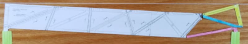

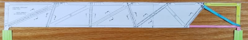

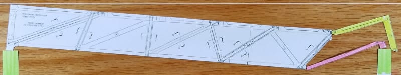

New cut-and-paste mashup. Now in Color!
(Old mashup posted 11 Jul 19 20:46)
[highlight #FCE94F]EDIT ADD: Not a structural guy! I made this diagram to visualize the spatial relationship of the components based on how they seem to appear in videos. I will adjust the captions based on group suggestions.[/highlight]
Apologies for the tilty north pier...

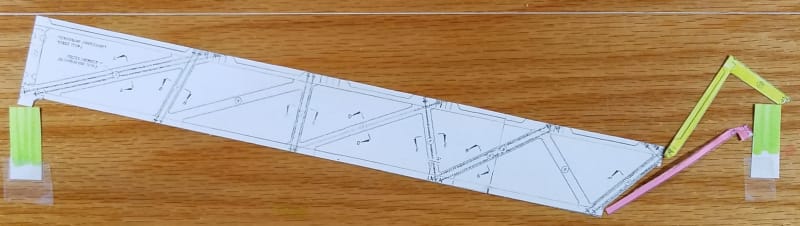

[highlight #FCE94F]ADD: At this point both the canopy and deck have hinged and the 11-12-deck joint has been compromised - the order of occurance is not posited.[/highlight]

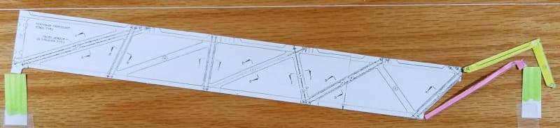

[highlight #FCE94F]EDIT: Next 2 pictures: reworded to change description of picture 2 to an "IF" scenario and moved a "pinch point" reference from pic 3 to pic 2.[/highlight]
IF the base of 11 wasn't immediately destroyed and the canopy-11-12 triangle managed to remain intact for a bit, the bottom end of 11 would have slid over the lip of the north deck and been crushed to rubble in the pinch point between 12 and the deck edge.
With the base of 11 gone, either by it's initial failure or after it was crushed in the pinch point, 12 drops off the deck and onto the pier. Member 11 is removed from this and following pictures.
12 drops behind the pier.
At this point the deck hinge has already impacted the highway and the 1-10 truss is starting to flatten out.
The deck hinge pulls the north deck section off the pier.
The canopy hinge drags 12 back onto the north pier.
