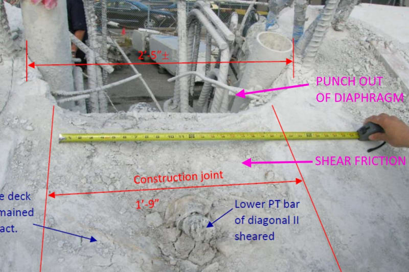

In my view there was failure of the cold joint for the first 100mm or so, and beyond that it's an overall concrete punching failure thru the diaphragm. If the diagram was 3 foot thick not 2 foot thick it couldn't punch out the way it did.
I see what you mean. Although if you solve the interface shear issue, you don't have an issue with the diaphragm thickness. There was a significant increase of the vertical steel through the joint at #12. That helped transfer the loads into the deck just above the diaphragm. I believe that is why the shear plan dips down above the diaphragm. The diaphragm does punch but with proper detailing, the load would be properly distributed to the deck PT before there would be any punching on the diaphragm. I hope that makes sense. It is a bit difficult to explain.
Which interface shear are you referring to?
In my opinion you need to:
A- ensure #11 cant slip across the deck (hence the need to square up the joint)
B- ensure the deck can’t punch out due to the load from #11 (hence idea to make diaphragm wider/stronger/more reinforced)

Interface shear is shear friction (I don't know about the US code but it is called interface shear in the code that I use). In this case, I mean the slipping between the underside of #11 and the top of the deck.
The punching can't occur unless you first get an interface shear failure. If you stop the slip, punching would not have occurred. Once you have sufficient shear friction capacity, you have a strut ( a "fan" shaped strut) and tie model that can distribute the load to D1 and the remainder of the load to D2.

We have photos of the first appearance of shear cracks when the shores were first removed. The base of #11 and #2 had the first signs of shear friction cracks.
The canopy would have had to act as a strong back for the deck PT to cause shear cracking at the base of the diagonals. The bending stiffness of the canopy is orders of magnitude less than the stiffness of the truss as a whole. It is possible for deck PT to cause bending in the canopy joints but without a sufficiently stiff strong back, PT causes upward camber and gravity causes sag.
Yes. I was just clarifying whether you meant the 11 to deck construction joint, or if you were adding up shear planes inside the deck too.
I may be misunderstanding you, but this strikes me as fundamentally wrong. The deck can grab onto the deck with infinite strength and the deck can still tear out in cone/punching failure.
The deck can simply tear out behind member 11, which it almost did (the deck tore out about 100mm into member 11)
It actually can't tear out if you have a enough capacity in the strut and tie model from the pour joint shear plane to the deck PT anchors. The horizontal shear at the base of #11 has to be dragged back to get a more even distribution of stress at the shear plane (and you want a flare at the base of #11 as previously mentioned). However, there is enough capacity in the compression strut/fan to carry the load to the D1/D2 PT anchors. There is also enough transverse steel and PT to resist the horizontal tension parallel to the diaphragm.
The punching that occurred took place within the depth of the deck. The diaphragm thickness did not play a significant role in the punching capacity. The distance from the size #11 south vertical bar in #12 to the north face of the deck was a more critical factor in the punching capacity. There was significant shear friction capacity at the base of #12 member and doweling action from the size #11 bars (the #11 bars were not well anchored so you only get doweling from the #11 bars but the other bars were better anchored) that allowed the punching to occur. Without these bars, the failure would have been a pure shear friction failure.
With such a short distance between the size#11 bars in 12 and the north face, you could not get a strut and tie model to work and hence the punching shear failure occurred.
That's why I mentioned to widen/thicken the diaphragm, to provide greater length for the strut and tie forces. Same as when you widen out a pier cap beyond the piles to provide additional engagement between the struts and the bottom ties, to prevent the struts blowing out the sides before they get a chance to grab onto the ties.
If the diaphragm thickness was greater the edge distance to the applied load thrust would be greater, a larger cone would have to fan out, which would also intersect the PT cables. The diaphragm was so short that the failure cone skirted around the PT.
Yes, it was a combined failure. Horizontal shear friction for some distance, and then a cone failure surface fanned out thru the diaphragm. Akin to combined failure often seen in smaller anchors. PINK comments are mine.
So my suggestion was to square out the connection, to eliminate the shear friction aspect. Make the strut dig into the deck directly. And to make the diaphragm stronger/thicker to prevent any punch out failure once the load is in the deck.
In any case I think we agree that one way or another that strut #11 needed to be more strongly anchored!
