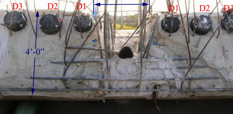

sym said:
Any thoughts on a better way to pour so the web and deck act more like a single unit? (I'm not even sure that's the right question)
Square up the pour joint and make the diaphragm a foot thicker.
SFcharlie said:
Earth314159 Any thoughts on a better way to pour so the web and deck act more like a single unit? (I'm not even sure that's the right question)
There are multiple issues with the joints. The horizontal interface shear stress is too high at the pour joints (it is also too high at other joints and just not the one that failed). You also have issues with the transfer of the vertical loads from the deck to the diagonals. The other issue is there is a functional architectural problem with the diagonals. When an architect or designer gives you a column projecting at an angle, you have to make sure people don't walk into the diagonal. It is especially important nowadays with people using cell phones. To solve all these issues, you fundamentally want a bigger base at the diagonals (a longer base in the direction of the bridge span). You flare out the diagonals parallel to the direction of the bridge (you can keep the 1'-9" width the same or perhaps make it a bit wider). People don't utilize the space below the diagonal anyways since you don't want to walk under a diagonal when you are close to the base (otherwise you hit your head). Architects think diagonal/sloped columns look cool so this is a common issue that I have encountered. We end up putting the columns on pedestals or coming up with some other solution.
There are multiple ways of designing the flares and it depends of the aesthetics that people are looking for. You can even create a raised flat surface for planters.
Once you get the stresses to a lower level, you can fit more vertical steel in through the pour joint without getting congestion. This helps for both the horizontal shear and the vertical loads from the deck. You have to add horizontal steel in the flares to transfer the load more evenly across the pour joint below the flares.
To give you a feel of design and stress level, an interface shear with a 1MPa stress is simple and straightforward with minimal steel crossing the interface plan. 2MPa is a typical stress but needs to be considered and specifically detailed. 3MPa is manageable. 4MPa is more difficult to design. 5MPa is possible but congestion has to be carefully considered and you have to start considering higher strength concretes and steel. 8MPa is damn difficult (not practical at all) with extremely high concrete strengths and steel strength with very careful consideration for congestion. This is why we should be working in stresses and not forces. A stress level corresponds to certain design expectations. There is a more immediate understanding of the design issues.
I should also mention that other stress levels are high (such as the vertical shear at the web joints). With just a bit a re-sculpting of the shape, you can make a big difference to the design. The reshaping can also look better. It is my experience that structures that are proportioned with more realistic stress levels (not too high or too low), tend to look better.
What is your thinking on making the diaphragm a foot thicker? Perhaps I am misunderstanding what you are proposing and why.
I meant a foot wider, to increase the horizontal thickness.
In my view there was failure of the cold joint for the first 100mm or so, and beyond that it's an overall concrete punching failure thru the diaphragm. If the diagram was 3 foot thick not 2 foot thick it couldn't punch out the way it did.
hokie said:
This was reported by several sources.
It mentions the bridge was supported each end, i.e. gravity loading.
I agree with Earth that the PT and shrinkage shortening would not induce sufficient loads to fail the node. The canopy and member 12 are not stiff enough to resist the shortening.
