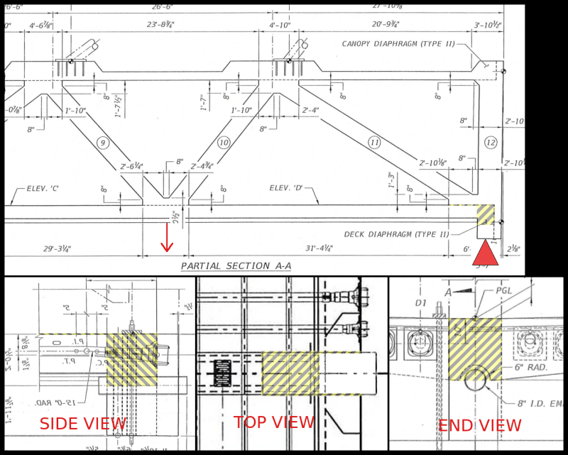

Epoxybolt,
I don't think that the diagonal cracks in 11 and the vertical crack on the south side of #12 are the same as indicated in the note in the marked up photo. I think you are correct in stating that the base of 12 was rotating which caused the vertical crack on the south side of 12.
There was a large increase in vertical steel in 12 compared to the rest of the joint. The south three feet or so was sliding. The base of #12 was not going to move so easily. #11 is essentially pushing the bottom of #12 which is being resisted and anchored by the #12 vertical bars. This is why there is also some rotation. The base of 12 is firmly anchored so the chunk of concrete at the base of 12 starts to rotate outward.
#12 had 3#11 vertical bars on the south side and a total of 9#7 bars on the other faces. Those bars essentially stopped the chunk of concrete at the base of 12 from sliding.
I think I cover the concept of using PT in fractured conditions with Rock Anchors. None of it is done without some fairly well defined conditions of the substrate, which is absent in the FIU Bridge circumstance.
MikeW7 (Electrical) - I went back and watched the video. The South Diaphragm is pulled to the North during the collapse.
I think the tortured nature of the rebar in the base of 12 suggests that it momentarily stood independent of 11, dropped ~straight~ down and slid out the back of the north diaphragm, before being dragged back to the south by the diaphragm and the deck.
Earth314159 (Structural) - I'm a bit confused by your 1st paragraph and photo references.
The 2nd paragraph agrees with my thinking. The concrete has failed and the rebar is ballooning out the back of 12 to the north and vertically. The rebar in the back of 12 is also more securely developed in the diaphragm.

I speaking of the cracks prior to failure. It took more stress to move the base of #12 than the base of #11. Hence you get the vertical crack on the south side of 12 and rotation prior to the final failure.
I am not too sure which side of 12 is the "back" side. You mention "A1 crack" and the vertical crack as being the same crack. I am not too sure why you are doing that. The diagonal cracks in #11 are due to shear friction and the vertical crack in #12 is due to rotation at the base of 12.

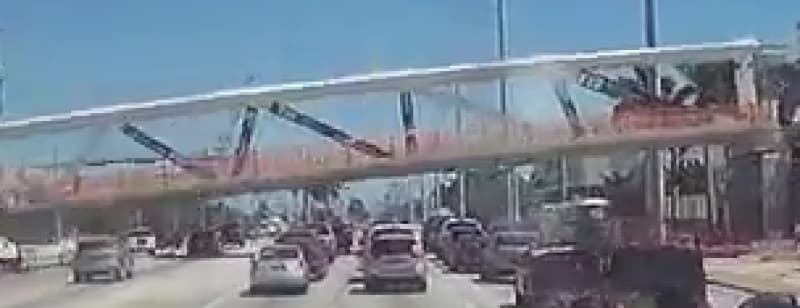

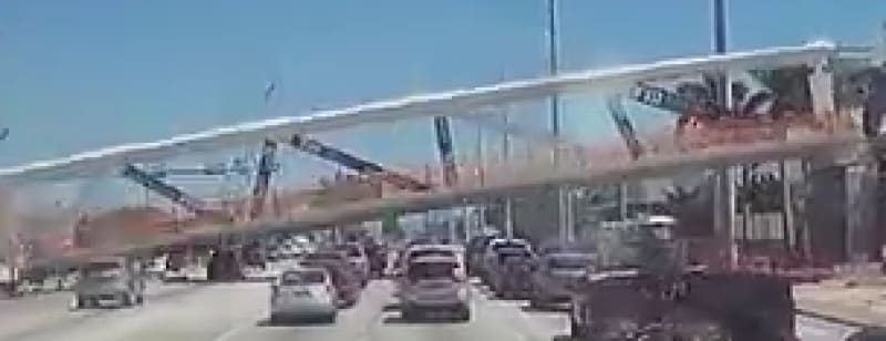

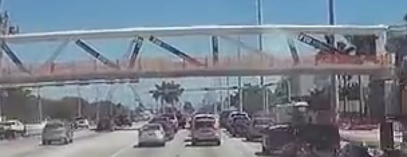

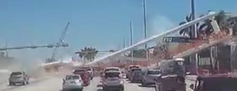

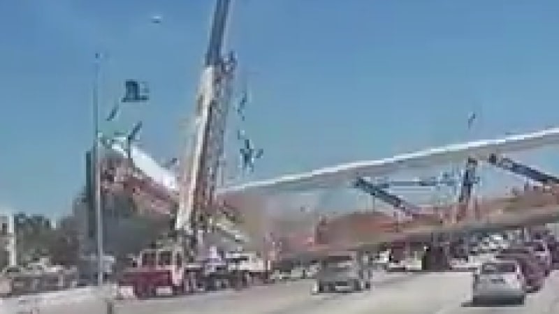

As the 1-10 truss section begins to fall it appears to mostly just tilt at the pivot point formed by the south pier bearing pads. The south diaphragm isn't significantly pulled north until the deck hinge hits the pavement and the 1-10 truss flattens out.
From the dash cam video: ZIP file of cropped frames 074-088 and AVI video of the south end, all "enlarged" with nearest neighbor algorithm (each pixel replaced by 4x4 block of identical pixels) to minimize artifacts.
Relevant frames 076, 080, 081 and 087:
South end - Frame076
South end - Frame080
South end - Frame081
South end - Frame087

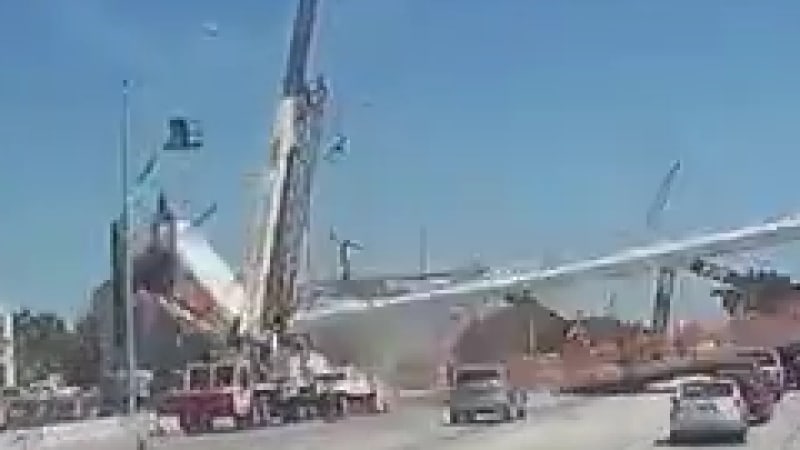

Meanwhile at the north end, when the deck hinge hits the pavement at Frame081, the north diaphragm is almost completely off its pier and member 12 has fallen behind the pier. A fifth of a second later, at Frame082, the north diaphragm is off its pier:
North end - Frame081
North end - Frame082
Note that in Frame082, the "falling man" is still in the air. What an incredibly fast sequence of events....
The workers were attached to a line strung center-line across the 174 foot canopy. This worker was held aloft either by being entangled with something during collapse or because he intentionally attached his harness to crane cable at some point. In any case your image is just after his harness failed. Read OSHA citation for that violation (Sep 9 2018, pages 6-7):
The falling guy - take a yardstick, set one end on a support and hold the other level. Put a coin onto the held end and then let the yardstick go. The coin will fall more slowly than the end of the yardstick.
jrs_87 (Mechanical) 12 Jul 19 22:00 - The canopy first deflected in frame 077, and the deck hinge point hit the pavement at frame 81, 0.8 seconds later. The falling man didn't have his crotch straps buckled and the only resistance his harness offered was the time it took to yank his arms up to allow him to drop out. His feet were never more than 2-3 feet above the canopy all the way down. What an incredibly fast sequence of events....
Not sure how the harness could see any resistance. The safety cable was attached between the two ends of the canopy which were coming together and a fast pace; the cable would have gone slack almost instantly.

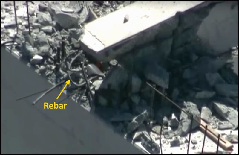

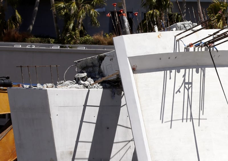

Has anybody noticed the jbar in the youtube video > FIU Bridge Collapse Lift off of 12 explains J-bar pristine condition < does not match up to the drawing?
Fig 63 in the OSHA report does lead you to believe jbar was not embedded into deck.
In fact by the pics the jbar (in pristine condition) appears to have been bent to fit the deck after pour and cure.
It's bent to fit and 180 degrees out from the print.
It was supposed to be right next to lower rebar embedded in concrete.
Fig 63 certainly shows it was not.
It's pristine alright and tells a tale.
Keep comparing fig 63 and the video jbar pic and the print.
Just a little detail.
It's just amazing how such a small rebar can go thru all that destruction and come out unscathed........
just how is that possible?

I commented on the J-bar in Part X 21 Jun 19 23:22. I came to the same conclusion that the rebar was not in accordance with the drawing.
As far as how the rebar can be unscathed, check my comments in this thread 29 Jun 19 17:27, 11 Jul 19 19:23. In the second I propose that an impluse extending from a smaller initial sudden failure shattered the lower end of 11. I'm interested in hearing others thoughts on this.
