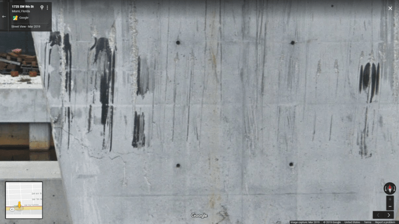

Force of collapse was energetic enough to cause minor cracks on face of thick north pier.
Chipping on pier edge appears to be directly related to punch through.

jrs_87 Chipping on pier edge appears to be directly related to punch through. [/quote said:
The chipping could possibly be due to the impact of the overhanging portion of 12 as it was dragged over the edge.
