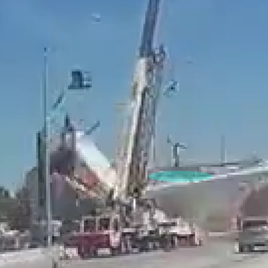

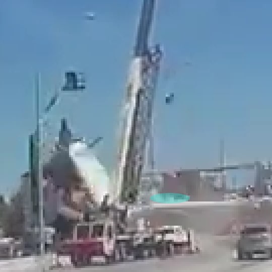

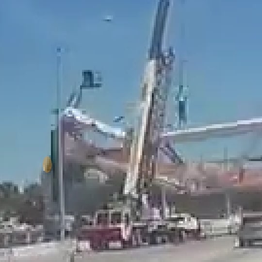

I prepared a cropped, enlarged version of the truck-cam video that is as free of artifacts as I can make it. A section of the original video was cropped to 240x135, then I resized it by a factor of 400% to 960x540 using nearest neighbor interpolation, both operations done with native filters built into VirtualDub2. From what I've read, nearest neighbor interpolation doesn't introduce many artifacts because it simply moves pixels apart and inserts the value of the nearest neighbor. It enlarges an image while preserving the "chunky" nature of the original pixelated image.
I also created individual images for each frame in the cropped video, and they are named after the frame number in the original video - Frame0072.jpeg through Frame0086.jpeg. The JPEGs were saved at 100% quality.
I zipped the video and JPEGs into a single ZIP file that can be downloaded with this Link. The video format is the ancient AVI windows format because that was all I could coax out of VD2. If someone asks I will convert it to MP4, but no guarantees on the quality.
My observations about the frames:
[ul]
[li]72-73-74 Nothing apparent[/li]
[li]75 - If you squint really hard and rub a magic nickle, you can just barely see the bottom of the deck move ever so slightly with respect to the traffic light beneath it. Collapse has begun. Or not. See the next frame.[/li]
[li]76 - The deck and canopy are starting to drop, but member 11 does not appear to have moved much.[/li]
[li]77 - Member 11 still does not seem to have dropped or rotated much in comparison with the dropping of member 10 and the canopy.[/li]
[li]78 - Member 11 has started to move significantly. The canopy above member 12 has dropped slightly, so member 12 has been blown off the pier.[/li]
[li]79 - Member 12 and its attached canopy are in free-fall. The area around the 11-12 junction seems to be filled with debris, and the lower 20% of section 11 seems to have disintegrated.[/li]
[li]80 - The bottom of member 12 is plainly visible to the left of the pier, and the canopy attached to 12 has now dropped 3-4 feet, using the "falling man" for scale.[/li]
[li]81-82-83-84-85 - As the entire canopy continues to fall, the section attached firmly to member 12 causes it to rotate, and the bottom of 12 is pulled up and dragged onto the top of the pier.[/li]
[li]ADD: 82 - The north end of the deck is falling off the north pier. [/li]
[li]EDIT: 86 - The north end of the deck and the bottom of member 12 have reached their final resting places.[/li]
[li]86 - The bottom of member 12 has reached it's final resting place.[/li]
[/ul]

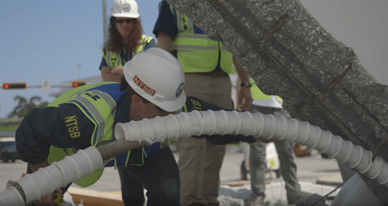

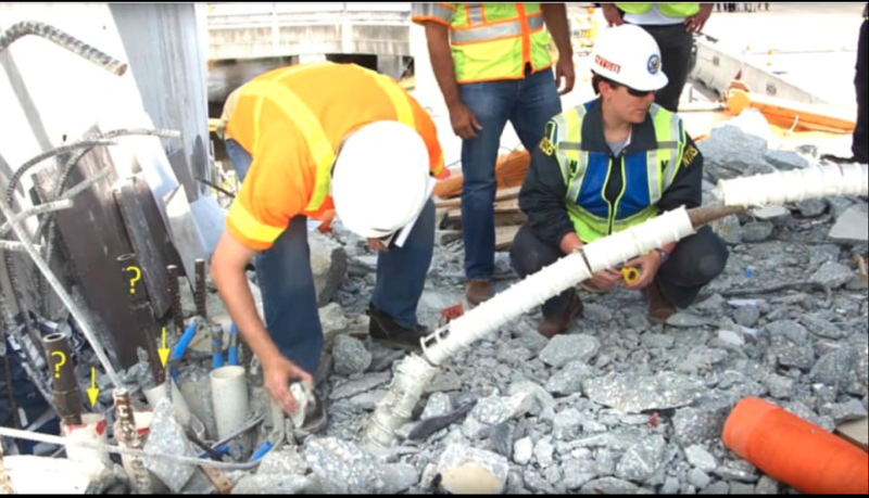

The rod could not have broken/sheared as part of the shear friction failure. It had to stay intact since it ripped through the bottom of #11 and ripped out all the ties as the deck fell to the ground. It essentially ripped out the back of #11 rather than shearing.
It is worth to examine how the span failed to distinguish the root cause from the consequential damages.
NTSB and OSHA photos indicate a gap of about 5mm or 1/4” in the cast-in duct in 11/12 before March 15. It would be safe to suggest 11/12 has deflected outward relative to the deck.
On March 15 Member 11 was re-stressed to nearly the original level, upper PT 280kips and lower PT 230kips, when the span failed.
The geometry of Member 11 tells us any additional outward deflection, from the re-stress, will flatter the angle resulting a higher horizontal force pushing outward.
(1) While the angle in member 11 progressively flattened and 11/12 outward movement increased the bridge reached a point that it was no longer able to support itself. It therefore quickly deflected downward. With increased curvature the deck would tilt at both bearing supports.
(2) When the bridge finally broken the deck profile changed from a curve to a “V”. This is important because horizontal distance between the two top points of the “V” is shorter than original deck length. This could cause the bridge to depart from the bearing supports.
(3) When the bridge was about to snap into a V the tilted deck could slide downward to clear the pier. This happened to the 11/12 while the south end, still with everything attached, was resting on top of the pier.
(4) The 11/12 joint was partially damaged prior to re-stress. The re-stress would inflict additional damage. The collapse mechanism flattened the Member 11 beyond the point of no return. Thus during collapse 11/12 was progressively moved outward while the broken deck pulled itself inward.
(5) The progressive separation of 11/12 from the deck facilitated the deck to leave the bearing support and drop to the ground while 11/12 was caught by the pier and did not fall.
(6) The shear weight of the dropping deck produced some consequential damages. Among them are lower PT peeled off from Member 11 and ripped open the confining shear links and a blow out of concrete when 11/12 was forcibly separated from the deck.
Earth314159 (Structural) was right. The lower PT rod did not shear but able to rip out the ties in Member 11 as depicted below.
The plastic sleeve/duct was cut during the ties rip out. NTSB video shows the a number of ties rip open by the lower PT rod.
I believe the sheared lower PT rod in OSHA report Fig 63 may have been artificially cut to show the construction joint. Apart from Fig 63 I could not find a reference the lower PT sheared elsewhere in the report.

MikeW7 Thanks again for putting your time into the video. Here are my notes:
On image 74, potential worker on deck (green), potential debris blowing out north of 12 (pink)
On image 75, potential puff of debris (yellow), potential deflection of 10 and 11 (red arrows)
On image 80, bottom of 12 dislodged off of diaphragm (orange)
On image 82, potential furthest extent that PT rod is pushed through the canopy (cyan)
On image 83, PT rod is sucked back in as the deck falls off the pylon (cyan)
