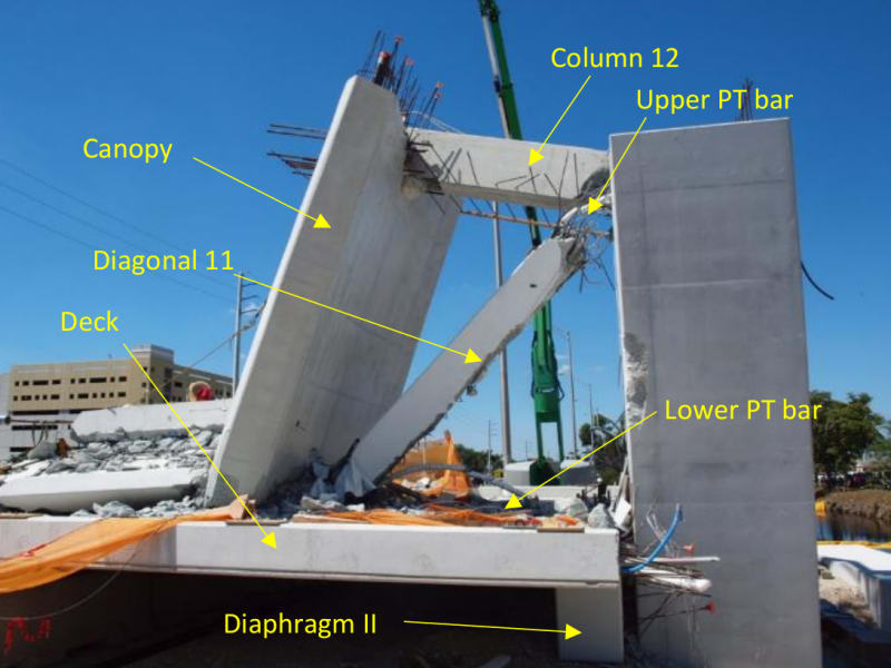

FCharlie (Computer) 11 Jul 19 17:15 said:
This puzzle has many pieces...
Now that the autopsy is reaching its end stage, the CSI work gets more attention....
The description of the Warren truss is focused on the actual "truss action" of the structure. The canopy north of joint 10/11 does not support any "truss" forces (except, in this case, residuals from continuety of cast joints vs. pinned joints). True "trusses" support loads by axial forces in members only - those members may have loads applied between their ends, causing bending in some members but that is another matter.
In this case, the canopy is attached to the "warren truss" and extends from node 10/11 to coplumn 12. And the canopy is continuous, complicating matters again. But the "truss" would have been a truss without member 1 or 12 and without the canopy between 1 and node 2/3 or the canopy between node 10/11 and member 12. Other things would have to provided stability to the top joints 2/3 and 10/11 for the structure to be stable but the "truss" action would remain complete.
But the canopy and the column 12 are connected to the structure, and will be pushed or pulled depending on what is happening at their connections to the truss. If joint 11/12/deck is sliding, the bottom of 12 must go with it because they were cast together. At what point they separate and act independently (or react) will depend on the damage and its progression.
The initial loss of "truss action" seems to be due to the loss of the joint of 11 to the deck or the internal failure of 11. Either would render member 11 useless (or so limited as to be so) and result in a loss of vertical component to support node 10/11, causing that node to begin to fall.
Because of the cracking of the deck as photographed before the collapse, the node 11/12/deck is the most likely culprit to have initiated this failure. A failure at the top of 11 would have been just as catastrophic. But that probably would not have left the north end of the deck with the appearance of a blowout as we can now see.

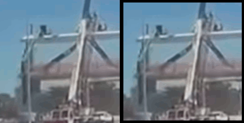

Vance Wiley - If the base of 12 was kicked north a foot during the blow-out, that would also bend the attached canopy, based on the apparent rigidity of the 12-canopy joint. Given that the canopy tendons were anchored in that section of canopy, it would require a LOT of energy to bend the canopy, wouldn't it? Seemingly much more than was released during the blow-out. Either that, or the kickout may be what initiated the 10-11 canopy hinge, which was then followed by the 9-10 deck hinge. Saikee119 (Structural) 7 Jul 19 14:39 discussed this, and the possible order of events, and I'm sure many others have as well, but my memory is not that good anymore, and my "reading comprehension" of structural terminology is limited. My contribution to all this is establishing that the "L" appears to be very rigid.
(Edit: With all due respect), my analysis of 29 Jun 19 17:27 is correct. The bridge gained a degree of freedom when 11/12 snapped free (audibly even) of the upper half of the deck/diaphragm and the bridge truss sagged. The same strain was occurring at the south end but it had yet to break free. 12 bowed slightly to the north as it was pressed on by 11. The greater movement was the deck sagging and moving past 11/12 in the opposite direction. The deck was pulling the heel of 11 down with it and preventing the heel from following the toe and 12. The result is that 11 is split while the illusion is created that it is sliding along the deck, it is not!
The torque action that I see is not one of a wheel spinning on an axis but of a stress field developed between the diaphragm and 12. The diaphragm is twisted. It has to contend with the longitudinal PT cables pulling the wings of the deck to the centre of the span and the truss members pushing the centre of the diaphragm away from the centre of the span. In addition to this, at least for a time, the diaphragm had to contend with distributing the vertical load to the poorly placed shims. The internal stresses in the remaining interface are complex and a mountain of rebar in the diaphragm/12 connection absorbed this punishment.
The cracks in the slab and diaphragm are from the twisting of the diaphragm and the sticky movement of the deck past 12. OSHA drew a beautiful sketch with triangles relating shear between 11 and the first PT cables but this is nonsense. The plastic pipes cannot transfer shear nor could the balance of the ill purposed interface. The members were not contiguous at that level.
It is not reasonable to think that the distressed 11 had the resolve to destroy 12/diaphragm. The video shows the collapse in motion before any substantial vertical descent of 12. Also, if the node blew out first, this would have instantly relieved 11 and it would have remained in tact. This and the fact that crews were tensioning the PT rods leads me to believe that 11 failed next. There are two possibilities. One, the toe of 11 crushed, and two, the bending moment on 11, imparted by the sagging deck, combined with the dead load and increasing compressive load wrought by the PT rods caused a failure towards the center of 11 (note the mangled rebar at the remaining end). I suspect an impulse blew apart the balance of 11 and the node as a pancake failure would mangle the rebar.
12 broke out of its lower rebar when it was yanked to the south and down by the canopy.

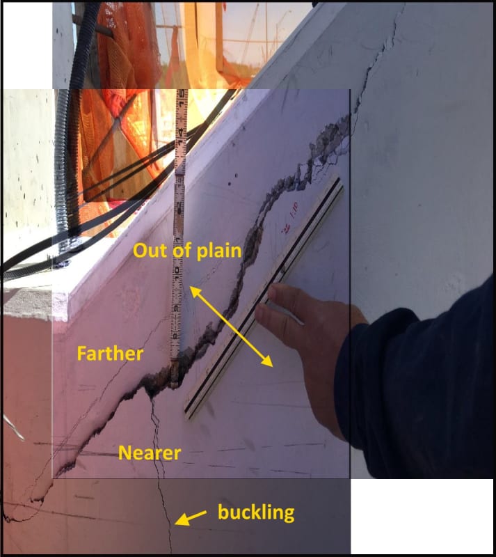

I'm afraid that the time it took me to develop this info left me behind the curve, but here it is anyway.
Member 12 East and South faces: 3' x 10.45' from bottom of canopy to start of crumble.
Member 11 East and South faces: 2' x 17.20' from extrapolated top of deck to start of crumble.
Obviously there is some distortion from the wide camera lens and proximity of the camera to the wreck of the bridge.

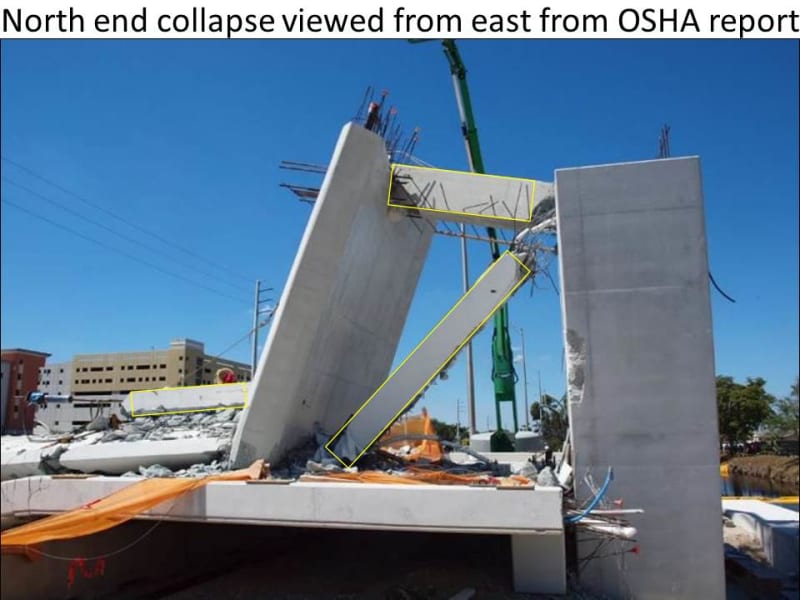

Refer to the cut-and-paste mashup below for an clearer explanation of what I am trying to describe. Details after the images. Apologies for the north-south reversal - this was the best diagram I could find.
[ul]
[li]The red diamonds are the fixed pivot points atop the piers.[/li]
[li]The red slashes are roughly where the hinging occured.[/li]
[li]The red X indicates where 11 failed (more or less).[/li]
[/ul]
When the span started to fall:
[ul]
[li]The hinge points forced the north sections of canopy and deck to "pinch" - move closer together.[/li]
[li]The north deck section was pulled south because its hinge point was below the plane of the pivot points.[/li]
[li]The north canopy section (and the upper section of member 12) was pushed north because its hinge point was above the plane of the pivot points.[/li]
[/ul]
These effects combined to force 12 off the north side of the pier.
ADD: Estimated maximum distance the bottom of 12 moved was was 4 feet, according to Vance Wiley (Structural) 11 Jul 19 17:45
The lower section of member 12 did not (could not) begin moving south until the truss section between members 1-10 collapsed on impact with the ground (starting at dash cam frame 82) allowing the truss canopy to drag the 12-canopy "L" to its final resting place.

You want to move the upper plastic hinge to the left (centre line of the joint) so that the canopy/#11/#12 remains more or less as a triangle. But that is the rough concept otherwise.
Earth314159 (Structural) 11 Jul 19 21:20 said:
You want to move the upper plastic hinge to the left (centre line of the joint) ... But that is the rough concept otherwise
Yeah, it really doesn't matter exactly where the hinge is. What's important is that there was a hinge in the canopy, and this pushed the 11-12-canopy diamond (or 12-canopy "L") to the north, and popped the upper section of 12 over the north side of the pier. Except for what remained attached to the deck, the 11-12 joint never moved south until the truss canopy collapsed on impact and dragged the diamond/"L" southward.
The triangle and hinge location is important since it keeps #12 more or less square to the canopy.

Makes sense. The north face of 12 was inside the failure block, well back from the front line, so would have been spared much of the damage.

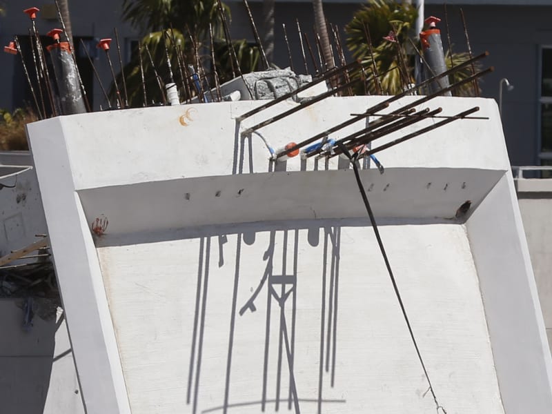

Another view of #12

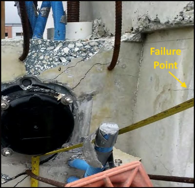

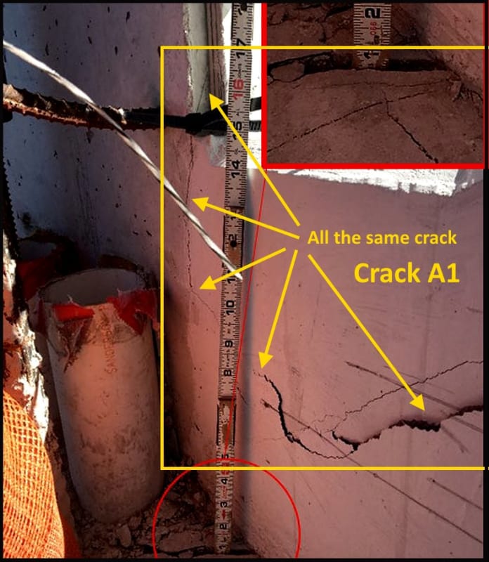

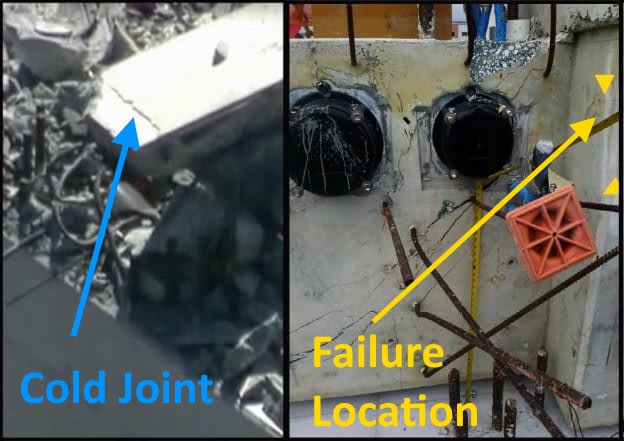

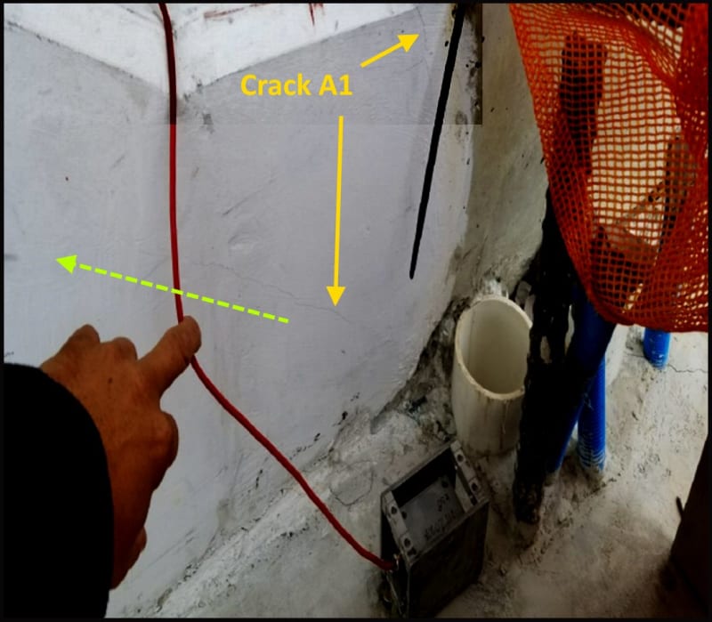

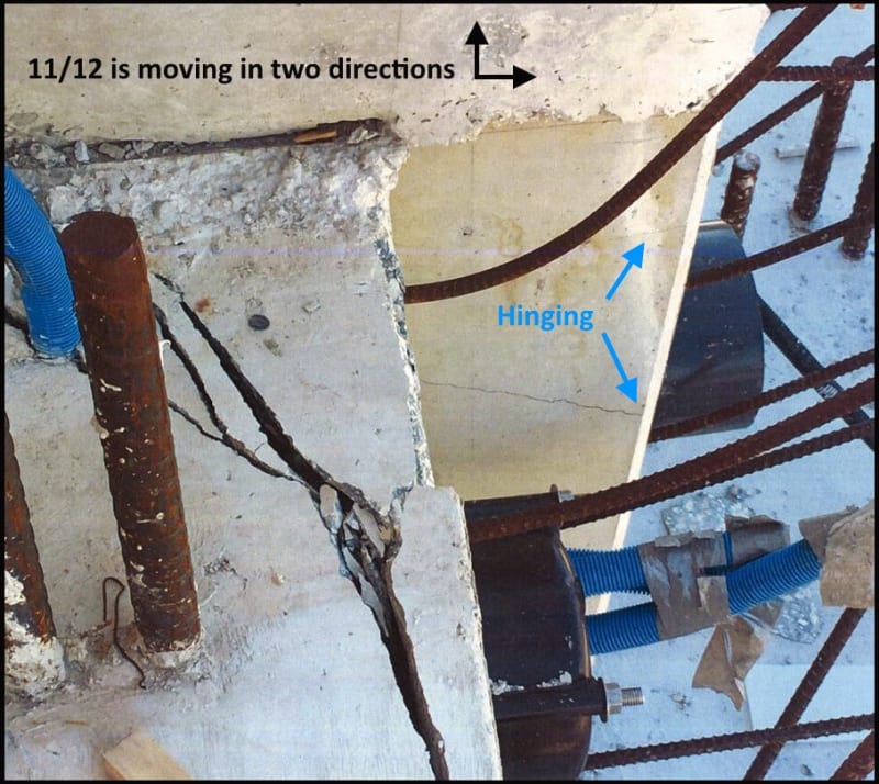

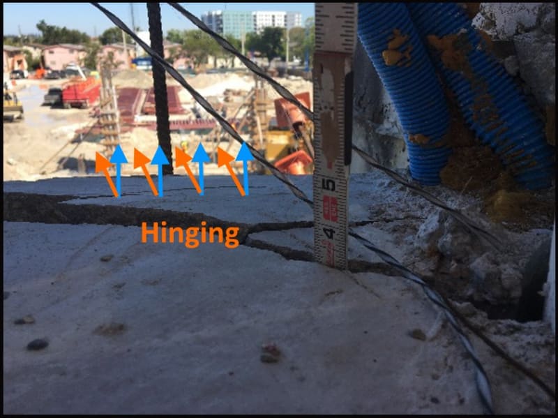

Following up on the last post by Sym P. le (Mechanical) - More and more it looks like the failure was purely the 11/12 anchor zone of the Upper PT bar. That the fractured mass of concrete & rebar in front of the anchor plate yielded. It is certainly true that prior to work, to retension the PT bars in #11, that all the rebar in the 11/12 node was resisting the weight of the bridge but when the front of the 11/12 node failed towards the south, #12 was momentarily relieved of performing any work other than self weight & the canopy.
The base of 12 was already hinging upwards & outwards before the collapse. That is why their are cracks in the base of 12 before the collapse. Because it is bending at the deck/diaphragm elevation.
It is hard to perceive from the photos available but I think it is very likely, that the #11 upper PT bar and the concrete surrounding it, had failed completely during detensioning and that the only thing holding the bridge in place was Rebar & mechanical interlock of the broken pieces of concrete. That isn't to say that there wasn't progressive cracking but that the concrete was now little more that a pinned & caged rock formation, holding up a bridge. The more you group the cracks into a whole, the more it becomes clear #12 was lifted slightly during the initial cracking at the time of detensioning.
The deck and diaphragm haven't moved but the failed concrete still homogeneous to 12 has lifted. (Rotation)
It appears more & more, to my my mind, that the front of the 11/12 node failed to the south.
This kind of failure, if accurate, sort of raises the issue as to the procedure used to detension the PT bars. I've managed too many jobs to rule out and "Oh Crap!" moment. Most jobs have a number of them. It is just the nature of the people doing the work. You can give people all the training in the world but there are still instances, where if you don't spell it out for them, they revert to stupid. This is where I go back to Member 11.
If the span was starting to sag at all, does this up-and-out lifting of 12 correspond to what I was trying to explain in my cut-and-paste mashup of 11 Jul 19 20:46, or is it just a coincidence? I'm not a structural guy, but once I figured out that concept the whole collapse video started making perfect sense to me.
ADD: Even without hinge points, it seems like the same pull-deck-south and push-canopy-north dynamic should hold true if the span sags, just on a much smaller scale.
