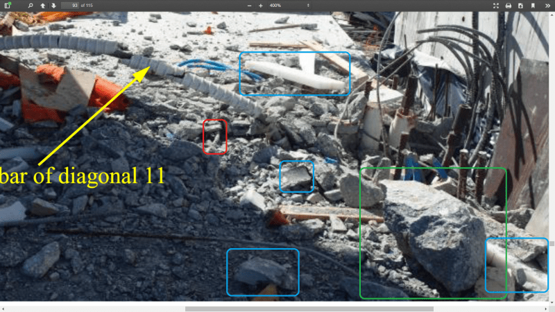

This larger fragment of 11/12 node (green) is of interest to me. How it separated with this size and shape should be explored.
Turquoise marks 2 whole shims, 1 damaged shim, drain pipe fragment, and concrete fragment with impression of PVC pipe. The steel plate leaning on pier is leftover stock used to fabricate emergency steel shim?
Can rebar (red) be identified? Is it important?
@jr - that's a good question. It looks like the block even has a rebar mark on the front face. The steel plate is likely the shim that was used under 12.

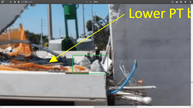

Another view of block, and another similar block that was out of frame in previous image.
They are screenshots from OSHA report, zoomed in with added markups. The page of report and zoom level can be seen in top margin of image. Page 91/115 and 93/115. Zoom 400 or 800 percent.

Does the lower PT rod pulling out of member 11 indicate insufficient confinement? It prevented the PT rod from having any possibility of working as a dowel. Does member 12 have insufficient confinement? It seems to have "exploded" around it's rebar, leaving the rebar more or less intact.
SF Charlie
Eng-Tips.com Forum Policies
SFCharlie (Computer),
I am convinced that 11 and 12 were moving together as one unit at the bottom. Member 12 has some additional resistance against moving outward and this is from bending its connection with the canopy. The resistance from bending is relatively small because a very small deflection at the bottom of 11/12 is enough to fail the joint and collapse the bridge.
Most people outside RC design may not realize the cast-in items, of 4 No. 4" vertical sleeves and one 8" horizontal pipe, could and have destroyed the integrity of this joint because they shortened the load paths.
You can see from my 29 Jun 21:49 posted sketches that the centrelines of 11 was able to join with 12. The deck was only to the side of 11. The one PT rod were also arranged to bit hard into the deck while the other to 12.
Member 12 is not structurally important and it together with the part of the joining canopy are omitted in a standard Warren bridge. As each joint the internal and external forces must be balanced to achieve equilibrium. The horizontal component of the diagonal 11 balances with the tension in the horizontal deck while its vertical component with the vertical reaction (50% of bridge weight) at the pier or pylon. Therefore one can chop off 12 and the bridge will still stand. However the canopy was used for anchoring the longitudinal PT tendons and 12 would have its self weight exerted on the support, other than that 12 had very little resistance against moving outward.
In conclusion 11 only needs one insufficiency from its connection with the deck and carries 12 as a piggyback. Obviously if 11/12 were to break away from the deck it could slid out of the whole CJ or part of the CJ with 12 broken off along the plane with the 8" pipe. It chose the latter.
The crack photos confirm 11 suffered some internal splitting in axial direction first slightly when it was first tensioned in the roadside and then later quite seriously, with 12 wide and 72 deep cracks, when the tension was first removed.
The pull out of the lower PT rod should be looked at a consequential damage. It was from a follow-on consequence when the deck dropped to the ground while 11/12 was caught up with the pylon. The blow out was indeed due to insufficient concrete surrounding some rebar but OSHA has reported a smaller number of rebar were sheared off at the CJ.
