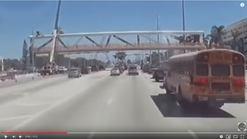

Here is a ZIP file of those frames, in two folders. One folder contains 640x360 frames cropped directly from the original video. The other folder contains the same frames enlarged to 2560x1440 using the methodology described at the end of my 7 Jul 19 04:44 post.
You probably won't be able to tell the difference between the two sizes if your image viewer automatically upscales and interpolates small images, a problem I discussed in my post dated 13 Jun 19 16:53. If your image viewer can be set to "view original size" or something similar, the larger images will appear as bigger versions of the smaller images with no interpolation artifacts - each pixel of the original image is expanded to 16 identical pixels in a 4x4 block.

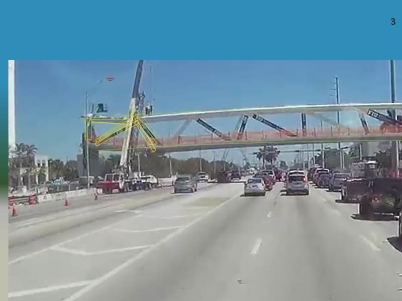

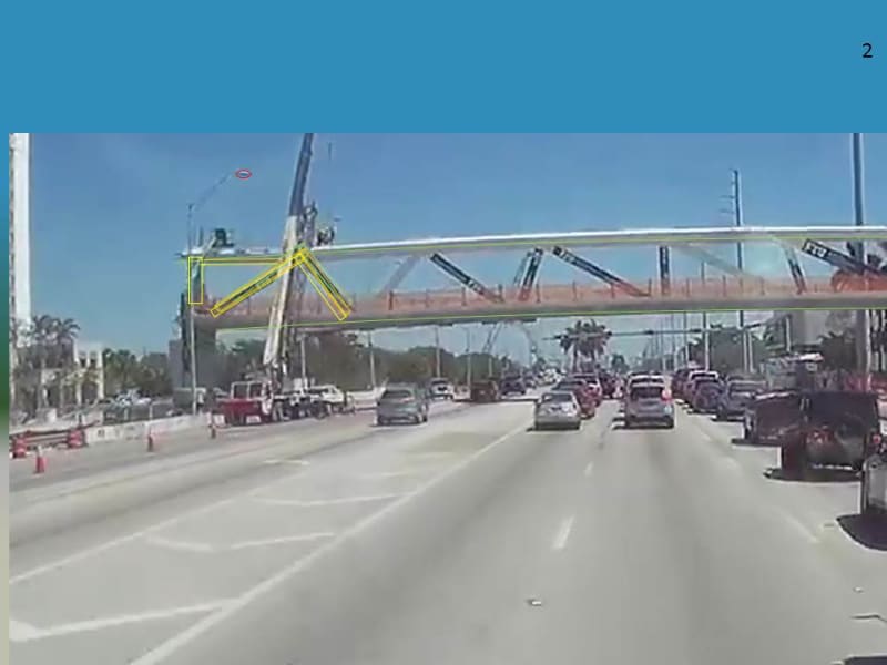

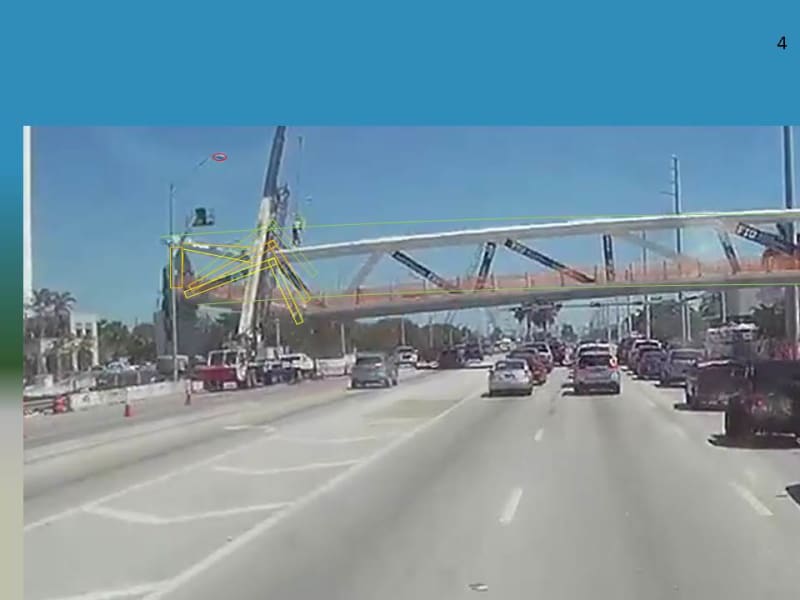

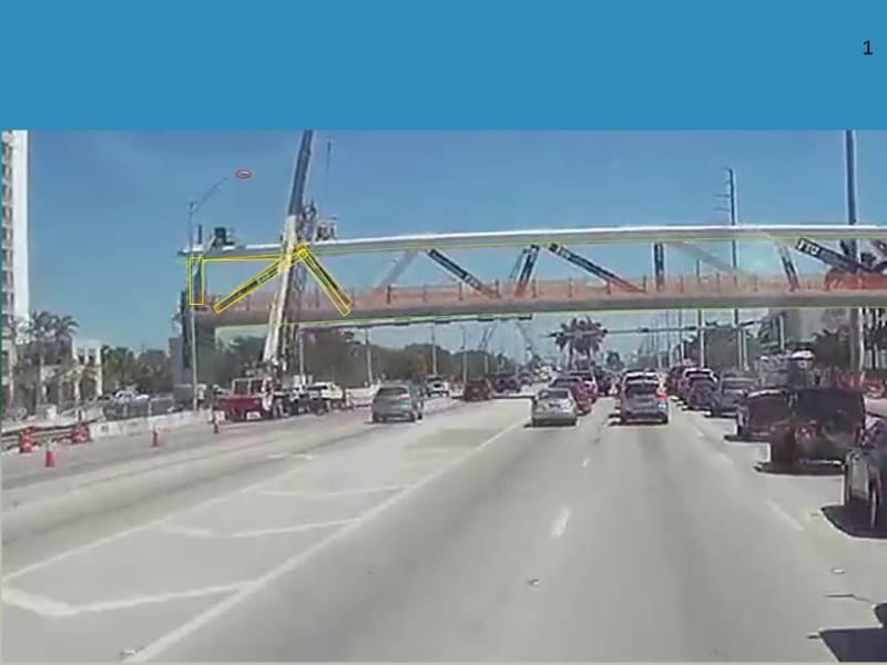

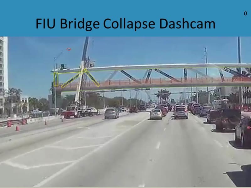

I did an analysis of the dash cam video a while ago, and abandoned it as more info came in. I have made .jpg files of the slides. dashcamanalysedfrompowerpoint.zip
Green outlines original position
Yellow outlines current position
Orange shows position on previous slide
(Before any movement detected)
(angle in canopy at 10,11 angle between canopy and 11 remains constant angle between 10,11 changes)
(continues as 12 appears to remain vertical)
(Finally 12 tips)

Thanks for posting these.
By that stage the collapse is well underway. Are there any earlier frames showing excess curvature?
I was not able to detect any curvature, but the cherry picker arm in the foreground and the building behind make it difficult to make out 12, I admit.
SF Charlie
Eng-Tips.com Forum Policies
No. Frame 049 is part of an identical sequence 046-050, which is then followed by the 061-061 sequence. The time stamp in the lower RH corner of the traffic-cam footage was updating about every 0.4 to 0.5 seconds, so the phone was recording sequences of 10-15 frames for each update of the traffic camera. The video metadata says it was shot at 29.97 fps.
I went back and reviewed my analysis of the traffic cam footage, and the curvature in 12 is constant thru all the frames where 12 is intact, so it is not an artifact of the process, but probably an artifact of a wide angle lens on the traffic camera itself.

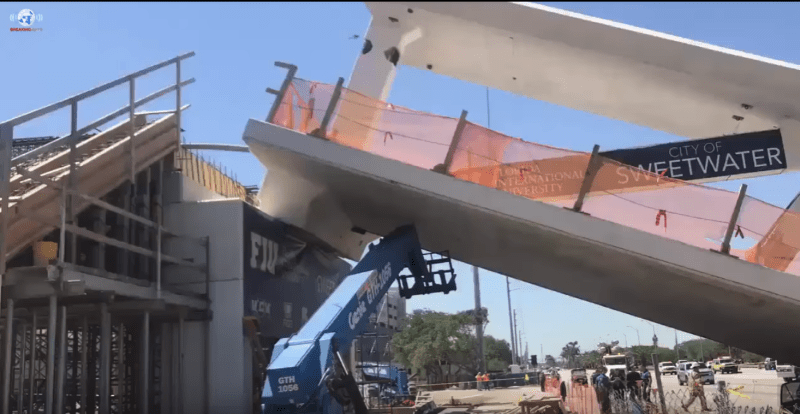

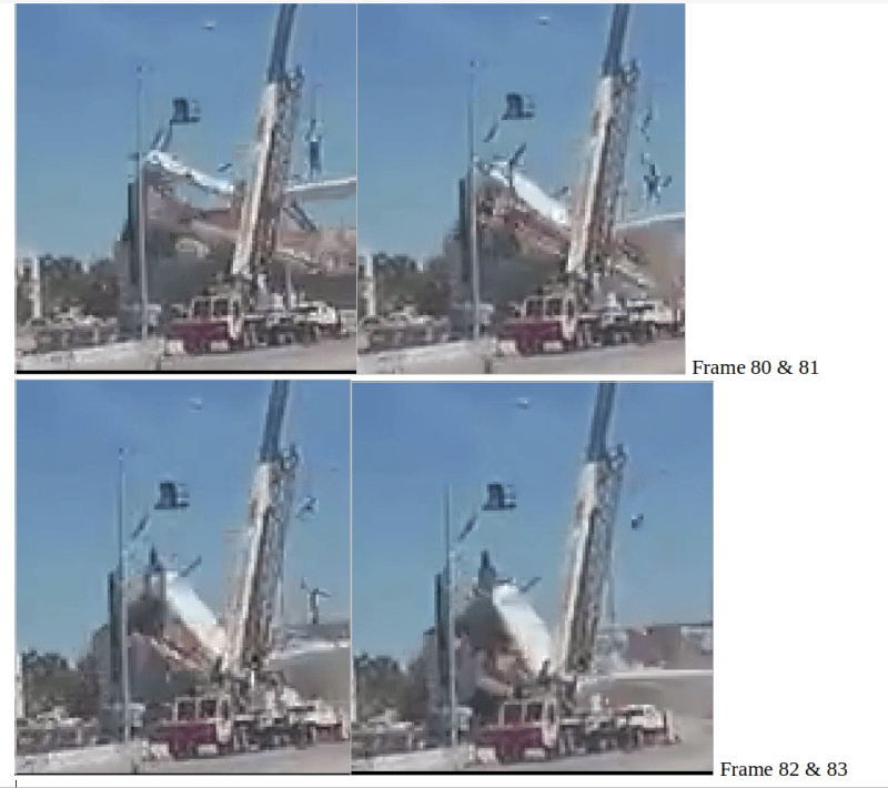

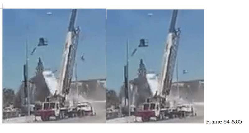

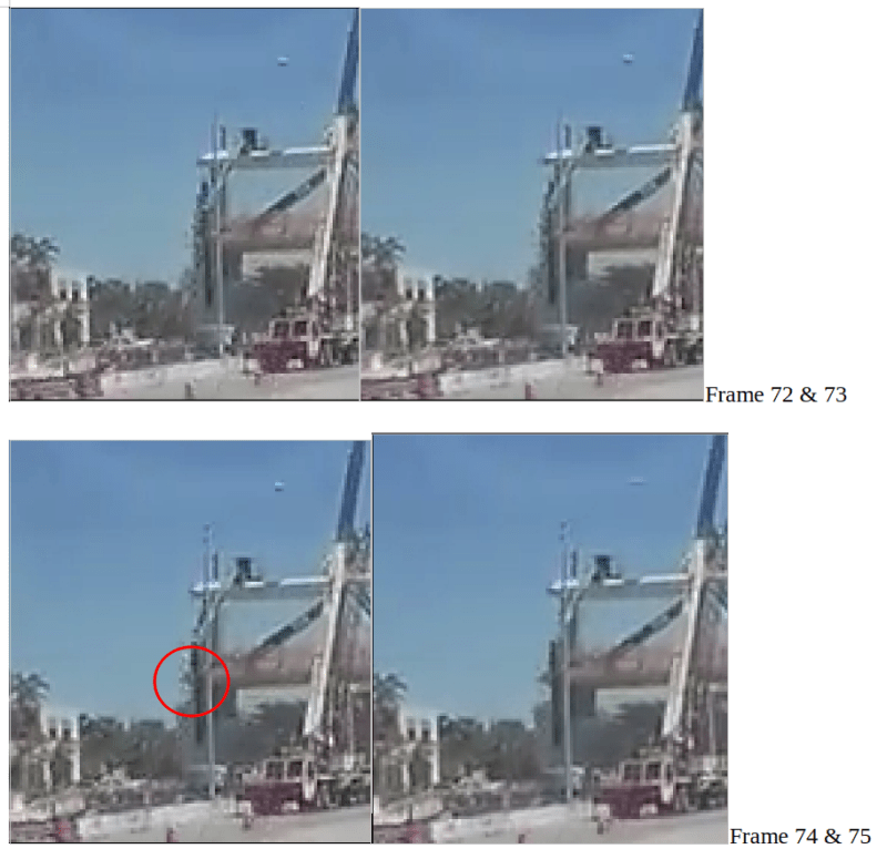

Mikew7 on June 22 post has posted the following frames which I cut off half for space saving listed below. The purpose of re-posting these photos is to show the side extrusion on the north side of Member 12 at the bottom of Member 11. Mikew7 has already gave a run down of the general events.
The extrusion on the north of Member 12 first appeared in Frame 74, remained visible in Frame 75, 76, 77 and 78. It can be said the extrusion disappeared in Frame 79, 80 and 81. Something similar, possibly from the broken off bottom section of Member 12, were sticking out at nearly the same level in Frame 82, 83, 84 and 85. Member 12 could not be viewed properly as it was partially shielded by the rear crane most of the time. From Frame 82 to 85 the dust and debris from the deck/11/12 joint breaking-up could have darkened some areas.
The deck could be seen resting on top of the pylon in Frame 72 to 82. Its departure progress from the pylon was recorded in Frame 83 and 84. Although the view of the deck was blocked by the front crane in the last Frame 85 it is known the deck final resting position was on the ground.
SFCharlie (Computer),
Some Forum members have already mentioned something were sticking out at the north side of member 12 during the collapse. It was generally interpreted as the deck/11/12 suffered a blow out at this position or some concrete was broken off but still retained by the rebar momentarily.

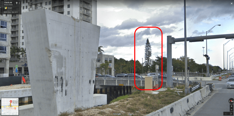

At exactly the same location of the extrusion, by that I mean something extruded out from Member 12, there was an evergreen tree at the background and so one can say the extrusion could be from one of its branches. However the size and times it appeared and disappeared in the video does suggest it could also have been a byproduct of the collapse.
The evergreen tree branches might have been trimmed when the Google Street View was recorded later and depicted below. It is between the empty pylon and the steel column for the traffic signs. This tree could be seen in all the frames above.
The evergreen tree at the time of collapse can be seen below.

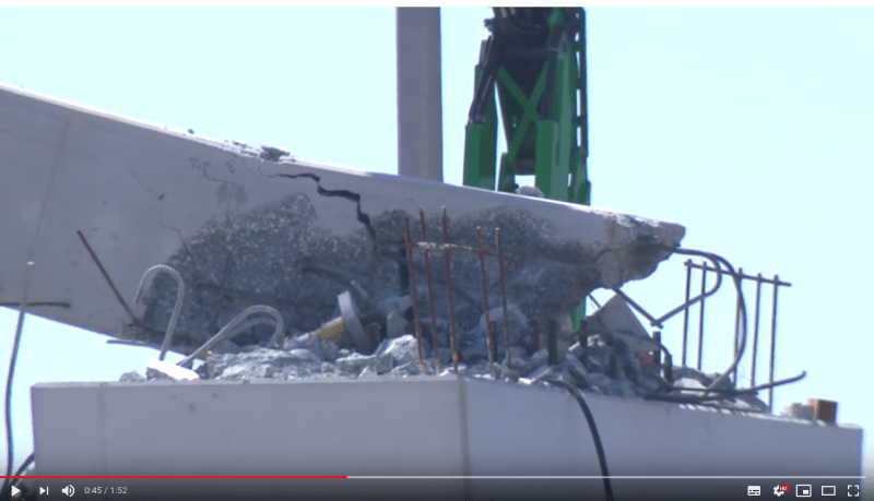

I had interpreted the rectangle to the left of member 12 and aligned with the front of the deck as the northwest corner of the deck. I think it appears as the truck moves from west of the deck to southwest of the deck. It does appear attached to the deck as it rises in line with the deck as the deck falls. To me, it appear to move with the deck as they slide off the pier.
SF Charlie
I would agree one possible explanation for the sticking-out object could be the northwest corner of the deck to an approaching vehicle from the west.
On balance the frames show the object more triangular than rectangular although it is harder to tell in the original video.
The bit difficult to explain is as a part of the permanent structure this object was able to disappear when the camera got closer.
It is also slightly thinner than the rest of the deck's edge, visible in different color and seemed too long without the temporary fencing attached.
I went back and reviewed the frames I had analyzed. One thing I noted is the appearance of dust on deck between the bases of 12 and 11 in the frames that show 12 starting to tilt. (small in the frame where 12 barely tilts and larger in the frame where the tilt becomes definitely visible.)
I just reviewed the timelapse of the bridge move. the temporary fencing ends at the south face of 12.
As the diaphragm tips south, the corner of the deck would also move south.
