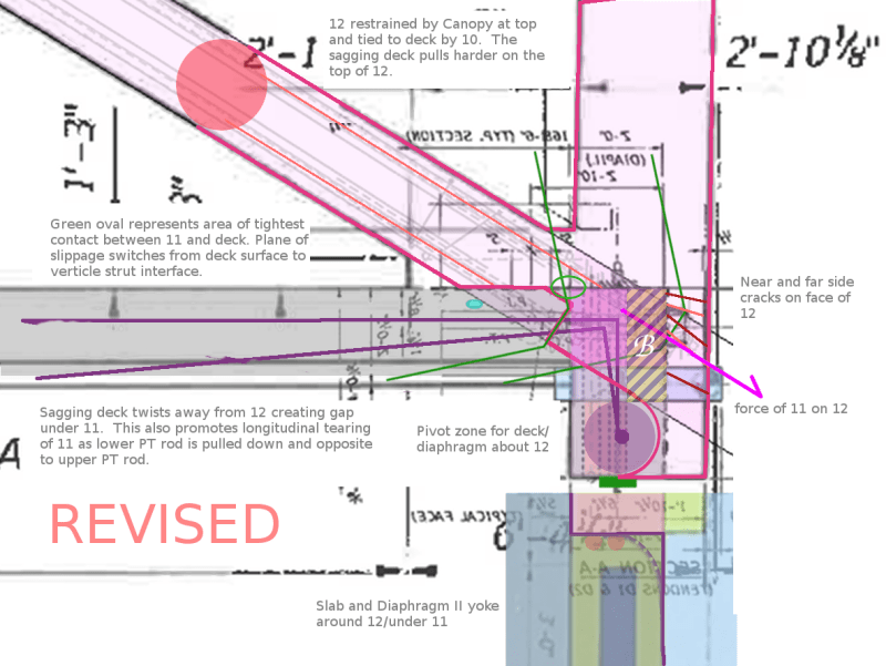

My revised drawing and images from OSHA for comparison of left/right side diaphragm and 12 cracking as well as indicating damage to underside of diaphragm.
saikee119's B shear plane is the only significant shear zone as the deck surface is not in contact with 11 and there is no indication that the cold joint shears through 12.

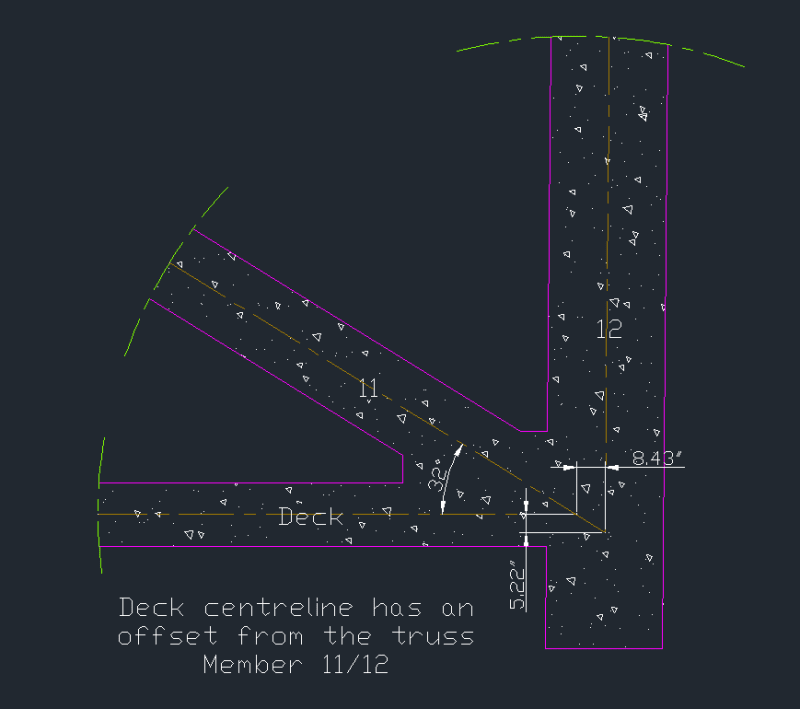

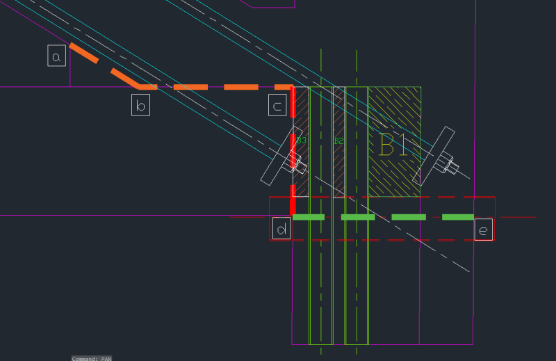

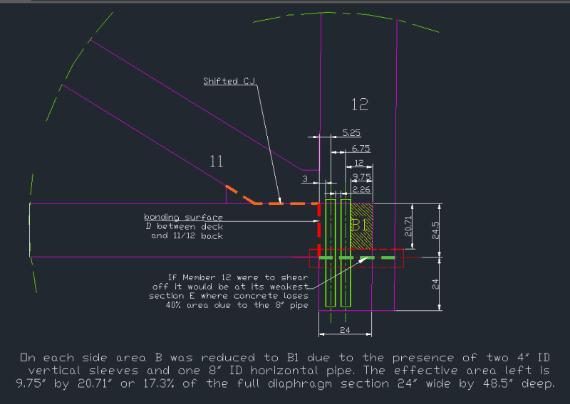

I have prepared a break down of the failure surfaces and explain them with the following sketches.
The center line through the truss/bridge should look like the sketch below.
Fig-1 Deck center line not meeting center line of 11/12
An interesting feature is the deck does not join the centers of 11/12. It eventually broke off from Member 11 leaving 11/12 substantially as one entity despite serious spalling at the joint.

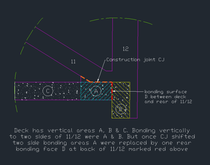

I then looked at how the deck was bonded to 11/12. This is shown in the sketch below.
Fig-2 slid CJ altered the internal resistance pattern of the deck/11/12 joint
Area C is deck only. One can say the deck could be bonded to 11/12 by one vertical interface between Area A and Area C plus two side interfaces of Area A+B with 11/12.
FIGG is his Mar 15 presentation had assumed the Area A to be triangular but I have assumed it to be rectangular here. The shape doesn't matter because we all know now the construction joint (CJ) slid and so any concrete bonded to the two sides of 11/12 would have been irrelevant and so is the shape of Area A. The resistance would then be transferred to the surface D, the interface between the north edge of the deck (in AREA A) with the south face of Member 12 (Area B). Area A therefore had no shear failure and remained part of the deck even after the collapse.
The concrete bond from the deck with the two sides of Member 12 is therefore left to Area B which is the same full cross section as Diaphragm II.
However as I have pointed out FIGG's designer had chosen to put 2 No. of 4" ID vertical sleeves and one 8" ID horizontal pipe at this critical location to weaken the joint dramatically. The consequence is shown in the next sketch.
Fig-3 side shear resistance of 11/12 significantly compromised by the embedded sleeves and pipe
The Area A was divided into three vertical strips of 3", 2.25" and 9.75" wide. The first two were too flimsy and would break quickly when they were pressed against the flexible sleeves.
The 8" horizontal pipe occupies 40% the concrete sectional area. Thus the section with remaining 60% area became the weakest plane against the horizontal force. I denote this failure surface as Area E. It has two strips each with 30% of the original area on either side of the pipe.
These two strips now form Area B1 which has 17.3% of the original section area of 24" wide by 40.5".
I summarize each available failure areas or surface, including the easily broke area B2 and B3, by the last sketch plus a spread sheet showing their dimensions and the likely resistance by concrete, rebar and clamping force.
I have labeled the failing surface starting from CJ as a, b, c, d and e. The two sides area now have B1, B2 and B2 for completeness.
Fig-4 Details of failure surfaces and areas

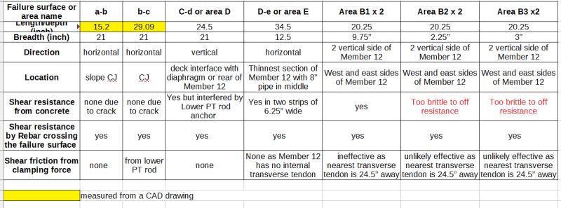

The above sketch is relevant if we want to assess why the two PT rods could have different strains when the same tension force was use in tension and de-tension.
Fig.5 A tabulation of the failure surfaces/areas
The use of this spreadsheet is for us to examine what rebar crossing each failed area or surface and sum the total shearing resistances to prove if the joint was strong enough against the collapse.
Saikee119. Appreciate the effort you have gone to in preparing these sketches.
However, there is a major flaw in your analysis. Your sketches show only a vertical view of the failure zone: there is no identification of the failure zone as seen from above. No proper analysis can be performed without this aspect being taken into account. This is because failure was caused by excessive stress. Without the shear zone from above being known, we cannot calculate stress which is a two dimensional unit (force per area).
I believe that if you take into account the failure zone as seen from above, your analysis of the failure zone you identify as seen from vertical aspect will substantially change.
Saikee, how come your failure surfaces are horizontal and vertical? Only limited portion of the actual surface was horizontal and vertical. Most were classic cone shaped cracks...
Maybe I’m missing something. Not sure. The previous green crack sketch seems a more accurate reflection of actual failure planes.

My spreadsheet describes the area of each failure surface. This is the detachment of the deck from 11/12.
The information is based on the cracked on condition prior to the collapse and the failure mode afterward.
Tomfh (Structural)

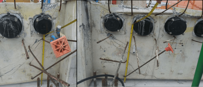

I notice some cone failure at the rear of diaphragm but that is likely tensile failure due to the principle stress at play.
The failure B1 did not occur as a perfect vertical shear but spreading 45 degree out in the field. The purpose of the sketch is to show what amount of concrete left to resist shear. How the principle stresses changes the failure pattern is just the result of the shear failure. It is the same when crushing a concrete cylinder it can often fail by shear at 45 degree and not by compressing the concrete to disintegration.
The failure surfaces are important for us to count the rebar participating the resistance. FIGG in his presentation had disregarded the contribution from the concrete and concentrated on the contribution from the rebar. FIGG's assumed total failed surfaces is much larger than mine.
In the RC design against shear we used the concrete surface parallel to the shear and count the cross sectional areas of the concrete and rebar across the shearing face. The actual shearing pattern can be different and may not resemble the design.

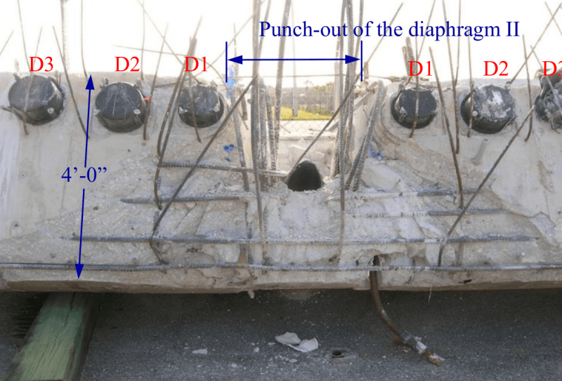

Oh, I see. You are treating it as a shear cross section akin to shear in a beam, and not really looking at the actual failure surface.
To my mind the cone failure is the critical feature. The cone snuck around all the critical PT reo, so I dont' believe shear theory can be applied. It's more akin to an unreinforced punching/cone failure.

Consider there is no effective resistance to shear at saikee119's plane B. The fracture merely jumps over to the longitudinal deck PT cable interface against the back of the 4" sleeves (OSHA pg 97, Figs, 64/65). The result is that there are no shear planes of any capacity in play, the model becomes one of a giant torque load between the base of 12 and the diaphragm/deck duo, and 11 becomes a giant point load on 12 just above the torque application.
This model anticiptes movement from the outset and builds load on 11 through to failure. Any rebar in the system merely acts as a slow release dampening device like a poorly adjusted door closer with big kick in the ass on the clasp setting. There is no door stop. The only good news is that in this instance you have at least five days to figure it out.
