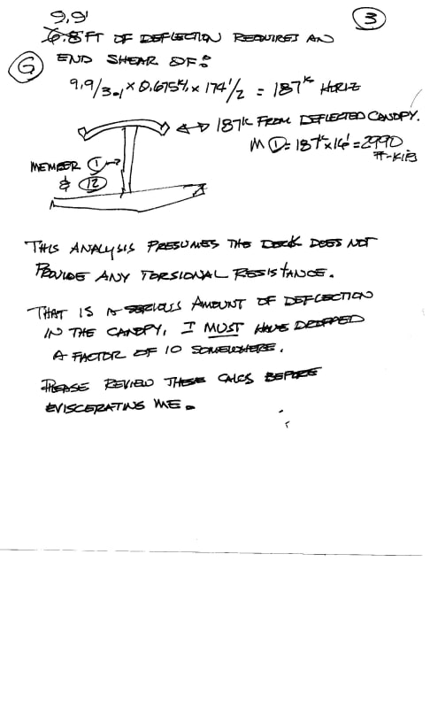

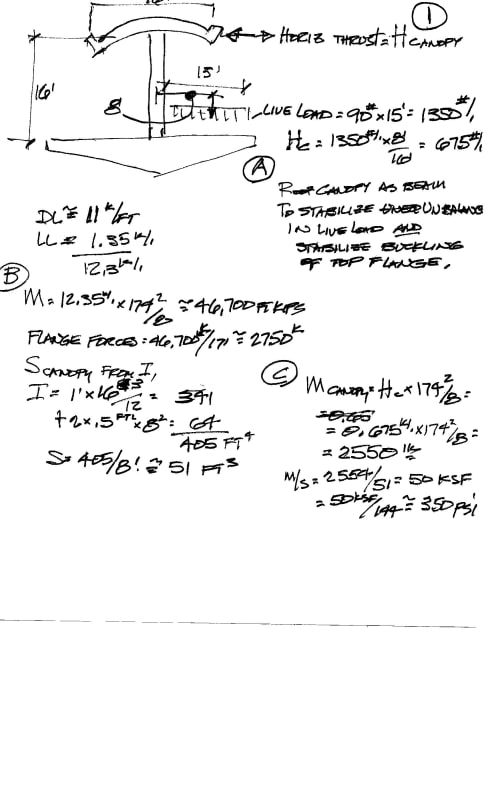

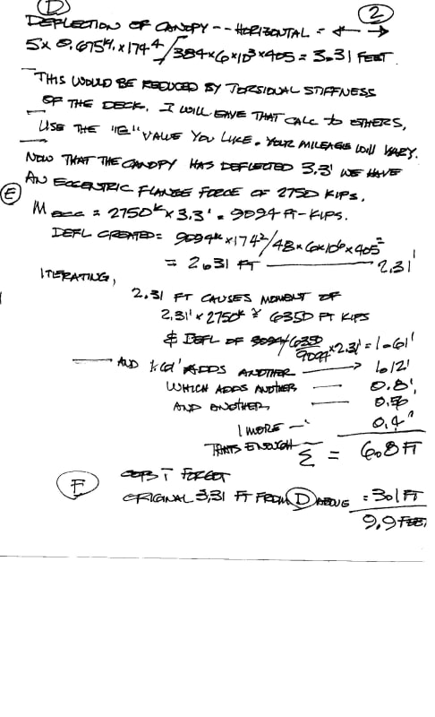

So lets try this - URGENT !! PEER REVIEW REQUESTED. Please.
I did some calcs - unfortunately I have no skills at graphics and minimal if not negative skills at typing. So the calcs are in felt tip pen. 3 sheets, with cap letters in a circle to aid in referring to something.
And I fear I have made an error so this calc is NOT FOR CONSTRUCTION. But perhaps it will stir some curiosity in someone.
I hope the calcs are kinda self explanatory.
Now I must grit my teeth and await the criticism.
OK - hit me with what you got. I'll get over it - maybe.
I am thinking I used wrong value for "E". What is proper "E" in units of feet?
KSI/inch = KSF/foot or Kx12x12/1 footx12 = 72000 ksf? So I am off by factor of 12 ? That feels better.

EDIT
Did a bit of unit conversion - found a reference that addressed E in different units.
Found E = 864000 Ksf which means I only overestimated the deflection of the canopy as a diaphragm by a factor of 144.
Dividing the 9.91 feet by 144 gets a deflection of 0.069 feet or 0.82 inches.
That is stiff enough to do the job.
Clearly the 9.9 feet would be a rotation in the 30 degree range and would be self un-loading.
The canopy as a beam is 174/16=span depth of 11. That looks stiff enough.
Sorry for the big number.

Vance Wiley said:
I have long been concerned about the stability of this structure under unbalanced linve loads and as a structure with flange stability requirements.
I'll try to go over it but I have to work tomorrow. Check the out-of-plan bending in the diagonals as well which is required to distribute the warping torsion. It looks like in C that you assumed the canopy has lateral resistance at both ends.
This is a similar problem to cable stay bridges with only a central line of cable stays. In these cases, you only have St. Venant torsion in the deck (and may be some local warping torsion near the ends of the deck). I can't see second order effects on the cable stays helping too much. This is why I think getting the torsion out is one of the hardest parts of the design. You also have to think that there are significant aero-elastic concerns in the torsional mode.
Thank you - and yes, the only thing I see that provides a lateral support to the canopy is member 1 and 12. 12 is / will be/ would have been OK when the pylon is cast around it.
EDIT In thinking about it, member 2 and 11 will help reisst the out of plane reactions from the canopy, because they are also "fixed" at the deck and backed up with the diaphragms. End Edit.
And as I added in a subsequent post, I think my deflections are off by a factor of 12 - plus whatever I missed in choosing E=6,000,000 (inch units).
Lateral bending in webs is maybe a combo of bending and torsion because of the sloping diagonals ? Ignoring torsion and Using two 24x21 sections only and about 33 feet of trib to a node I see:
90#LLx15'x8'x33'=356 '-kips. M/S = 356'k/(2x24x21x21/6)= 1210 psi. This is to be combined with prestress remaining and/or tension in one diag and compression in the other diagonal.
