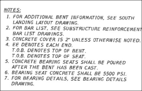

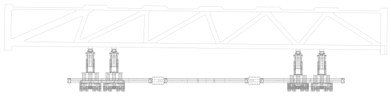

From Notes on Drawing B-73, we see what i have said many times -"CAD drafting lets you make mistakes at the speed of light".
Check Note 4 - obviously a copy/paste move.
I am not so sure that that point alone added to the potential for collapse, however.

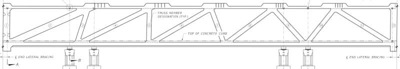

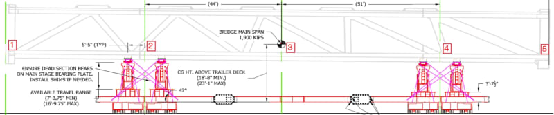

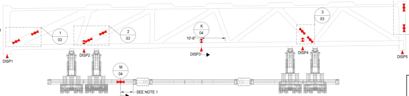

I went back to have a second look at the Barnhart Movement Plan and ended up a bit disoriented. See the pictures below (page numbers are pages within the 11-page PDF). They have been cropped and scaled so they are about the same size. Am I being too picky about all the inconsistancies and mis-labeling? If I were grading this there would be a lot of red ink....
Page 11 (below)
[ul]
[li]Pier end is to the right in this drawing, which is reversed compared to other 4 drawings.[/li]
[li]SPMTs are in correct place with respect to bridge orientation, but look wrong compared to drawing on Pages 5, 9 and 10 because bridge is reversed.[/li]
[li]Critical points are labeled 1 to 5, going from Pylon to Pier. In page 5 drawing the numbering is reversed.[/li]
[li]Pylon end is slightly higher than Pier (correct slope)[/li]
[/ul]
Page 3 (below)
[ul]
[li]No end or column labels (cover page, not a big deal)[/li]
[li]Compared with Page 11, the SPMTs are located in the same place with respect to the side margins of the drawing, but in this drawing the bridge is reversed left to right which puts the SPMTs in the wrong location relative to the bridge columns. Compare with next 3 drawings which have same bridge orientation as this drawing, but the SPMTs properly located.[/li]
[li]Pier end is high (wrong slope)[/li]
[/ul]
Page 5 (below)
[ul]
[li]Not shown in this cropped image, but N-S are marked.[/li]
[li]Critical points are labeled DISP1 to DISP5, going from Pier to Pylon (opposite of Page 11 labeling)[/li]
[li]Pylon end is high (correct slope)[/li]
[/ul]
Page 9 (below)
[ul]
[li]Deck is level[/li]
[/ul]
Page 10 (below)
[ul]
[/ul]
Re Moving bridge, which way is north
Mike - just checked something - am I wrong?
the 1% slope is 1.74 feet for the main span.
The max allowed angle change during moving was 0.5 degrees ???
My old HP11C says the tangent of 0.5 degrees is 0.0087 or less than 1%. So they had to exceed the spec limit for moving it just to lift it on the supports?
Probably not the worst thing that happened to it.

The 0.5 degree limit refers to relative twist (torsion) perpendicular to deck at the lift points. Calculations on this limit in part depend on the distance between the lift points longitudinal to span. Tilt instruments were glued to the span above the the lifters.

I went back through the SW view videos at the construction area (Move part 1) and prior to final setting (Move part 3) and it is hard to tell if or when they adjust tilt. Prior to seating the bridge there are many adjustments for side-to-side and end-to-end tilt, but it is unclear if this is anything more than just raising the overall height in discrete steps.
I then went back to the original version of "Move Part 3" - after it was cropped but before it was slowed down [uploaded to Whirled Gnus as Move part 3 - SW view (fast)] - and the SPTM sequence (after the bridge is squared up N-S) appears to be:
[ol 1]
[li]lower north end slightly[/li]
[li]raise south end a lot[/li]
[li]raise entire span and move into final position[/li]
[li]lower south end (slightly) to final seated position[/li]
[li]lower north end (slightly) to final seated position[/li]
[li]drop the towers and scurry back to the parking area[/li]
[/ol]
This is confusing as hell because 1. and 2. imply that either:
[ol A]
[li]The pier end was installed higher that the north pylon end, contrary to the PGL elevations in the construction plans: Pier 30.693 and Pylon 32.44 (or my misunderstanding of what these numbers represent).[/li]
[li]The bridge was constructed with the Pylon end significantly higher than the pier end.[/li]
[li]The span was heavily tipped during the move as the pylon end was driven over the highway median strip.[/li]
[li]I'm not seeing something.[/li]
[/ol]
My impressions:
[ol A]
[li]Impossible ?[/li]
[li]No logical reason to do this ?[/li]
[li]A possibility because the initial setpoints/calibration levels were lost during the mysterious computer shutdown during the move.[/li]
[li]A possibility because the videos are not super high-resolution, the SW viewpoint is elevated and off to the side, and 1% tilt is not much.[/li]
[/ol]
FIU was also bragging about this being the largest pedestrian bridge moved by SPTM in U.S. History. That's quite a feat by itself, but then they had to increase the degree of difficulty by making a sharp 90 degree turn while also running off a curb and over a median.

SFCharlie - Whatever the reason, there was a whole lotta jackin' going on right before the SPMTs moved east the last few feet. I'm guessing significantly more than the 0.5 degree allowance.
If the monitoring equipment and SPMT move-meister were doing their jobs, shouldn't the bridge have been nearly level during the entire move? The purpose of the rotation sensors was to provide real-time feedback during the move, as well as provide a permanent record.
The Move 2 - ground level video (at 1:24) shows a guy wearing what appears to be an RC-type controller at waist level. Could he be the move-meister?

Yes, I went back and watched the videos again and something definitely goes wrong with the north SPMTs as they go over the median. They are supposed to stay level as a unit of two. The whole arrangement starts to tilt. they back up, adjust tilt and go forward again. The Remote operator comes over to the north end to watch. Maybe this is the wifi failure that was mentioned.
