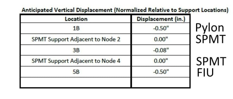

ADD: The "move" was supposed to happen on a surface that was pre-leveled with an abundance of plywood to eliminate the rough transitions that occured as the SPMTs rolled off a curb at the construction site and then jumped over the center median. See the animation video starting at about 0:52.
Vance Wiley (Structural) - Thanks for replying to this. I should have posted the vertical displacement determined by Barnhart.

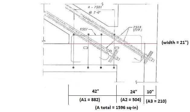

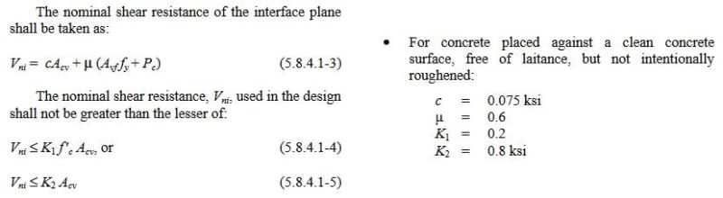

First, how OSHA came to it's conclusion of the 22% deficiency. The equation used, LRFD 5.8.4.1-3, p.422, is the same as was used in FIGG's calcs, except OSHA has included a concrete area component for non-roughened surface, with mu = 0.6 and c = 0.075 ksi, LRFD 5.8.4.3, p.426.
Ac = 76 x 21 = 1596 sq-in
Avf = 9-#7 (0.6) + 3-#11 (1.56) = 10.08 sq-in
Vni = c*Acv + mu*(Avf*Fy + Pc) = 0.075*(1596) + 0.6*(10.08*60 + 705) = 906 k
Vu = 1106 k
% deficient = 100*(1106 - 906) / 906 = 22%
>> Shear-Friction Plane (Acv).

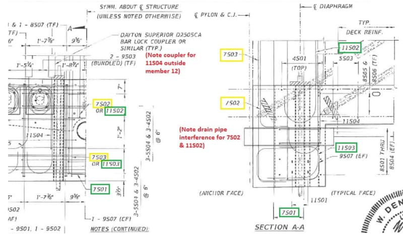

Now, the questions with OSHA's approach, and thoughts on a revised assessment of the capacity of the FIGG designed joint. First, separate the shear-friction plane as such:
where A1 corresponds to the diagonal-slab interface, A2 corresponds to the diaphragm-member 12 interface, and A3 corresponds to a section through member 12 that lies outside of diaphragm.

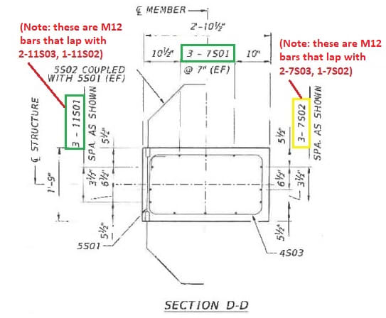

>> Shear Steel (Avf). Next, identify the shear steel within each of these concrete areas, and its availability to assist in shear-friction. Green highlights show bars that certainly would be included, yellow are questionable (Asq):
Area 1: bars 7S01 lack adequate development length; bars 7S03 are inclined in wrong direction (ACI 11.6.4.2, p.191). No steel.
Area 2: 2-11S03, 1-11S02, 4-7S01. Neglect the 2-7S01 bars 10'' from back face, as these lie outside the main diaphragm steel (see notes for Area 3). As = 7.08 sq-in; Asq = 1.2 sq-in.
Area 3: Neglect the 2-7S03 & 1-7S02, as these lie outside the diaphragm steel; Asq = 1.8 sq-in.
Engineering judgement tells me to neglect these "questionable" bars. I would not want to rely on this concrete stub, which extends beyond the confinement steel of the diaphragm, to develop much shear-friction capacity at deck level. But as some will question this decision, below I'll run numbers both with and without Asq.

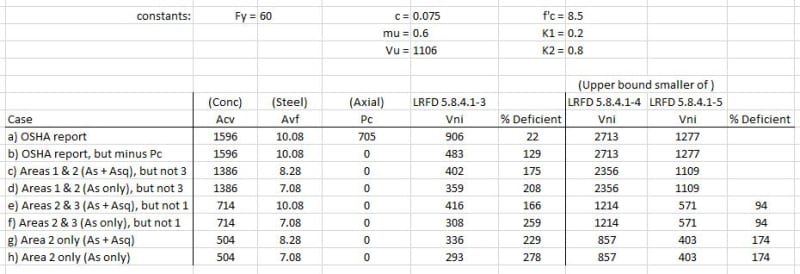

>> Capacity (Vni). Now, determine capacity:
As has been referenced earlier in thread, the online version of AASHTO LRFD 2012 is used Link.
In addition, ACI 318 is used for additional reference. Latest version online is ACI 318-11 Link. Note that 318 was completely reorganized into 318-14. I could not find an online version. Correct me if I'm wrong, but I don't believe the Shear-Friction section was altered appreciably from 318-11.
Loads are taken from OSHA report, p.106-8 Link, with H = 1106 k, V = 705 k. It is not directly stated, but I'm assuming this is for "Case 3: PT tendons in main span truss, except member 2 & 11." As was done in OSHA, no load factors or phi factors have been applied. Including these will only make deficiencies noted below worse.
The "shear" steel (Avf) crossing the shear plane is there to develop in tension, thereby maintaining concrete contact across the crack joint, LRFD C5.8.4.1, p.421, and ACI R11.6.3, p.190. It's also stated that any additional permanent clamping force can be utilized to offset the strains that will develop in this steel, LRFD 5.8.4.1, p.423, and ACI R11.6.7, p.192. My interpretation of this allowance is that only the steel w/i the concrete area that sees this permanent clamping force should be able to take advantage of this reduction. In my opinion, only Area 1 will see this force. OSHA has applied this clamping force to steel in Areas 1-3. I believe this is an oversight on their part.
It's already been shown elsewhere that the steel in Area 1 is not long enough to develop properly in tension. This begs the question--If we have "no" shear steel in Area 1, should we then be allowed to develop Acv, the concrete area in shear? OSHA has included it. We do have a clamping force in Area1, so certainly concrete shear resistance is going to develop, but the codes don't address this unusual condition. Below, I've run numbers for both assumptions.
For the stub area of member 12:
For the same reason stated above for Area 3 steel, I would neglect this concrete area (Acv) as well when determining a shear-friction capacity. But, again, I'll run numbers both with and without this area.
To restate the LRFD eqns again:
Capacity spreadsheet:
The bottom line then, in my opinion, is that only cases (d) and (h) are viable. For (d), however, it's hard to get away from the permanent clamping force acting on the concrete, but w/o adequate reinforcement I think you have to. So, rather than being 22% deficient in shear-friction, as OSHA has stated, I would instead say "the demand is 278% above the available strength." That's quite a difference.
One final point. Whether or not to take into account member 12 loads. OSHA did not. I believe they should have at least mentioned their reasoning for excluding. All I can find in the codes on this subject is "When moment acts on a shear plane, the flexural tension stresses and flexural compression stresses are in equilibrium. There is no change in the resultant compression Avf*Fy acting across the shear plane and the shear-transfer strength is not changed. It is therefore not necessary to provide additional reinforcement to resist the flexural tension stresses, unless the required flexural tension reinforcement exceeds the amount of shear-transfer reinforcement provided in the flexural tension zone." (ACI R11.6.7, p.192) Seems logical enough--what moments give they also take away. But, as all concrete cross sections are not equal, our concrete stub for instance, future codes may want to be more precise in their wording for moments acting on shear-friction planes.

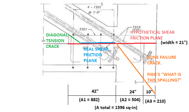

Fortyyearsexperience said:

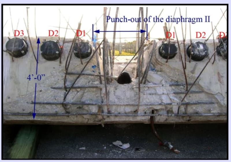

However, I have repeatedly stated that ZERO square inches of tensile rods were provided for tying diagonal #11 to the deck. The photograph below demonstrates this fact with brilliant clarity. One can see there is NOT ONE SQUARE INCH OF STEEL provided to tie #11 to the deck. The designers totally misconceptualized an elementary aspect of the design.

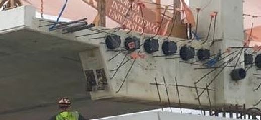

Yes it does look like an unreinforced punching shear failure. The strut has simply burst out the back of the deck.
In my opinion these shear friction numbers are a bit of a nonsense, because they only give you the capacity of a very specific assumed failure mode, which in this case doesn’t appear to be the actual failure mode.

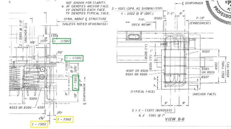

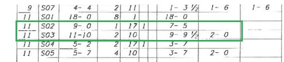

Based on Design Documents I have been able to find, not final, and the presumed reinforcement in the members from the Design Drawings, it appears reinforcement shop drawings have not been made available yet (if anyone has I link, perhaps I missed the link in a previous post, that would be very helpful).
Member 11 appears to have 8-#7 bars (7S11), one each corner plus one each face. Eight non-contact #7 (7S03) lap splice dowels, two each face, into the deck and diaphragm terminated by 180 degree hooks. The single ties in Member 11 are spaced at 12" on center and stop at the top of concrete between Members 11 and 12 and do not appear to extend from the top of Member 11/12 concrete to the deck, Member 12 or end diaphragm thru the joint at this location. This would result in relatively long lengths of compression bars not supported by ties. There does not appear to be ties around the middle compression bars in Member 11, and no compression ties at all thru the joint.
Photos indicate that the interface between Member 11 and the deck had began to slide horizontally. This would greatly increase the compression stress in the #7 dowel bars that appear to be unsupported by ties. Prior to horizontal movement the stress in the dowels would have been relatively low and limited by strain compatibility with the concrete. Buckling of the dowel bars may be the cause of the spalling that is seen in the photos of Member 11 on the vertical faces. Ties would have been especially critical between the deck and top of the concrete between Members 11 and 12, the deck would have provided some resistance to buckling. Typically column details often include decreased tie spacing near the intersection of members, also not present in documents seen so far.
Compression reinforcement, properly developed, supported, and spliced would directly resist the axial force of Member #11. Compression reinforcement can not be added to tension reinforcement for shear friction, but are deflection compatible across small cracks, a movement parallel to the assumed crack can produce compression in one bar and tension in another. The net clamping force for shear friction can then be determined by a free body diagram for the assumed plane.
Cracking in the deck would reduce the ability of the dowels to develop at the hook, spalling in Member 11 would reduce the ability of the dowel bars and Member 11 main axial reinforcement to transfer and develop the splice properly.

FortyYearsExperience, I see in your photo the D1 spirals near node held very well. Members 11/12 did not have anything similar to hold them? What caused 11 to crack? Bending moment? Crushing inside member? Different amounts of slippage across deck? (EDIT: crossed post, hpl575 just explained) Is it feasible EOR in his forty years of experience saw so much benign cracking that he was caught off guard in this case? Also, did not EOR state shoring up deck would just lead to a "false sense of security". I need help re-finding that quote if it does exist.

This is how I'm picturing the failure cracks and shear plane. Look correct?

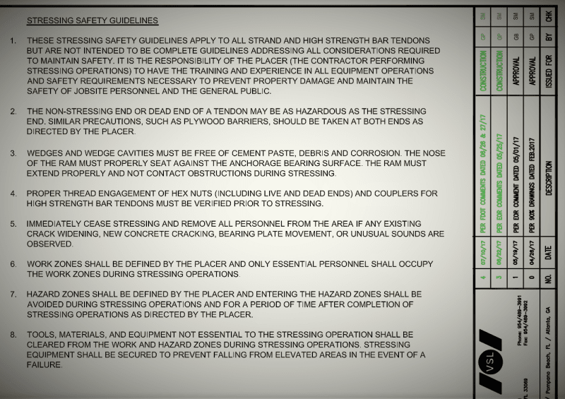

Here is page 5 from 2017_08_11 - Updated Post Tensioning Drawings (SD _00462-1.G).pdf
We are all baffled by EOR's discounting of cracks, but not much mention has been made to discounting of rules. The above guidelines 1 and 5 were clearly not followed. This happens because of the management environment. Everyone has asked why was road not closed. It is precisely because guidelines 1 and 5 were clearly not followed. They are right there on the plans in plain site. Note the mention of unusual sounds on the plans. I find very little mention of the reported cracked-whip sounds in this thread. I know first hand these types sounds are extremely alarming. The cracks were addressed as not a safety concern by EOR. The sounds are totally off the radar.
