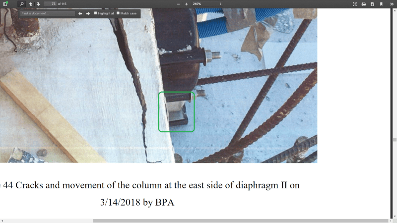

I questioned before if emergency shim was ever placed. Turns out it was, on 3/14/18.
OSHA Report, page 74
MCM and TSG placed the recommended shim (steel instead of plastic) under the diaphragm II.​

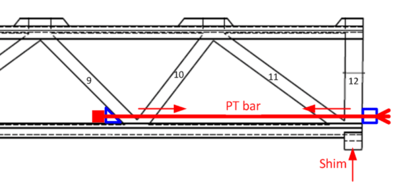

The above diagram was posted by gwiderman on 12 Jun 19 23:01. It is NOT the official version from FIGG to fix the failed joint but an excellent representation of what FIGG had proposed according to Page 76 of the OSHA report.

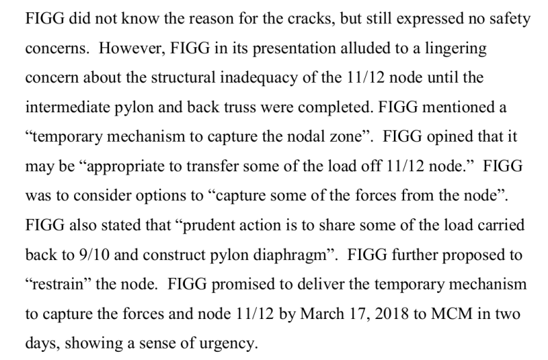

In the OSHA report despite FIGG considered the cracked 11/12 joint not a safety concern it nevertheless had conceded that the structural adequacy of the cracked joint was an issue during the construction stage when it had no end restraint. Such restraint would of course be provided by the erection of the side span had the bridge been able to achieve completion.
The need to strengthen the bridge by passing some of the loads back to 9/10 is a clear admission by FIGG that its design was faulty. According to OSHA report there is apparently a reference in the Minutes of the last meeting in March 15 2018 that FIGG had promised a temporary strengthening scheme to be delivered to MCM by March 17 2018. A strengthening scheme is significant evidence that the exiting design was inadequate as new materials must be introduced to alter the load distribution of the bridge to halt the growing cracks.
The proposal to introduce additional restraints to strengthen the bridge and the manner of the bridge failed on March 15 tell me that FIGG knew and had identified the risk but failed to act in time to prevent the collapse.
Therefore it is now cast in stone that FIGG was of the opinion that the condition of the bridge with cracked 11/12, as documented in OSHA and NTSB reports, was not unsafe and remedial work could still be instructed and carried out on it while live traffic passing underneath. FIGG had on recorded, in the March 15 2018 meeting, has accepted that the bridge did require to be strengthened above its existing design and such strengthening scheme was due to be delivered to MCM on March 17 2018. It is also significant in the meeting that FIGG proposed to restrain the node as 11/12 was seemingly moving away from its designed position.
The photographic evidence in OSHA report would suggest 11/12 moved outward away from its support, the deck snapped and dropped onto the ground relatively intact as a single entity. Additional breaking and spalling of concrete could have taken place as the consequential effects from the separation of 11/12 from the deck. Much the 11/12 was still resting on top of the pier after the bridge failed. It would be obvious had the 11/12 been restrained in time and prevented from moving away from its designed position the bridge if were to collapse must have a totally different failure mode. Its 11/12 and the deck could be resting "together" on the pier in the same manner as 1/2 at the bridge opposite end did after the March 15 collapse.
The fact the bridge collapsed before FIGG’s strengthening scheme could be devised is a good testimony on the technical competency of FIGG on the matter. Its insistence without reservation at all time that the bridge, with growing cracks, were safe had not only been unhelpful but fatal to the workmen working on it and the motorists public using the highway beneath the bridge.

Could someone identify the elements/parts in the closure strip over the Pylon which will provide 2000 kips of tension tie between the north and main spans?
That's kind of the $64,000 question. I have not seen any sign of a substantial connection between the span and back span in the drawings so far available. But I wonder if Figg might have been hatching a plan to tie onto the ends of some or all of the longitudinal PT rods and connect them to their counterparts in the back span. They could have used the same coupler nuts that the Hyatt Skywalk fabricators passed up.

The post accident photos show steel plates leaning against the pier. What possible use would such large plates be for? Was the emergency shim cut from it? Could it be they were fabricating something? Any ideas?
I see in OSHA photos, at least one uhmw shim ended up on walkway. This means when diaphragm slid off landing, the shims remained. Then vacuum of falling deck pulled them down.
