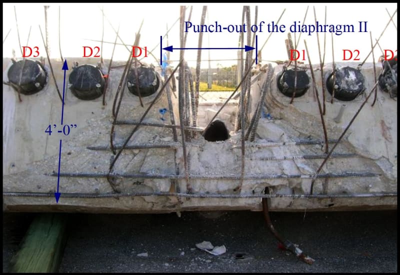

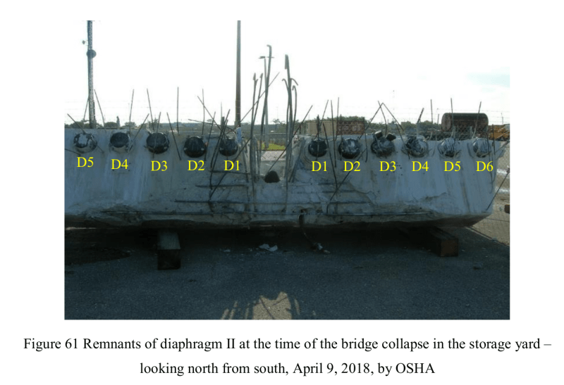

Two photos, Fig 61 and Fig65, in the OSHA report caught my attention.
The Fig61 shows all the vertical rebar were intact after the collapse. In that the steel did not shear off like the concrete did but just debonded and separated from the spalled concrete. They were hardly bend or yielded. Most have the original 90-degree bends remain surprisingly in good shape after they came off off the concrete Member 12.
My concern is the vertical rebar of Member 12, seen from the OSHA report photo Fig61 and Fig64, did not participate much in resisting the Member 12 (together with diagonal Member 11) from being pushing outward during the collapse and none of them failed by shear. This would suggest the bulk of the resistance to prevent failure was the shear strength of the concrete alone. If any the rebar was designed to resist shear in Member 12 then the design simply did not replicate what has happened in the field.

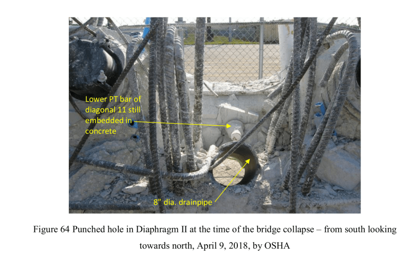

This is most likely due to the poor structural arrangement at this location where a 8” (ID) diameter pipe sleeeve was cast horizontally for the drainage allowance. With Member 12 only 1’9” wide the 8” internal diameter sleeve would have left only about 6” concrete necking on either side of the pipe sleeve. After taking the rebar size into consideration each necking has less than 3” concrete on either side of the rebar. When Member 12&11 were pushed out of position the concrete near the pipe sleeve simply blew out and disintergrated leaving the rebar behind.
No doubt many would argue the concrete area is wider than the Member 12 as it was cast partially into the deck. However the deck has been compressed axially to deflect inward but the Member 12&11 were pushed outward so there are clear and well established shear planes between them. To make the case worse there was a construction joint, acting as a plane of weakness, between the deck and the Member 12&11. OSHA report has provided photos on the cracks and spalling at this interface prior to the collapse.
Since the majority of the rebar at the failure location remains in their original positions and suffered no shear failure the evidence would highlight a serious deficiency that the concrete member sizes there were inadequate as they were unable to produce a common strain between steel and concrete. In other word the concrete had insufficent mass to transfer its stresses into the steel reinforcement. In properly designed reinforced concrete there should be no slip in strain between reinforcing steel and concrete.
It is quite possible had the 8” ID sleeve been omitted or relocated elsewhere the FIU bridge might still exit today or the fialure pattern would have to be substantially different.
Good post. If one were demo'ing that concrete with a jackhammer, it would look much the same. Add the part of 12 that remained on the pier and it is an interesting failure.

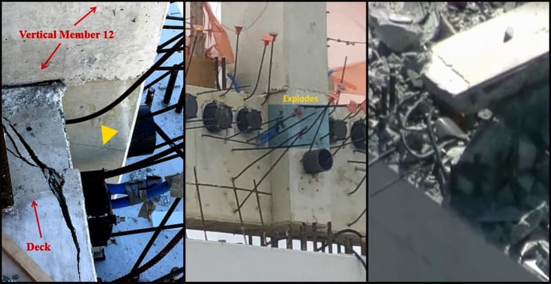

One variation to what I had posted earlier was that perhaps the shear plane exited the end of the deck at the top of the 8" pipe sleeve, leaving the portion of 12 below the sleeve still attached. Then as the deck was pulled over the edge of the pier, there was 10-1/2 inches where the deck/bridge weight was being supported only by that projection, and that part separated in an upward motion relative to the top of the deck. There is spalling of the edge of the pier at the center portion only, supporting this thought.
from jrs_87 (Mechanical)12 Jun 19 07:23.
Vance Wiley said:
"separated in an upward motion relative"
The appearance of shattered 8" pipe pieces in the rubble at the top of the deck would support your thought as well.

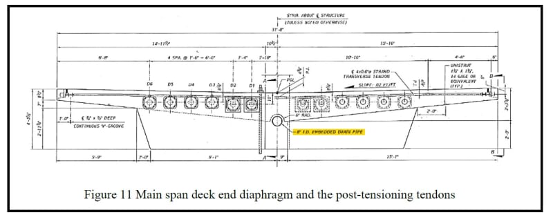

Someone please clarify. Is not that "sleeve" the actual embedded drain pipe section for passing through diaphragm II? If so, is not "sleeve" a misnomer? The allowance of pipe at both sides of diaphragm support assertion it is actual drain. Hopefully it is not sleeve for 8" pipe to pass, because then that sleeve diameter would be greater than 8 inches. FIGG's intention was to hang drain system with no slope from the belly of the deck? There are several center line vertical passages in deck for drain system.
If the pipe is actual drain, it would be difficult to repair in the future without restricting it's diameter.
Perhaps a FEA can be made for just 11/12/deck "zoomed in" to model actual construction. NTSB has stated they laser 3D scanned the remains in 2saikee119's photo.
jrs_87 said:
Re: 8" pipe
I assumed it was a sleeve - for a smaller dia pipe thru. It would be a poor solution to cast the permanent pipe in concrete - minor structural movements would crack it someday. As to size - the roundie channel in the bottom apex was 12" dia (or 6" radius since it is hot full circle).
Perhaps that extra dim was to provide fall. Unfortunately, there was not enough time to determine the camber of the structure but I have not seen any camber instructions so I suspect it was to be flat. Kinda risky over 184 feet. Bit with the curbs and slope to center of the deck it would have only held maybe 8" of water.
Bridge was not flat. Elevations and stations are all over plans. Dwg B-04 shows slope of 0.01 ft/ft.
FDOT's Tom Andres had comments on the drain pipe. He noted in the submittal drawings that the drain was flat, relying on hydraulic action to drain and suggested the addition of some slope would make the drain self cleaning. He was also concerned that the 2" gap (to be later grouted) between the two halves of the deck level tower/pylon would make it difficult to fit up the plumbing. I believe 1-1/2" is the amount of drop from the North pylon to the South Landing. If the had drained the main span & the back span separately, they could have eliminated the penetration all together.

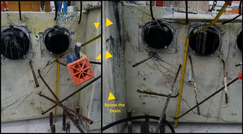

The rupture stayed for the most part within the area of the original cracking.
It looks like the rebar that was in #12 also came away fully intact and that only the concrete below the drain was left to shear off when the deck finally fell.
My thinking about the rebar in 12, at least that which remained part of the diaphragm, is that it was on the east/west sides of the column. There was insignificant rebar on the north/south face to resist 11 pushing through so that rebar is effectively demolished.
