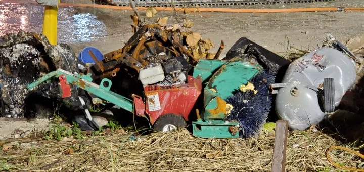

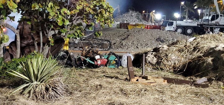

Demented, did he say these were found on the ramp area?
Some of that gear could fit within that 'debris' beyond the entry gate. It would be even better if they'd just come out n say it...
Edit: That kettle wasn't on the roof, or wasn't supposed to be. It could have been sitting on the North side on top of one of those "parking garage" roofs... kettles can way 2000 lbs or more. I wonder if that's why the FFs couldn't get thru that garage area?

Can tar kettles catch on fire if unattended?
Demented said:
Where them roof first guys at? Our potato cam crane operator friend gave ya'll a present.
I'm sure you realize that these pictures prove nothing without context, right? Were they on the roof that was part of the original collapse or from the July 4th demolition? Where and when were they recovered? Is Jimmy Hoffa's body in the tar buggy?
The existence of these items and their condition don't prove any one theory over another.
The above post is why I posted it. I knew someone would have where it came from. Sarcasm doesn't translate very well over the internet, and in my own sick mind I was poking fun at the blurry image CSI roof first people who I am sure had every bit of items on the roof mapped out.
Optical98 said:
Zoom in, see for yourself.
When I zoom in I run out of pixels just before I can read the serial numbers on that equipment.

Ok, so adding an image directly turns it into a potato...
Let's try story time again Nukeman
Link
Also, please note my remarks regarding the tar kettle, the large one that looks burned up, not the small ones on thee roof..

Green So, is the green saw the green object in the "water streaming in the garage" video???
Not a chance, it would have been Much more damaged after falling 13 floors and crashing through the
pool deck.
Two different people see the same picture and come to totally different conclusions as to what they see. That "saw" is actually a power sweeper.
People post pictures here and ask us what we see, but they won't come right out and say what they see.
Nukeman948 (Electrical)19 Jul 21 02:06 said:
power sweeper would have been Much more damaged after falling 13 floors and crashing through the
pool deck.

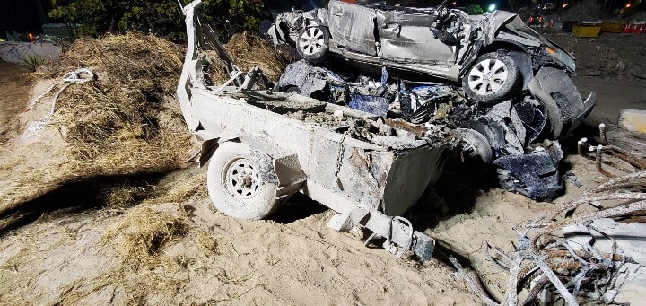

Yes, I had been thinking the same of the tar kettle, but how did they remain uncrushed as the black car is flattened? Did the material they were on cushion the blow, or were they on the pool deck already?
